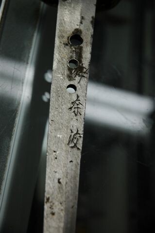

sencho Posted November 19, 2006 Report Posted November 19, 2006 Hi BD Grange, I found this one not so long ago. Kai Gunto too and the mei INABA. Any thoughts? My wife did find a documented "smith" on a Japanese website by this name who made swords for the Navy. This also has the anchor stamp. Cheers Nigel
bdgrange Posted November 19, 2006 Report Posted November 19, 2006 Nigel Yours having three mekugiana is unusual for a gunto. It looks like stainless and an anchor stamp would be for the Toyokawa naval arsenal, circle and anchor I believe. Given only the nakago and sig. I am not sure what may or not be going on with this. The smith is unknown to me as well. The yakiba on these swords may or may not be real with actual nioi present. This has not been established by anyone. I am still learning about these as well and there is not much in the way of source material. best bdgrange
sencho Posted November 19, 2006 Report Posted November 19, 2006 Hi BD, Yes it does have the circled anchor stamp. When my wife gets back from Japan I will get her to look up the site where there was details of the smith and I will send to you. Cheers
Nobody Posted November 19, 2006 Report Posted November 19, 2006 I found one name of Inaba. On the following list, No. 159 shows Inaba Kaneyoshi (伊奈波兼吉) as Kaigun jumei toko (海軍受命刀工). http://www.murataya-g.co.jp/sword.html
sencho Posted November 20, 2006 Report Posted November 20, 2006 Thanks Moriyama san, I will post the details we found on Inaba, including a sword festival they have at the Inaba shrine every year, but I'll have to wait until Yukako gets back from Yokohama later this week, as my grasp of written Nihon-go is pathetic. It was a Japanes website where she found it. This sword is lying in a junk shop in Florida right now. It looks machine made and it has been stuck into much older (shinto I think) koshirae. the Koshirae is actually qiute reasonable and is probably worth more than the blade! Cheers!
sencho Posted November 20, 2006 Report Posted November 20, 2006 Hi Moriyama san, Found, quite by accident the details of what my wife saw on the internet. She found a shrine called INABA JINJYA in Gifu City, Gifu Prefecture. They still have a sword festival every October for sale and exhibition of nihonto. She also found a local sword smith named INABA in that prefecture; INABA KANEYOSHI, who was a SHOWA period smith. He was a contract sword smith for Japanese Navy. His teacher was called MATSUBARA SHOZO. Cannot find any examples of his mei for comparison to the sword lying in the junk shop. Cheers
Nobody Posted November 22, 2006 Report Posted November 22, 2006 sencho said: She also found a local sword smith named INABA in that prefecture; INABA KANEYOSHI, who was a SHOWA period smith. He was a contract sword smith for Japanese Navy. His teacher was called MATSUBARA SHOZO. Hi sencho san, His teacher MATSUBARA SHOZO (松原正造) seems to be a WWII sword smith in Seki. His smith name was also Kaneyoshi (兼吉) according to the WWII Japanese Swordsmiths list on the following Dr. Rich S's site. http://home.earthlink.net/~ttstein/tosho.htm http://home.earthlink.net/~ttstein/seki.htm
