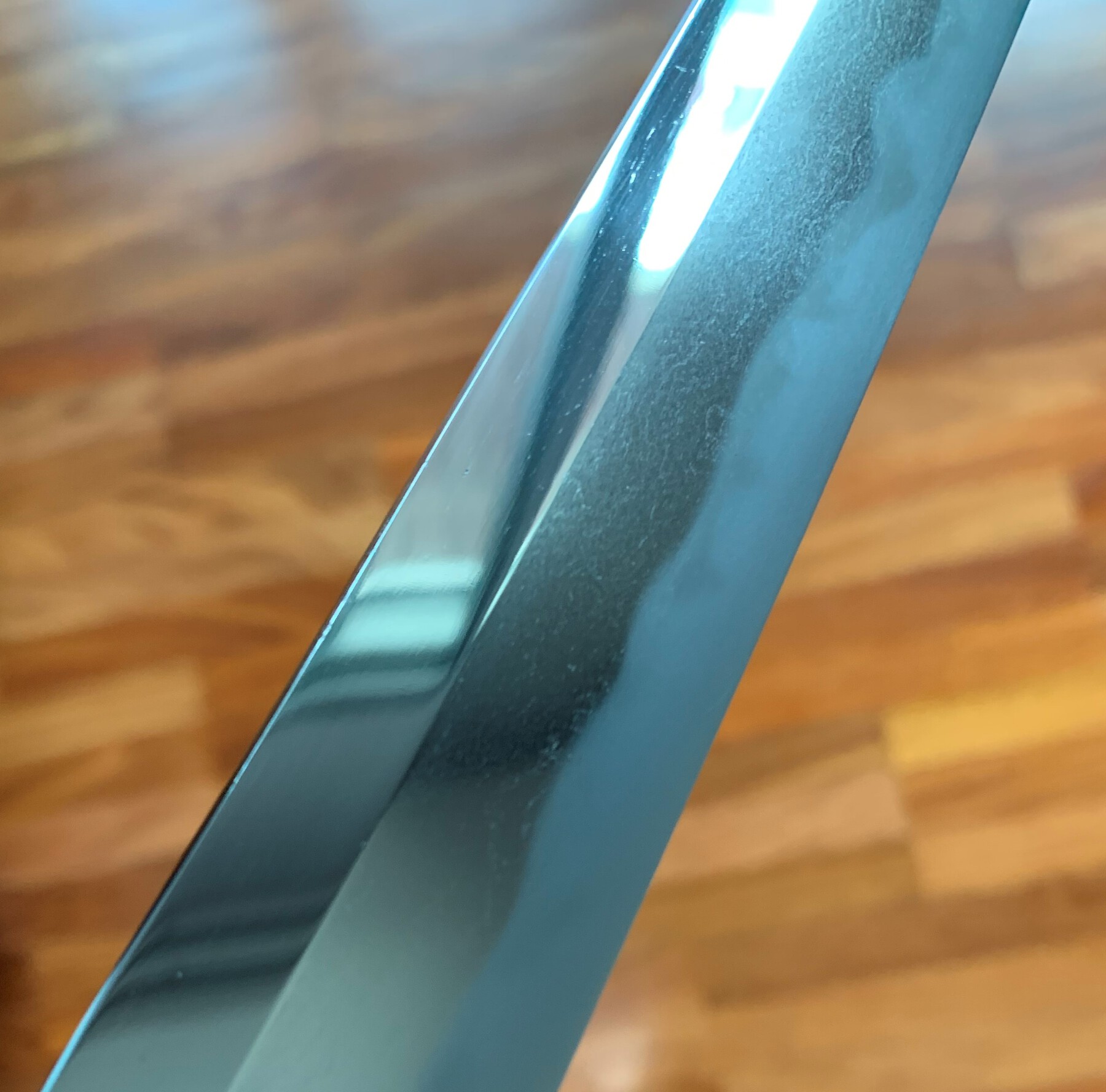

As promised the second addition, this one for the Bizen crowd.
This sword is o-suriage mumei with gonome choji-ba hamon, ko-nie, and utsuri. The better photos are again courtesy of @Ray Singer (that may be a trend with these) with some of my own thrown in... I know I need a darker background. Happy to provide any photos of specific areas if my skills allow.
    nagasa 69.9cm
    moto-haba 3.2cm
    kasane 6mm

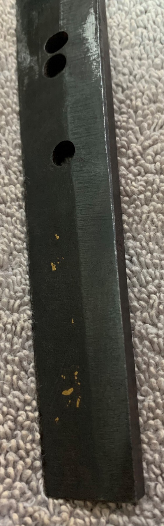

There is varying opinion on attribution: The NTHK attributed the blade to Hidekage, Eikyō era; there is a remnant of an old kinpunmei (see photo) that might be mitsu 光; and a previous owner was told it could be Nanbokucho Omiya. Attributions all in the same general style but vary from Nanbokucho to early Muromachi. In hand it has a lot of heft to it. I do plan to send to NBTHK shinsa once global shipping is more reliable and will update the thread then. The blade has a lot of heft and a lot of activity to see in hand that I am not good at describing quite yet. This was a forum purchase so some of you may have seen glimpses of it before.
(The black line in the boshi is a relfection, not a ware)
