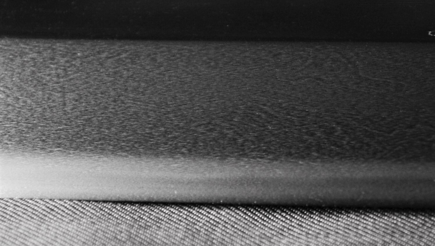

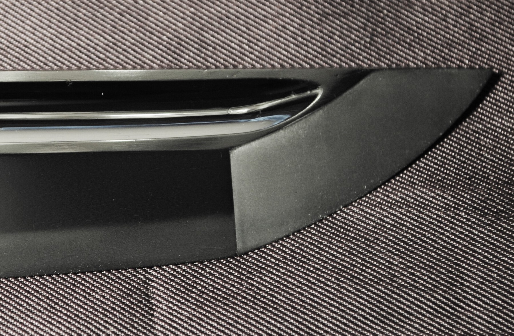

paulb Posted April 27, 2021 Report Posted April 27, 2021 The inabilty to hold physical meetings over the past twelve months has meant it hasn't been possible to look at and study swords not previously seen. I was trawling through some images and cme across this one. Just for fun take a look and see if, based on what little you can see you can suggest a date for it and possible tradition/school. details: Sugata 68.5cm sori 1.8cm motohaba 2.5cm sakihaba 1.8cm kasane 0.5cm It is O-suriage. 6 Quote

Rivkin Posted April 27, 2021 Report Posted April 27, 2021 Sorry, can't see the boshi's shape clearly, but my guess is ko maru. Still go for Enju, the end of Kamakura. Quote

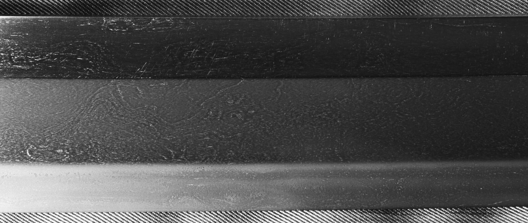

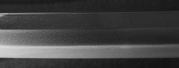

paulb Posted April 27, 2021 Author Report Posted April 27, 2021 Thank you for taking the time to respond. The answers show a level of consistency i.e. Yamashiro or Yamashiro influenced (Rai Enju, Aoe and Hizen) Date-wise late Kamakura or Nambokucho seem favoured but I am not sure why. Dimensionally this blade lacks the grand sugata that would automatically lead you to Nambokucho. I will leave it for a bit longer but below I have added some examples of Rai/Enju, Aoe and Hizen hada for comparison. Rai/Enju Ko-itame hada Aoe Chirimen hada Hizen Konuka hada 1 Quote

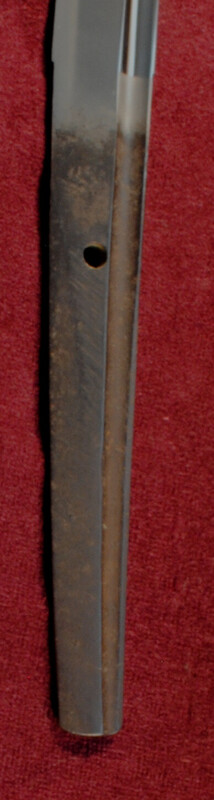

Katsujinken Posted April 27, 2021 Report Posted April 27, 2021 Jidai for me in this case comes from where the sori happens and the fact that it’s described as o-suriage. Not everything in Nanbokucho had a 3.5mm sakihaba after all. The nakago photo is out of focus, but it seems like some yasurime are just barely still visible. So I think late Kamakura is out. But I am probably just revealing the extreme limitations of my kantei abilities here! Quote

paulb Posted April 28, 2021 Author Report Posted April 28, 2021 Once again thank you all for your input. The blade is attributed to Awataguchi Norikuni who is recorded as working between 1219 nd 1222. He was believed to be the son of Kunitomo and the Father or grandfather of perhaps the greatest maker of Tanto Yoshimitsu. He is also listed as one of the resident smiths of the Emperor Go-Toba. I think this points out how difficult it can be to assess a blade from images. Most misleading of all was the nakago which as John pointed out looks red n the image. Two things one it is O-suriage so it is possible the tang could look less black then the age might suggest because the patination has had less time to develop on the newly formed nakago. In this case it has more to do with the lighting for the photograph. In hand the nakago is a deep rich black. The shape is rather slender and if you try and imagine the ubu sugata it would have had a relatively strong koshi-sori and the overall shape slender and refined. it also has an ikubi kissaki. Almost everyone picked up on the very tight ko-itame hada as all the suggestions were for schools that created this in varying degrees .However Awataguchi smiths took this to a whole new level. The hada comprises of a minute ko-itame, known as Nashiji and covered in very fine and bright ji-nie. When I first saw the Enju blade illustrated I said the hada was so fine it might be considered Awataguchi. Then I saw the Norikuni and realised how wrong I was. Nashiji is a whole level finer than anything else. On occasion works by smiths such as Kunimitsu and Kuniyasu can also include a nagare element and o-itame, but it is this very fine nashiji that makes Awataguchi work unique (at least in my opinion) well done all who answered , all picked up on some elements which led to the strong Yamashiro association. Interestingly no-one got the date of manufacture which I think shows one of the issues is trying to date an O-suriage work. 6 5 Quote
