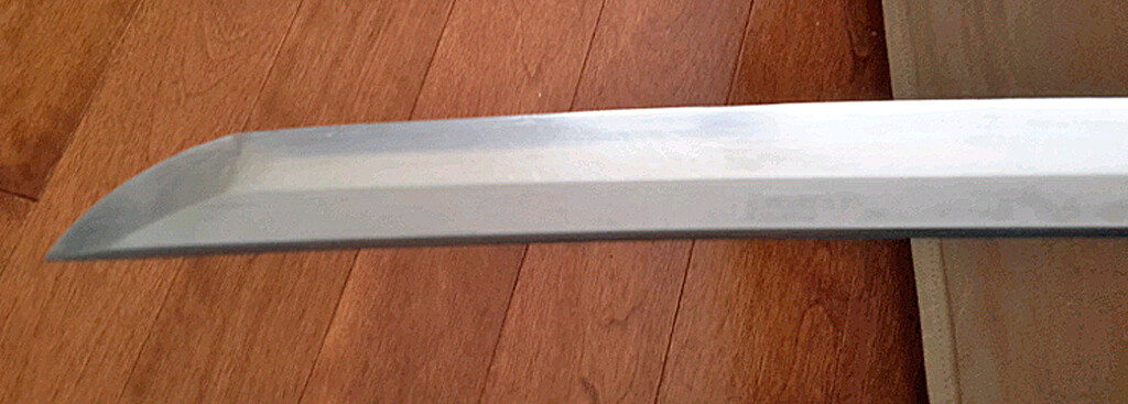

Kaiser21 Posted April 26, 2021 Report Posted April 26, 2021 I came across this Gunto on-line and it looks interesting. As I'm new to Japanese sword collecting I'm interested in whether this one is worth picking up? It looks to be a Kai-Gunto in the Type 98 mounts. No tang stamps beyond what appears to be the Toyokawa Arsenal stamp. I'm assuming the blade is stainless steel made from bar stock. Two questions: Is it original ? Is it worth pursuing at $640 U.S. ? Opinions welcomed as I'm trying to get a feel for what fair market values are. Quote
PNSSHOGUN Posted April 26, 2021 Report Posted April 26, 2021 Not quite sure where you're seeing the Type 98 connection, looks completely Kai Gunto. 1 Quote
Kaiser21 Posted April 26, 2021 Author Report Posted April 26, 2021 Probably just lack of knowledge on my part. I'm equating the presence of two suspension rings on the saya with the type/model. I should have said Type 94 which I think has two rings as opposed to the Type 98 with only one. When you say "looks completely Kai Gunto" do you mean it's a legitimate Kai Gunto? Quote
PNSSHOGUN Posted April 26, 2021 Report Posted April 26, 2021 All good steve, yes this appears to be a legitimate Kai Gunto with stainless steel arsenal blade. For future reference Kai Gunto usually had two suspension rings up until late in the war. Kai Gunto Type 94 Type 98 Quote

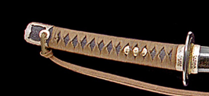

Bruce Pennington Posted April 26, 2021 Report Posted April 26, 2021 On 4/26/2021 at 10:49 PM, PNSSHOGUN said: All good steve, yes this appears to be a legitimate Kai Gunto with stainless steel arsenal blade. For future reference Kai Gunto usually had two suspension rings up until late in the war. Kai Gunto Type 94 Type 98 Expand John, The all-white same' is interesting. I've seen plenty where the black lacquer is greatly worn off, but you could always see remnants of the lacquer. This one doesn't seem to show any black at all. If original, it could be an example of the few photos we have of navy officers in a group of army officers and their tsuka seems to have white same'. Quote
Kaiser21 Posted April 27, 2021 Author Report Posted April 27, 2021 On 4/26/2021 at 11:05 PM, Bruce Pennington said: John, The all-white same' is interesting. I've seen plenty where the black lacquer is greatly worn off, but you could always see remnants of the lacquer. This one doesn't seem to show any black at all. If original, it could be an example of the few photos we have of navy officers in a group of army officers and their tsuka seems to have white same'. Expand Bruce: By the "all white same" I take it you're referring to the ray skin on the Tsuka? Not to be mercenary, but I'm tempted to pick this sword up however I'm not keen on overpaying for it. Quote

Bruce Pennington Posted April 27, 2021 Report Posted April 27, 2021 On 4/27/2021 at 12:16 AM, Kaiser21 said: Bruce: By the "all white same" I take it you're referring to the ray skin on the Tsuka? Not to be mercenary, but I'm tempted to pick this sword up however I'm not keen on overpaying for it. Expand Navy rayskin is normally lacquered black; From Ohmura's site. This is one of mine. You can see where the lacquer has worn off, yet still see the remnants of it: Quote
