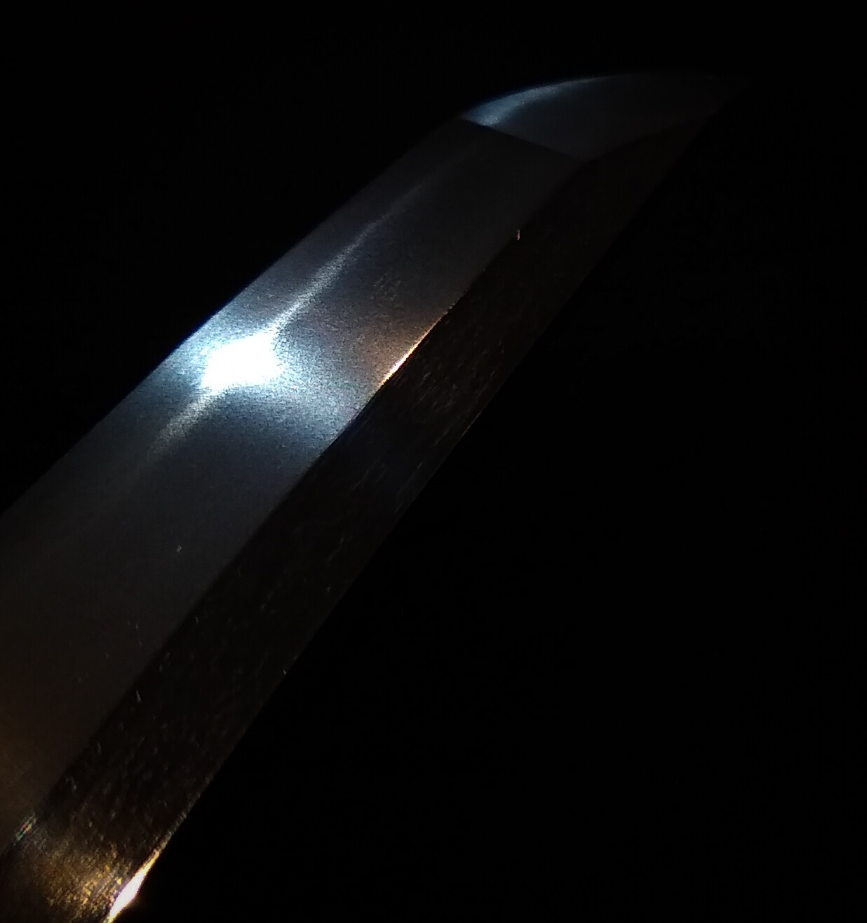

38 minutes ago, Darkcon said:
Nicely polished/preserved boshi. Wish to see more of the hada. Cheers.
John
Thanks John, I'll take some once it gets here.
The boshi is hard to see, maybe you could tell me; does it have any kaeri. A feature is a rather long kaeri for Yamato Mihara blades. Not a law as I have ore that is fairly short frrom an omaru boshi. The chu-suguba is an attractive feature to me. John
Hi John, I am sharing a photo of the boshi here. There is a short kaeri which ends just short of the shinogi.
  • Thanks 2

Ko-mihara arrived! Not as flashy as the other two threads but uch harder to get in photographs how nuanced all the detail in the steel is. :thumbsup:
@Darkcon some attempts at the hada... I did not have my better iPhone camera handy. @John A Stuart another boshi shot for you as well.
Will try again in better lighting, these do not do it justice.
