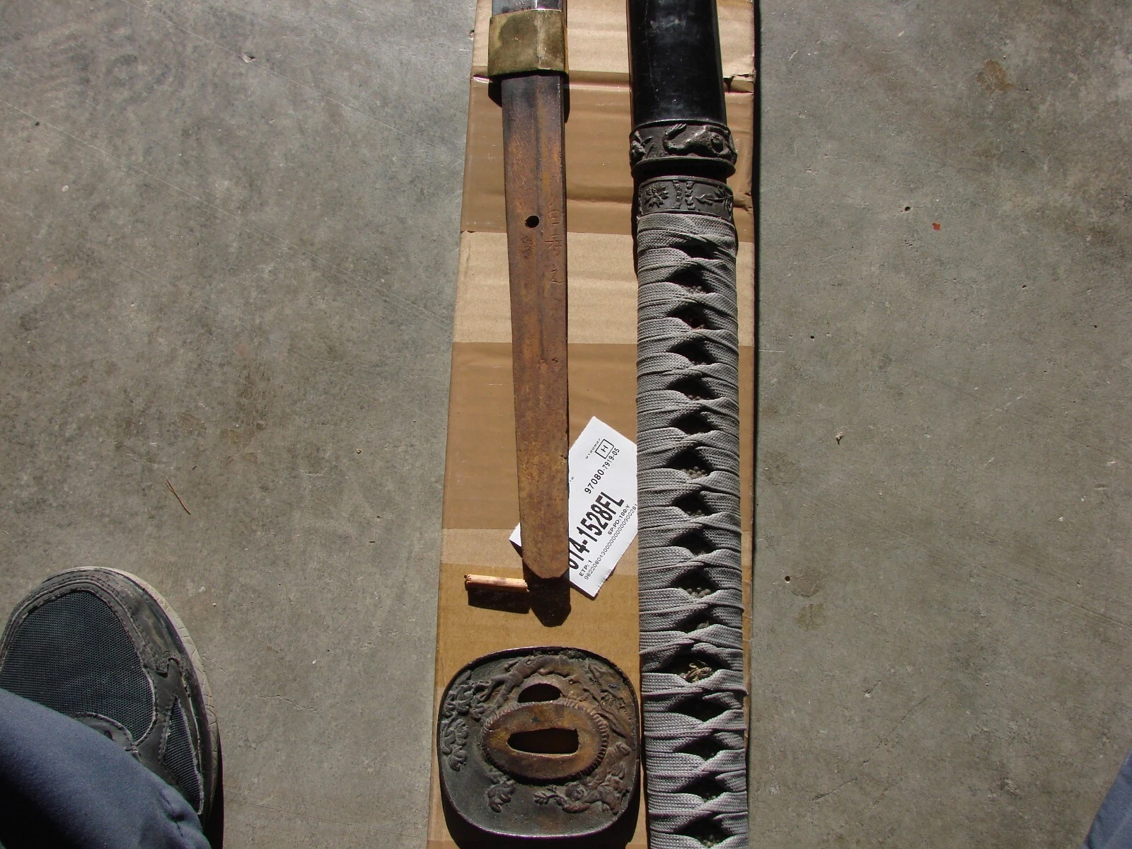

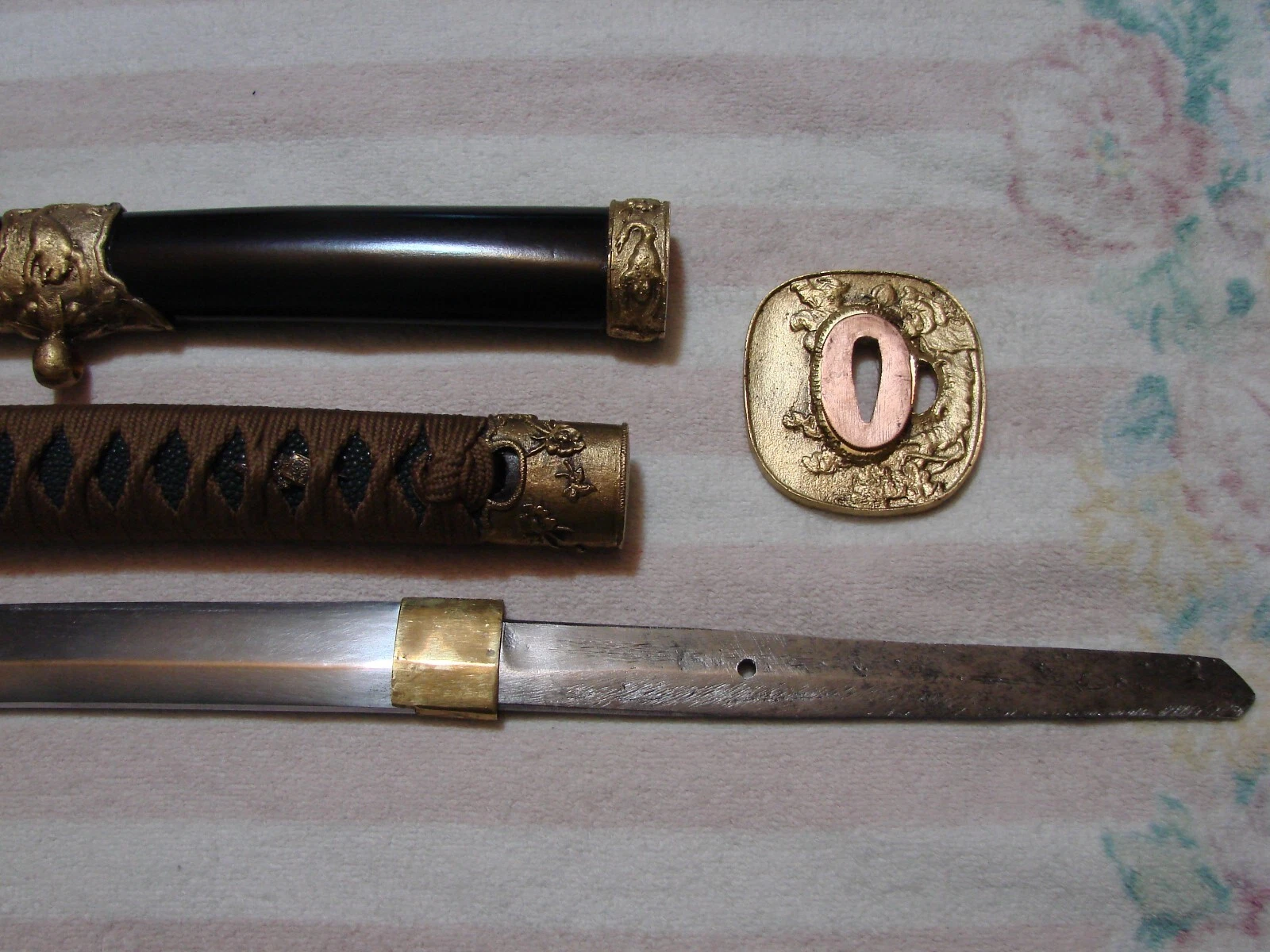

Joseph P. Posted February 4, 2025 Report Posted February 4, 2025 I've had an eBay listing on my mind for a couple weeks now, it ended two weeks ago. Figured I'd post it here. This sword is likely a Chinese fake, but it is a good example of what improper restoration does to a possibly good sword. It's not uncommon for a beautiful sword to resemble a Chinese fake after a hack job like this. https://www.ebay.com/itm/167255200059 Quote Very Old Very Good Very sharp Katana sword signed# Yamada Toshiyuki ( I don't know the sigature, I contact Japan antique shop to translate for me ) Age: unknown, Sori: curve, Nagasa: 68cm, Motohaba: 3cm, Sakihaba: 2cm, Motogasane: 0.8cm, Sakigasane: 0.6cm / I don't have any information for this sword, when i got very old, dirty, heavy rust scabbard broken and the handle and parts not fit good as seen on 2 pictures and I have repair & restore & clean all rusty off and buffing good, One side on the blade very good, other side have nicks on middle blade as seen in pictures, the handle has new genuine stingray skin and new silk cord wrap, the rest original, tsuba get rust eat up by ages and i have seppa glue on tsuba both side to keep it one piece, This sword is now restore very good, No return, No waisting times, Thank you. Quote
PNSSHOGUN Posted February 4, 2025 Report Posted February 4, 2025 Thankfully it was an absolutely hideous Chinese fake, but I understand the sentiment of how a real swords could've just as easily fallen to the whims of idiots. Quote
ROKUJURO Posted February 4, 2025 Report Posted February 4, 2025 This ad was obviously two different blades, both not Japanese. No big loss, but yes, amateur restoration never enhances a sword. Quote
Robert S Posted February 6, 2025 Report Posted February 6, 2025 You can see that it was "buffing good" alright, probably with a power buffer, which has completely blurred the shape (even of a "hideous Chinese fake") :-) Quote
