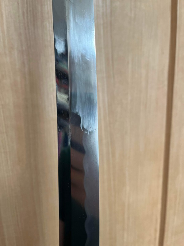

Katsujinken Posted November 7, 2024 Report Posted November 7, 2024 Practitioners who cut regularly in Japan will simply have their swords sharpened on a stone, without proceeding to true polishing stages (see photo). This takes only a few minutes. As mentioned above, there are also some togishi who offer a “batto polish,” which is maybe around $1000 and not as extensive as an art polish. To the untrained eye a batto polish looks nice though! Not all traditionally made swords are meant to be art. But knowing and appreciating the difference is important. I train with both non-Japanese shinken and shinsakuto. 1 1 Quote
