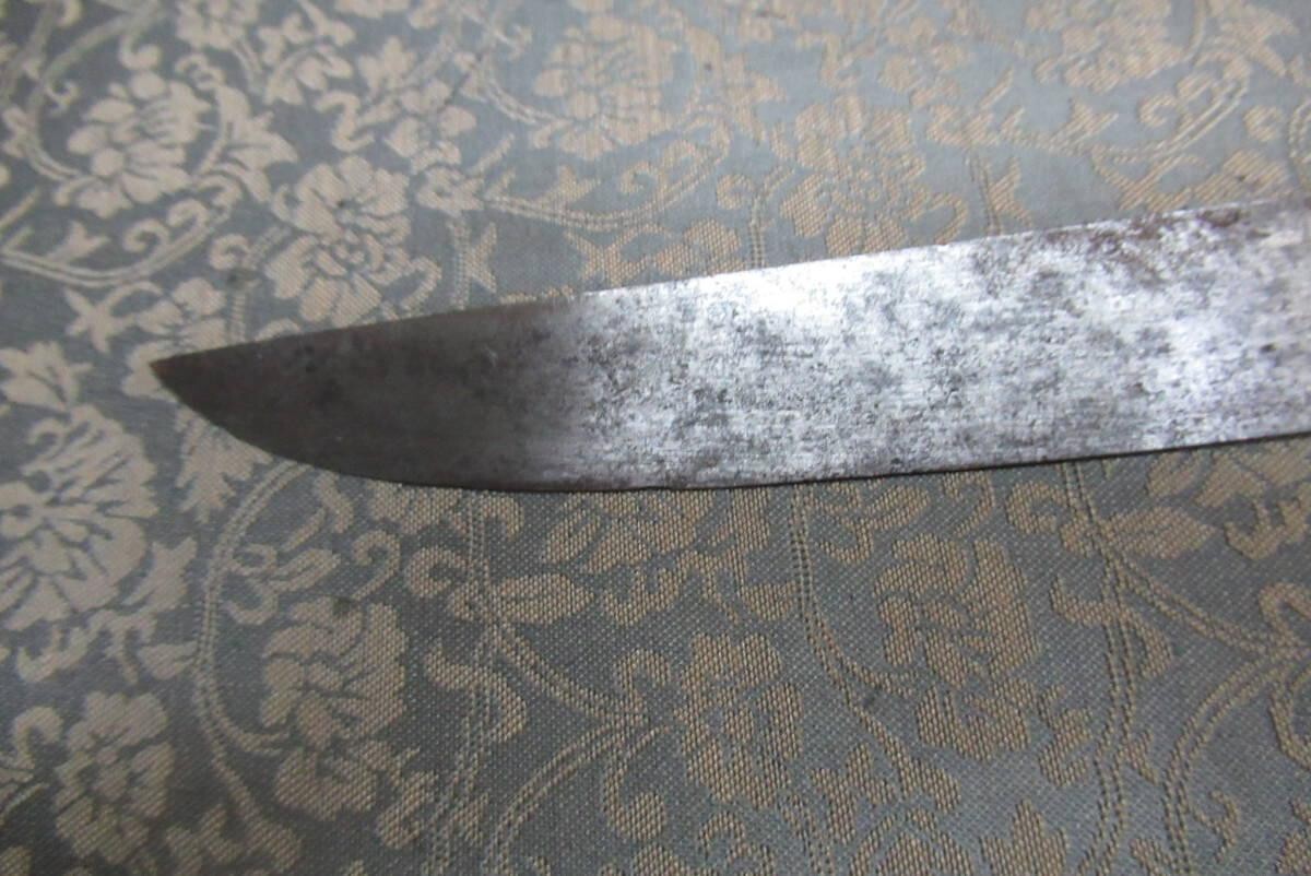

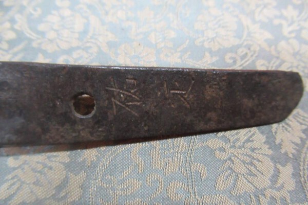

Mac49 Posted February 20, 2023 Report Posted February 20, 2023 Hi Everyone, First of all, thank you to all of you for sharing your information. It it very useful to amateurs like me, and all of you just helped me to avoid making a big mistake. I bought a tanto directly from a Japanese online auction (see pictures attached). It is signed, but I am not expecting a great value. Of course, I lack all knowledge to make a judgement. It is the first Japanese blade I bought. My aim was to restore it in order to gain experience and buy a rusted Wakizashi or Katana blade afterwards, which I planned to restore too. In the past, I restored most of the old tools of my grandfathers, and therefore thought that I had enough experience to 'clean up' this tanto. The more I inform myself, the more it seems that I was wrong :-) The first post tackles a question that every amateur seems to have, including me: Is it better to leave the blade rusting? Given that rust harms the metal, and given that professional polishing is often too expensive compared to the value of the blade, and given that professional polishers don't seem to have time for lesser blades, given these pros are very scarce in some regions of the world, etc. The reality seems to be that a lot of blades never reach these professional polishers, and just continue to rust on someones shelf. It seems only logic that an amateur can not judge if a blade is valuable or not. So my question is: If I contact a professional polisher, and he tells me my blade is of lesser value, than what would be best (most realistic) for the blade? I want to apologize as I understand that this is a very important subject. But I really feel that everywhere I look for information, I get a theoretical answer on a practical question. I am sure that everyone would benefit from it if amateurs like me would have a (for us) understandable answer on why "it is better leave our blades to rust, than to remove its rust", even without removing much material, or using chemicals or other techniques that could affect the metal. Thank you in advance!!! Thomas 293f5e6 293f5e4 293f5e3 Quote

Mark S. Posted February 21, 2023 Report Posted February 21, 2023 So a quick shoot from the hip evaluation. It looks like a blade that was rusty, ‘cleaned’ with steel wool or sand paper and allowed to rust again. I only say that because it ‘appears’ that there is rust over the numerous longitudinal scratches on blade, but it is really tough to tell. It would help to see bare blade with no habaki and more close ups. My recommendation for now is “do no more harm”… Clean blade with the highest concentration of isopropyl alcohol you can, then keep it well oiled. Do not touch nakago except for very active red rest. Some of the blade rust may come off with repeated oiling and cleaning. Then seek out someone who can show you the proper way to use uchiko and obtain HIGH QUALITY uchiko. The blade in its current condition probably won’t be harmed a lot more than it already is with gently uchiko applications. You will need to be patient and resist the urge to hurry results. That is probably the hardest part. Over time (think months or even years - not hours or days) some of the activity may reveal itself. It’s either that or just get it in the hands of a qualified polisher. 1 Quote
Franco Posted February 21, 2023 Report Posted February 21, 2023 If this were my blade the only thing that I would do is keep the blade oiled including a very light film of oil on the nakago. Then, change the oil about once a week being very careful not to rub any grit or dirt into the surface of the blade. In other words tamp the old oil off with an unscented plain clean kleenex instead of using a wiping motion. I would not recommend using uchiko to remove and change the oil here, especially on a blade with an uncleaned surface that is not free of rust. On active red rust I would change the oil daily until the rust is under control. When in doubt consult a qualified polisher. An electronics grade 99.9% anhydrous isopropyl alcohol will work to remove sword oil, but take full precautions as it is nasty stuff. 1 Quote
