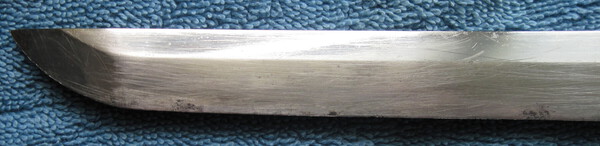

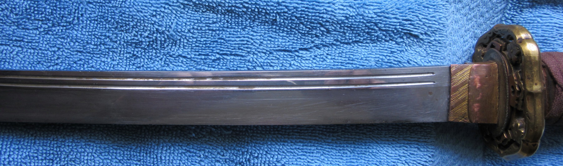

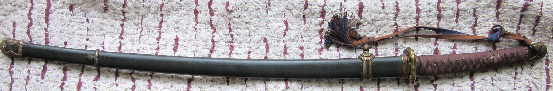

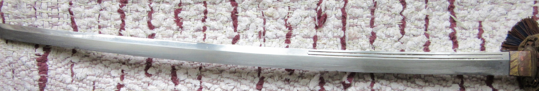

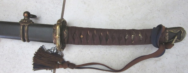

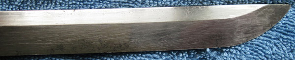

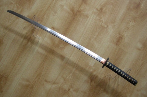

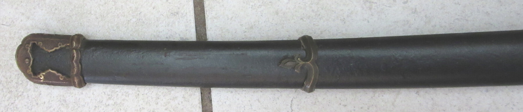

panzerbob Posted April 21, 2021 Report Posted April 21, 2021 Hello Everyone: I’m new to the forum I just pickup this Nihonto Sword and would like some information on it.It has a straight hamon which is barely visible. Had it on Wehrmacht militaria forum and they suggested I place it here on the Nihonto sword forums for more information. I would greatly appreciate any information Thanks. Here is the link to Wehrmacht awards to see the pics it seems my pics are to big to down load to this site. https://www.wehrmacht-awards.com/forums/forum/ken-jasper-international-militaria-forums/Japanese-militaria-forum/12286837-Japanese-sword-help Quote

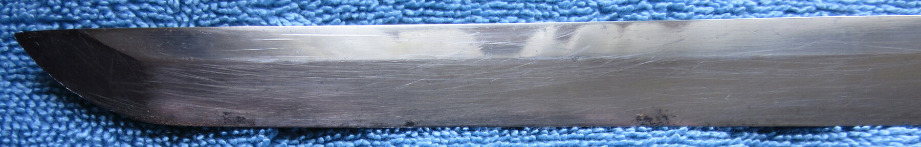

Shugyosha Posted April 21, 2021 Report Posted April 21, 2021 Hi Bob, The blade doesn’t look like a wartime blade to me - I’d guess it to be older than that. I’m not saying it’s a lost treasure, but it looks more interesting than a normal gunto. Unfortunately, it’s hard to date it precisely without being able to see the detail, so sorry to send you back to your camera but if you are able to post some detail shots of the hamon, the tip and any evidence of the metal having been folded ie grain pattern, you’ll probably get some better answers. I can’t add anything about the fittings so I’ll leave that to the gunto guys. 1 Quote

SteveM Posted April 21, 2021 Report Posted April 21, 2021 Fairly long sword, only slightly suriage (I think), double bo-hi on one side, single bo-hi on the other... this could be interesting. 1 Quote
16k Posted April 21, 2021 Report Posted April 21, 2021 I don’t think it is a wartime blade either. That looks much older. Quote

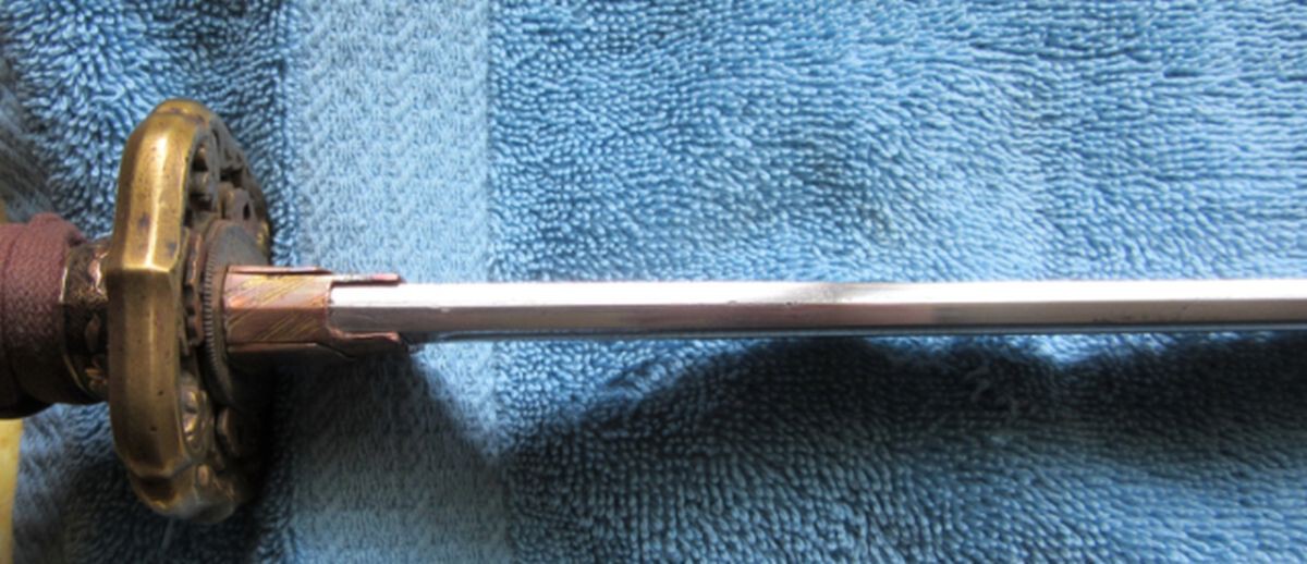

John A Stuart Posted April 21, 2021 Report Posted April 21, 2021 I think it is an older blade as well. It really needs a closer inspection. I can't see any inscription (mei) on the tang (nakago), I'll assume not one unless you see such. Perhaps some experienced collector in Michigan may be close and give a hand. John Quote
BenVK Posted April 24, 2021 Report Posted April 24, 2021 Blade reminds me of the Kiyomitsu I sold not long ago. Quote
panzerbob Posted April 24, 2021 Author Report Posted April 24, 2021 Hello I want to thank everyone that commented on the sword I appreciate you taking the time to help. I will try to find someone that can look at it. To bad the tang wasn't signed would of make it much easier. Bob Quote
Bruce Pennington Posted April 25, 2021 Report Posted April 25, 2021 On 4/24/2021 at 12:34 AM, BenVK said: Blade reminds me of the Kiyomitsu I sold not long ago. Expand Ben, any idea of the age of that one? Bob, The fittings are customized for the older blade. So, the owner spent a little more money on this. Quote
BenVK Posted April 29, 2021 Report Posted April 29, 2021 Hi Bob, the Kiyomitsu was from the late 17th, early 18th century. Quote
jesup Posted May 16, 2021 Report Posted May 16, 2021 Sugata looks kanbun shinto to me -- but that's about all I'm going on so far. The pictures of the tang seem like early shinto or late koto; the hi imply to me it's mumei ubu, so I'd put it say 1580-1650 -- but I'm going way out on a limb given the lack of detail in the pictures. Just trying as an academic exercise, since I've been out of things so long :-) Quote
Jamie Posted May 18, 2021 Report Posted May 18, 2021 To me it looks like someone “cleaned” it. The yokote line is not so prominent and it looks fairly scratched vertically. I too would guess it’s older but definitely needs some restoration work to tell period. a picture of just the whole bare blade laid out would help probably tell period. Welcome to the forum, btw. Quote

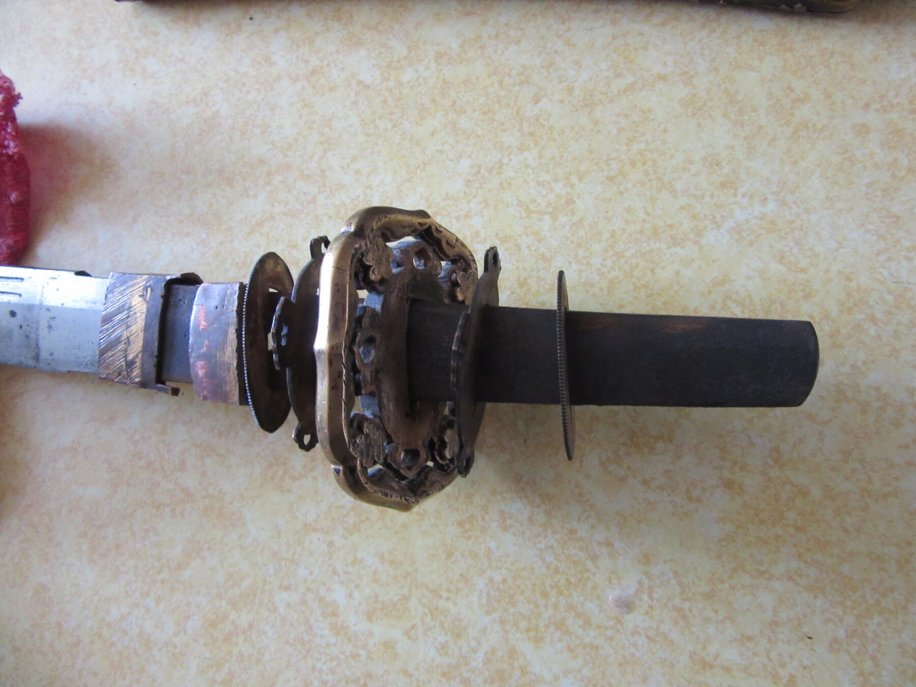

PNSSHOGUN Posted August 17, 2021 Report Posted August 17, 2021 The Gunto mounts are early Type 94 pattern with separate Sarute barrel. 1 Quote
