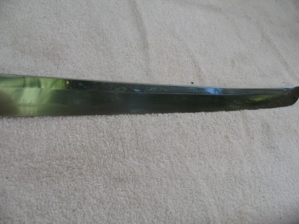

Being a Takayama-to, it likely is one of the "stainless" blades that were produced for the navy.
Therefore the hamon will be artificial, and polished on. The polisher would have been responsible for the final lines and maybe adding the "hamon"
As such, they would not be allowed into Japan, and therefore a Japanese togishi could not repolish one.
A Western polisher would though. (But why would you want to, if there is no hamon or hada to bring out?)
Brian
cheers brian for the link but i was one step ahead of you :D ...as stephen says we cannot be sure if its stainless steel with a polished on temper line....noticed the tang as a dark patina / rust......would stainless steel be like that.
also on the link it shows a sword by mashiro......made at takayama prison :rotfl:
I would not be too quick to state that this is a false hamon[ although in this case it may be]. The Takayama-to that I have does indeed have a temper into the metal even though it is simple and straight and tough as hell. I will try to get a picture posted. If I am understanding this thread, there might have been a special steel developed by a man named Takayama. Would all swords made from this material be classified as Takayama-to? Would this be a specialized area of collecting as in Mikasa-to [ was that the battle ship?] and Manchurian railroad swords? The plot thickens Scott
