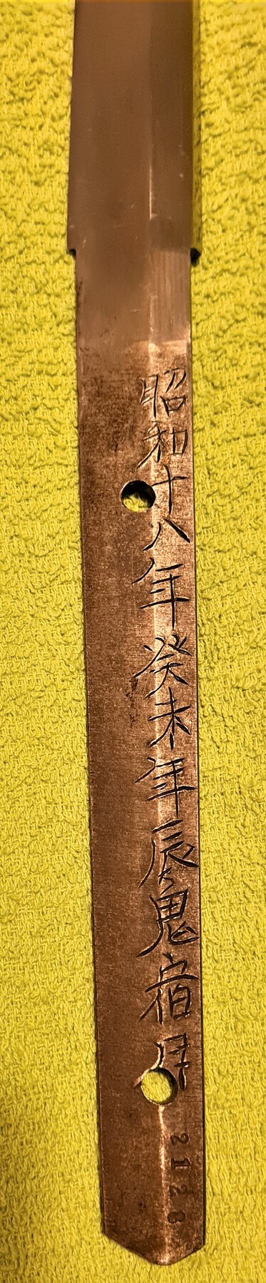

Bruce Pennington Posted April 7, 2021 Report Posted April 7, 2021 Hey guys! Looking for a translation of this unusual date inscription. The 1943 is obvious, but not getting anywhere with what follows it. (owned by an NMB member). Quote

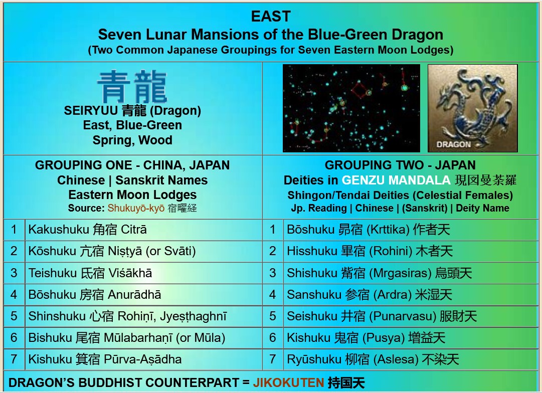

uwe Posted April 7, 2021 Report Posted April 7, 2021 It’s followed by the zodiac date (Mitsunoto Hitsuji) “...癸未年辰鬼宿月” and then with what I would translate as (month of the dragon ghost ?!).... The dragon stands for the third month of the lunar calendar and “鬼宿” refers probably to the Chinese “ghost” constellation (one of the 28 mansions)...but I can be also totally wrong 2 1 Quote
Bruce Pennington Posted April 7, 2021 Author Report Posted April 7, 2021 On 4/7/2021 at 6:54 AM, uwe said: third month of the lunar calendar and “鬼宿” refers probably to the Chinese “ghost” constellation Expand Thanks Uwe! What a peculiar way to date a blade with the year stated twice. I bet your thought on the last bit referring to a month is right. I did find a reference where it could also mean "Spring." 1 Quote
uwe Posted April 7, 2021 Report Posted April 7, 2021 Ah, thanks for sharing, Bruce So the first seven mansions are standing for spring (East, Azure Dragon). 8-14 for winter (North, Black Tortoise), 15-21 for fall (West, White Tiger) and 22-28 are left for summer (South, Vermillion Bird). That was new to me, as also the fact seeing it used in a nengo.... Nice find 1 Quote

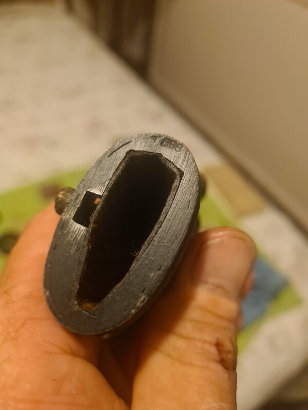

Kiipu Posted August 6, 2021 Report Posted August 6, 2021 Below is another post that you made about the same sword. The post is edited for brevity. On 4/6/2021 at 2:53 PM, Bruce Pennington said: OK, here's a couple to throw a monkey wrench in the issue: Both provided by Tim Blackburne. 1. Akimitsu,1943, star-stamped, "Na" on mune, イ536 on all fittings ....... But 2128 on the blade. Expand 1 Quote

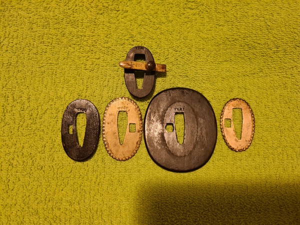

Bruce Pennington Posted August 7, 2021 Author Report Posted August 7, 2021 On 8/6/2021 at 6:59 PM, Kiipu said: another post that you made about the same sword. Expand Thanks Thomas! I had mis-labeled that one. Corrected now. I'm afraid I don't have a shot of the mei-side. I have all the numbered items, but for some reason don't have the mei. I did a search on Tim Blackburne, who is @ww2shingunto, but don't see this blade in his 2 threads. Here are the other numbered items: 1 Quote
BANGBANGSAN Posted August 9, 2021 Report Posted August 9, 2021 If it's 辰月鬼宿日 ,then should be 农历3月23日,1943.4.27 in the Gregorian calendar. 2 Quote
BANGBANGSAN Posted August 11, 2021 Report Posted August 11, 2021 On 8/9/2021 at 9:07 PM, Kiipu said: Cross Reference 昭和十八年癸未年辰鬼宿月 Expand I found the answer! It's 1943.4.11.Lunar calendar 3.7. 2 Quote
george trotter Posted August 11, 2021 Report Posted August 11, 2021 On 8/7/2021 at 3:36 AM, Bruce Pennington said: Thanks Thomas! I had mis-labeled that one. Corrected now. I'm afraid I don't have a shot of the mei-side. I have all the numbered items, but for some reason don't have the mei. I did a search on Tim Blackburne, who is @ww2shingunto, but don't see this blade in his 2 threads. Here are the other numbered items: Expand Hi Bruce, May have discussed these marks before...can't rememeber, but (again?) for your files... This one you show is a blade by Igarashi Akimitsu, RJT star of Niigata. Date 4/1943 (2128 na) on tang, marked 'i'536 on all RS metal parts. Mine is by Yamagami Munetoshi RJT of Niigata. Date 8/1943 (1080 matsu) on tang, marked 'i'403 on all RS metal parts. Both RJT, both 1943, both Niigata, both 'i' number on parts. Regards, 1 Quote
Kiipu Posted August 11, 2021 Report Posted August 11, 2021 Not sure if this helps but I did locate a YouTube video about this sword. No images of the tang though. WW2 Japanese Type 3 Shin Gunto made by Hiragawa Akimitsu, 1943 Quote Gendaito katana Signed, Fujisan Roku ju Hiragawa Akimitsu Dated, Showa Jyu Hachi Nen (1943) Mizunoto Hitsujidoshi (1943) Tasu Oni Shukugetsu Star stamp, number stamp 2128 All koshirae numbered T536 Rikugun Jumei Tosho Expand Quote
ww2shingunto Posted August 12, 2021 Report Posted August 12, 2021 Hello guys. Thank you all for your help with my sword. I am not very good with uploading images but I will try to load the signature side in this post. Trystan, could you please explain to me how you found the date to be April 11th instead of March 23rd as first thought? Tim Blackburne 1 Quote
Kiipu Posted August 12, 2021 Report Posted August 12, 2021 These are the transcribed kanji characters on Tim's sword. As seems to be the case on early blades, the star stamp seems to indicate acceptance by the army. Obverse: ☆ 富士山麓住平川昭光 2128 = ☆ Fuji Sanroku jū Hirakawa Akimitsu 2128. Reverse: 昭和十八年癸未年辰鬼宿月 = 1943-04-11. Nakago mune: No markings. Tang holes: 2. Fittings: Type 100. 1 Quote

BANGBANGSAN Posted August 12, 2021 Report Posted August 12, 2021 On 8/12/2021 at 10:59 AM, ww2shingunto said: Hello guys. Thank you all for your help with my sword. I am not very good with uploading images but I will try to load the signature side in this post. Trystan, could you please explain to me how you found the date to be April 11th instead of March 23rd as first thought? Tim Blackburne Expand Tim I use the online perpetual calendar(万年历)to search 1943 April and looking for 鬼宿 on which day. You can also check out this Cross refernce start by Thomas (Kiipu) https://www.warrelics.eu/forum/Japanese-militaria/ae-oea-c-aeoe-e-e-aeoe-799445/#post2187969 It would be nice if you can upload some photos of the whole sword(mount, handle,blade ).Thanks 2 Quote
