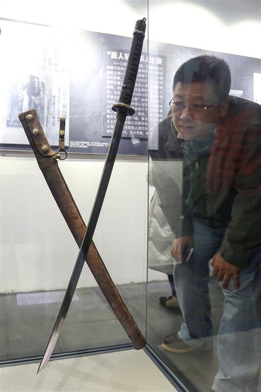

There were many atrocities committed in Manchuria, with Lieutenant Toshiaki Mukai participating in one such. Without going into detail, we can see that he indeed was carrying a Type 98 in the field (keep in mind the Rinji had not been 'invented' yet). This sword is displaced in Shanghai and was the subject of controversy in 2017 when a Taiwanese man used the blade to attack an official Japanese government party. The tsuba on that particular sword is visible here - and is of brass/ornate construction

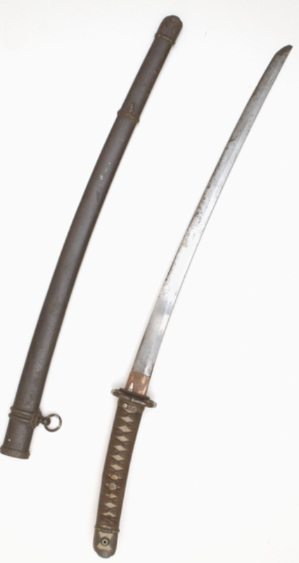

Progressing on through the war, the Australian War Memorial describes the following sword as belonging to a war criminal who hung for executing 8 Australian soldiers with this sword. This shows clearly a Type 98 sword and not a Rinji. The War Memorial caption describes the tsuba as pierced.
