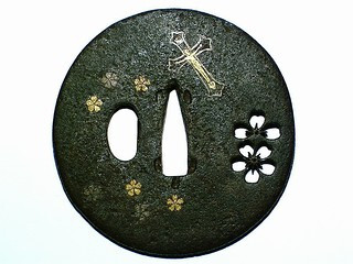

Speaking of "overt" symbols, here's one from the resurrected "Heianjo damage" post:
It's from Richard George's RKG collection... he always seems to have just the right image for every occasion lol
To me, this looks like the symbol of an actual church!
Glen,
Just to be clear This isn't my piece (I wish it was).  I shot it for somebody else and was given permission to show the images for discussion purposes.
Because of the pretty overt Christian symbol its an amazing study piece because you -know- it wasn't mounted after about 1637 (unless one had a death wish).  Note that there was a fair amount of missing inlay, even from un-corroded/un-worn  surfaces on it.  We'll probably never know if it was a fashion/wabi sabi thing, the owner yanked the bits that were tearing at clothing, or what.

Just found this on https://www.samurai-nippon.net/SHOP/T-940.html
The highlighted part of the NBTHK kanteisho reads:
十字架銀据付(後補) - jūjika gin-suetsuke (goho)
and should mean something like: Christian cross piece in silver (later addition).
If my understanding is correct, some interesting inferences could be drawn.
1 - the theme of dragons chasing the sacred pearl had some special meaning for early Japanese Christianity;
2 - NBTHK shinsa panel sometimes certify as authentic a modified (forged?) tsuba.
I'm quite perplexed about both conclusions (but I know nothing).
Bye, Mauro
  • Love 1
The Tsuba looks original, Mauro, and the paperwork although clear about the subsequent addition of the cross, does not suggest how much later the work was done.
At a slight angle, and with a Ken blade at the top, it looks to be made of silver. An interesting object, surely, whichever way you cut the cake.
PS Although Namban Tsuba are generally not too highly rated in Japan, IMHO, there are some fantastic examples out there. I must confess to having a few unusual ones hidden in the back of a dark drawer.
The possible religious element is romantic, true, but surely of secondary importance.
