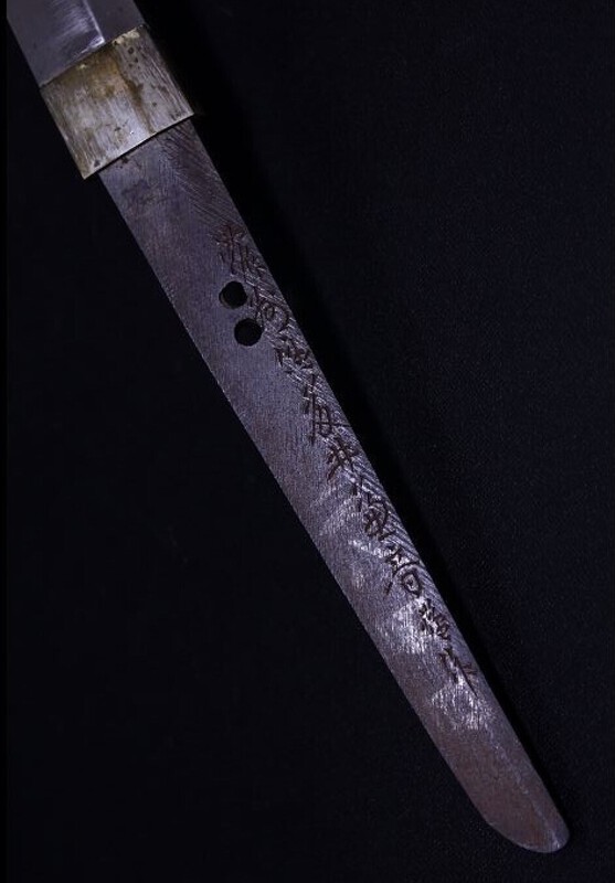

Kiipu Posted October 13, 2022 Report Posted October 13, 2022 Aichi Prefecture ☆ 三州住筒井清兼作 115 = ☆ Sanshū jū Tsutsui Kiyokane saku 115 ☆ 昭和十九年二月日 = ☆ A day in February 1944 Star stamped on both sides, sideways serial number the same as used by Aichi swordsmith Kanemitsu 兼光. Star Stamped Tsutsui Kiyokane Blade, Post #26 @Ganko Kōchi Prefecture, Shikoku ☆ 建依別山村善貞 kao = ☆ Tateyoriwake Yamamura Yoshisada plus koa. 昭和十九年四月日 = A day in April 1944. Nakago mune: 38. Help translating, hopefully not a gimei or at least a good one @mecox 1 1 Quote

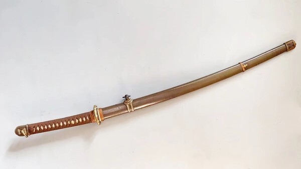

BANGBANGSAN Posted October 21, 2022 Report Posted October 21, 2022 @Bruce Pennington Do you have this one?From member Daniel(Sweden)。Star stamped RS with leather cover, the number is 615. 昭孝 Akitaka 昭和十八年一月吉日 1 Quote
Kiipu Posted October 21, 2022 Report Posted October 21, 2022 On 10/21/2022 at 2:54 PM, BANGBANGSAN said: Star stamped RS with leather cover, the number look like 615? Expand Cross-Reference ☆ 昭孝 = ☆ Akitaka. 昭和十八年一月吉日 615 = A lucky day in January 1943 615. Another star stamped gendaito 1 Quote

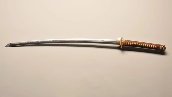

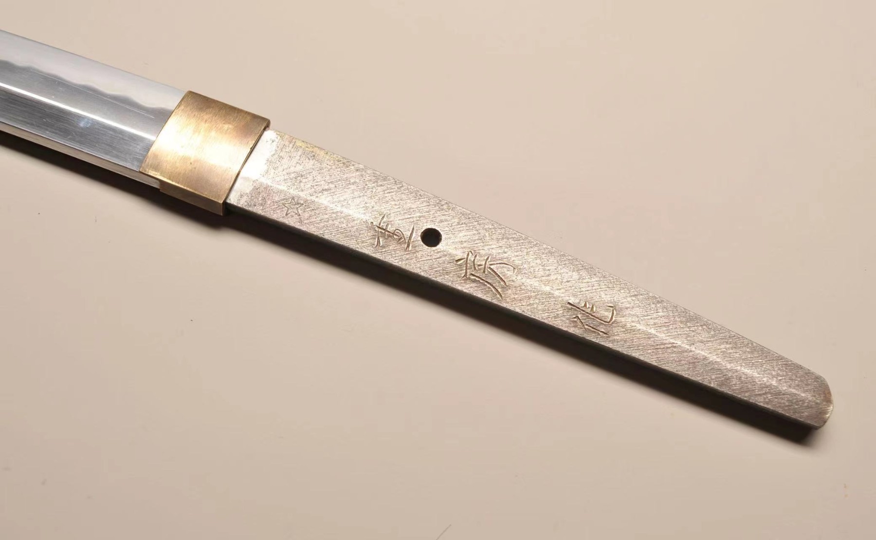

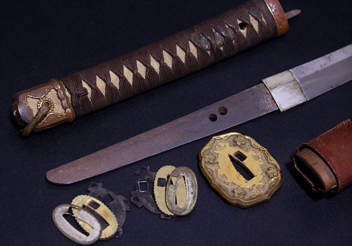

BANGBANGSAN Posted October 27, 2022 Report Posted October 27, 2022 @Bruce Pennington @Kiipu Guys, here is a Star stamped Kaneoto兼音 in RS mount,no Ser#. 関住藤井兼音作 昭和十九年二月 1944 Feb. The signature looks different than his not dated Non-RJT work. 1 1 Quote
Bruce Pennington Posted October 27, 2022 Report Posted October 27, 2022 On 10/27/2022 at 2:50 AM, BANGBANGSAN said: Guys, here is a Star stamped Kaneoto兼音 in RS mount,no Ser#. 関住藤井兼音作 昭和十九年二月 1944 Feb. The signature looks different than his not dated Non-RJT work. Expand The difference could be due to a nakirishimei. Slough has many examples of variations due to this with other smiths. I have never seen a gimei with authentic looking "Na" stamps like this. Quote
george trotter Posted October 28, 2022 Author Report Posted October 28, 2022 Nakirishi mei on a RJT blade? I would be surprised as this was 'unlawful' - the RJT rules say the sword must be signed and dated by the smith who made it. Be interested to know if it is nakirishi mei - has anyone else got one? 1 Quote
BANGBANGSAN Posted October 28, 2022 Report Posted October 28, 2022 On 10/28/2022 at 1:42 PM, george trotter said: Nakirishi mei on a RJT blade? I would be surprised as this was 'unlawful' - the RJT rules say the sword must be signed and dated by the smith who made it. Be interested to know if it is nakirishi mei - has anyone else got one? Expand I think the blade without the date like these, mei was done by 切銘師, and the other one with the star stamp's mei was done by 兼音 himself. , 1 Quote

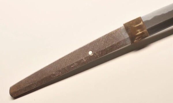

BANGBANGSAN Posted November 2, 2022 Report Posted November 2, 2022 Star stamped Type 98, no Ser#。 重房作 Shigefusa 壬午十一月 1942.November Not sure if he is the same 重房( 6th Generation 重房 -若林重次 Wakabayashi Shigetsugu) who worked for Mantetsu from 1937-1941。 Quote
Bruce Pennington Posted November 3, 2022 Report Posted November 3, 2022 On 11/2/2022 at 12:54 PM, BANGBANGSAN said: 重房作 Shigefusa 壬午十一月 1942.November Not sure if he is the same 重房( 6th Generation 重房 -若林重次 Wakabayashi Shigetsugu) who worked for Mantetsu from 1937-1941。 Expand Thanks Trystan! The only RJT Shigefusa I find reference to is Kojima. Wakabayashi is discussed in Slough & Sesko without mention of RJT work. So, I say this was from Kojima Shigefusa. Boy that zodiacal dating, without having the Showa written first, throws me every time! Quote

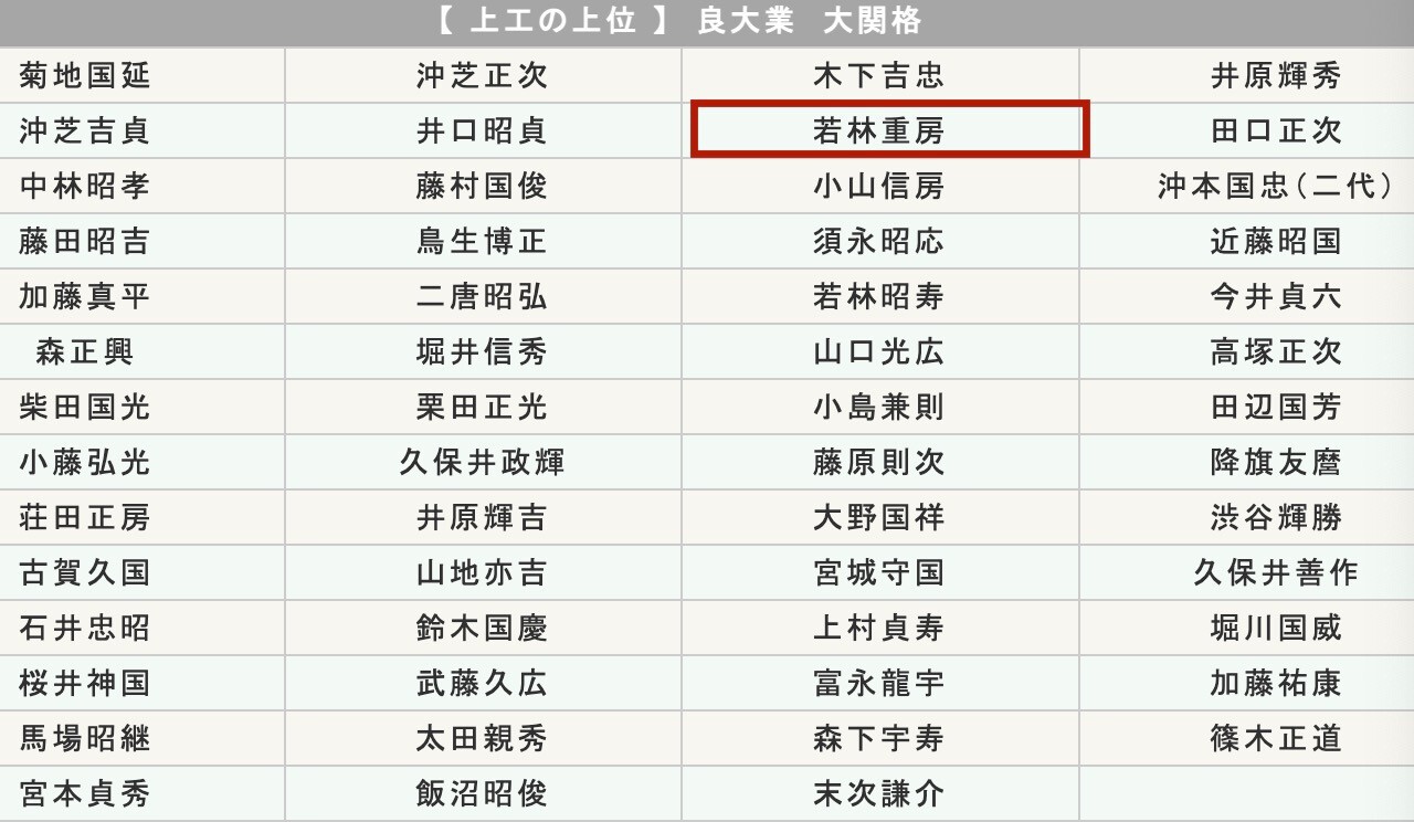

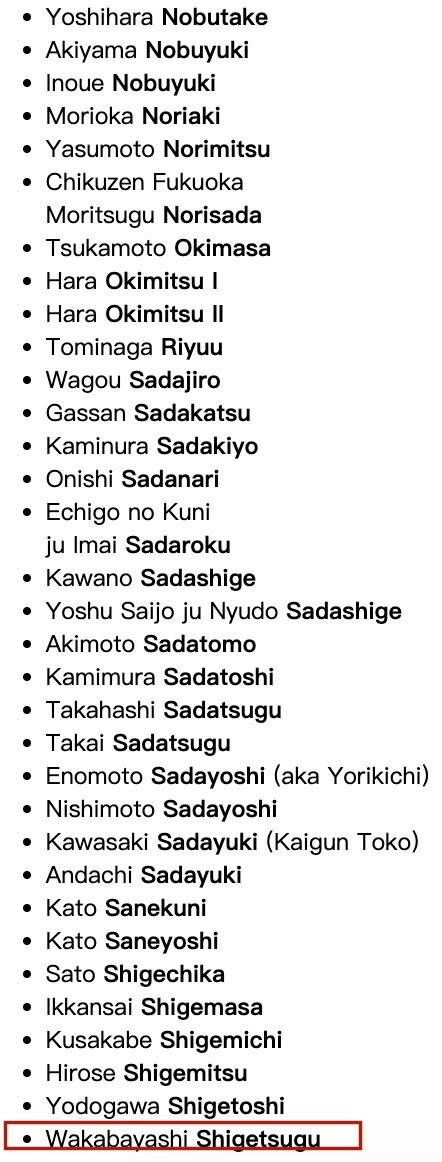

BANGBANGSAN Posted November 3, 2022 Report Posted November 3, 2022 On 11/3/2022 at 12:42 PM, Bruce Pennington said: Thanks Trystan! The only RJT Shigefusa I find reference to is Kojima. Wakabayashi is discussed in Slough & Sesko without mention of RJT work. So, I say this was from Kojima Shigefusa. Boy that zodiacal dating, without having the Showa written first, throws me every time! Expand Bruce 若林重房 Wakabayashi Shigefusa is RJT smith .Read the Thomas's post from Nick's article "In 1941, the family returned to Japan and settled again in Aizu, where he was later accredited as Rikugun Jumei Tosho (army licensed sword smith). Shigetsugu had also signed his earlier commercial work as Shigefusa, but registered as Wakabayashi Shigetsugu in the RJT program. Even so, he made a good number of swords for the black market to be sold as antiques, in which he used the generations old mei of Shigefusa." His name also list http://www.japaneseswordindex.com/gendai2.htm Under Rikugun Jumei Tosho Swordsmiths Known From Literature Sources 3rd Roll He is also list here https://www.tsuruginoya.com/infomation/data/iretsu-seidai Quote

Bruce Pennington Posted November 4, 2022 Report Posted November 4, 2022 And the article states he registered RJT a Wakabayashi Shigetsugu, so it would seem logical (don't know how strictly it would have been followed) to think his star-stamped blades would be under that name, not Shigefusa. Quote

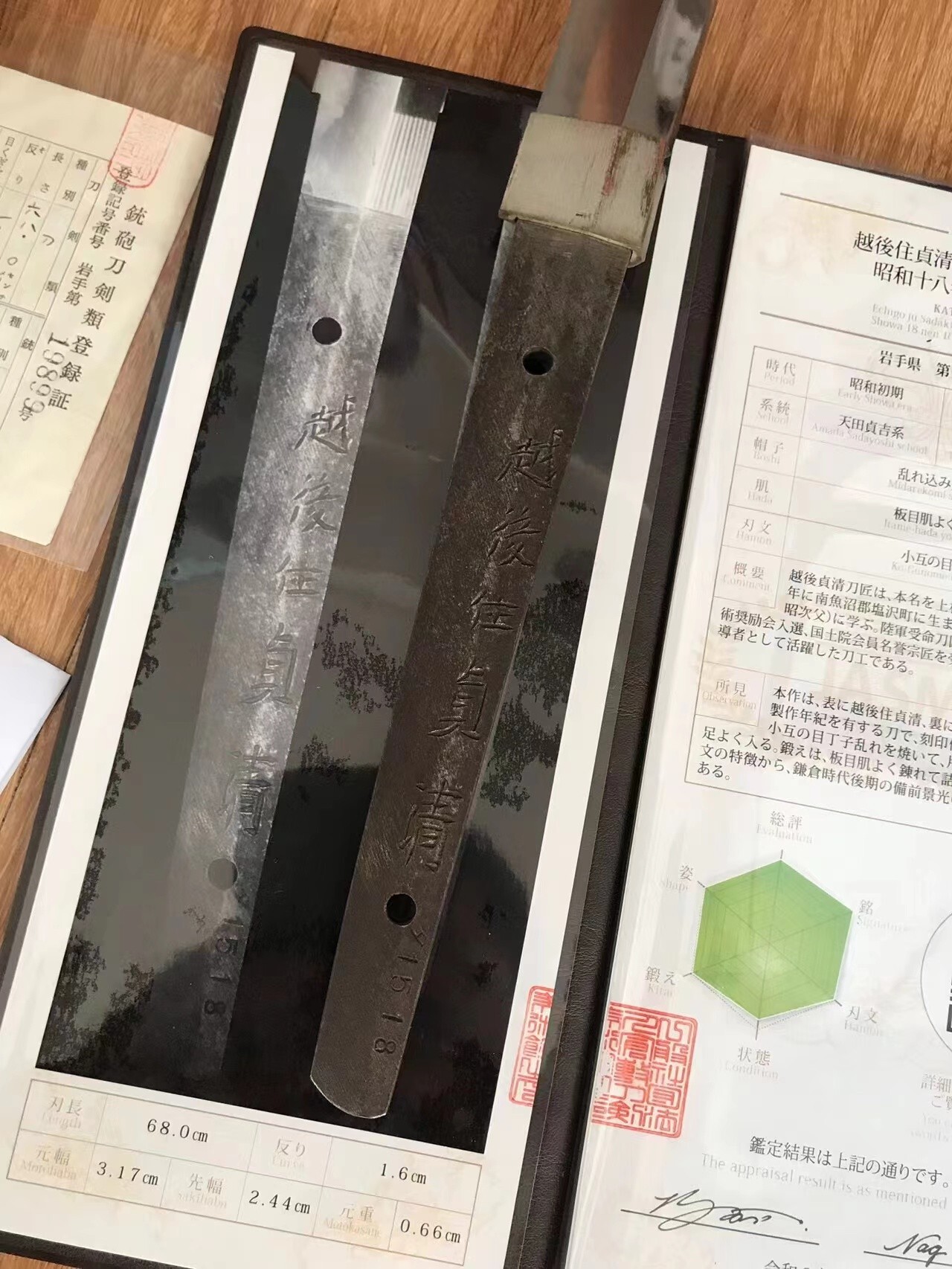

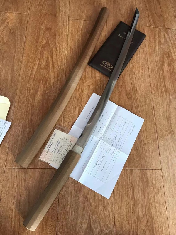

BANGBANGSAN Posted November 8, 2022 Report Posted November 8, 2022 越後住貞清 Ser#タ1518 in Shirasaya, the star stamp is not very clear, but it seems located on the upper left of MekugiAna. 昭和十八年十月吉日( said on the register paper). I don't have any photos of the dating side of the tang. 1 1 Quote
