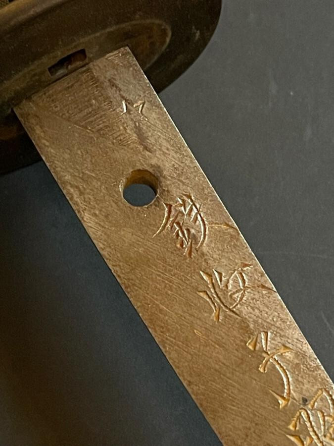

Kiipu Posted August 11, 2021 Report Posted August 11, 2021 On 4/6/2021 at 2:53 PM, Bruce Pennington said: 2. Kanemitsu, 1944, no star, no stamps, "1" on fittings ..... But 24 on nakago Expand Slough on page 49 illustrates a star-stamped Kanemitsu with the same style of sideways placement of the number. In this case, the number is 118. Obverse: ☆ 竹内兼光 118 = ☆ Takeuchi Kanemitsu 118. Reverse: 昭和十九年三月 = March 1944. Nakago mune: Unreported. Tang holes: 2. 1 Quote

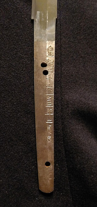

Bruce Pennington Posted August 31, 2021 Report Posted August 31, 2021 Thanks to a tip from @Stephen, got another Matsu stamped blade. It's made by Kiyokuni (RJT), dated Feb 1943, stamped Matsu 16. Kiyokuni worked in Nagano, so the 2nd blade, now, from nagano: Matsu 1941, July Niigata Munetoshi (RJT) 106 (RS ana) Trotter Survey 1941, Sep Niigata Akihisa (RJT) 249 Type 98 Trotter Survey 1941, Sep Niigata Munetoshi (RJT) 308 Type 98 Trotter Collection 1941, Dec Niigata Akihisa (RJT) 566 RS Model Windy NMB ? Niigata Akihisa (RJT) 松 61 RS Trotter Survey ? Niigata Akihisa (RJT) 松 97 NMB 1942, Feb Niigata Akihisa (RJT) 松 542 RS star Trotter Survey 1942, Apr Niigata Munetoshi 松 11 RS Trotter Survey 1942, Nov Niigata Munetoshi 松 422 ? star Trotter Survey 1942, Nov Niigata Munetoshi 松 433 RS star Trotter Survey 1942, Oct Niigata Munetoshi 松 451 RS Davidequis NMB 1942, Dec Niigata Akihisa (RJT) 松 577 RS star MacTheWhopperNMB 1943, Jan Niigata Munetoshi 松 508 Type 98 star Trotter Survey 1943, Feb Nagano Kiyokuni (RJT) 松 16 Ray Singer, NMB 1943, Feb Nagano Chikafusa (RJT) 松 20 Bangbangsan,NMB 1943, Mar Niigata Akihisa 松 618 RS star Schmucker Collection 1943, Mar Niigata Akihisa 松 819 RS star Vajo, Trotter Survey 1943, May Niigata Munetoshi (RJT) 松 1080 RS star Trotter Collection, イ403 on fittings 1943, May Niigata Munetoshi (RJT) 松 1082 RS star baldi1942 NMB 1943, Oct Niigata Akihisa (RJT) 松 1377 RS star Trotter Survey 1943, Nov Niigata Munetoshi (RJT) 松 443 RS star ? NMB 1944, Feb Tsugaru/Aomori Kunishiro (RJT) オ 154, star Trotter Survey 1944, Mar Niigata Munetoshi (RJT) タ2353 Type 98 star Trotter Survey 1942-1945 (ND) Niigata Masakazu (RJT) フ 37 RS star IJASWORDS Quote

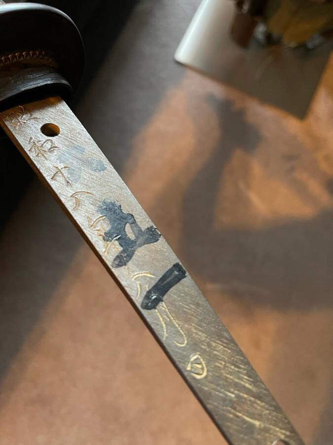

Bruce Pennington Posted September 1, 2021 Report Posted September 1, 2021 On 8/6/2021 at 5:39 PM, Kiipu said: Do you a have a picture showing the entire reverse side of the nakago? Also, are there any markings on the nakago mune? Expand Update on Leo's Akimitsu with different numbers painted on the nakago than the stamped numbers. The fittings are stamped "51" matching the painted numbers. The first "6" was erased, leaving "51". So I quite convinced the stamped numbers are NOT fittings shop numbers, but rather Army numbers, probably something to do with the RJT program. Thomas, we didin't discuss the mune. I will ask about that and follow up on it. Quote

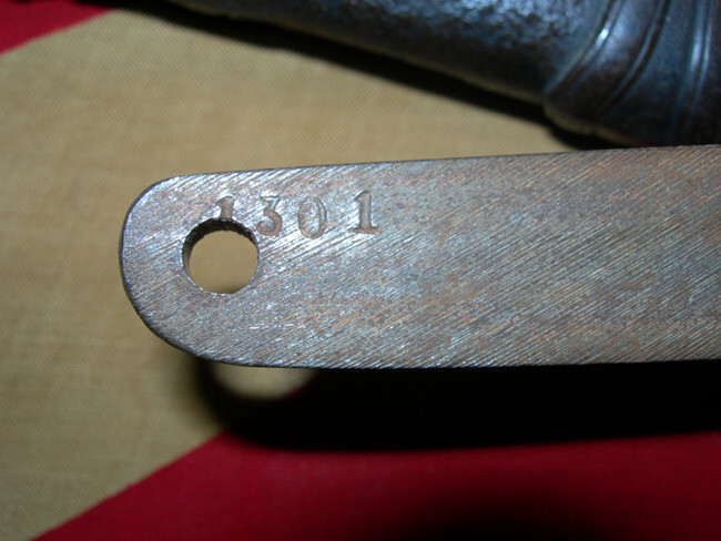

Bruce Pennington Posted February 16, 2022 Report Posted February 16, 2022 On 2/15/2022 at 6:42 PM, Kiipu said: Do you have nakago pictures of the "Ryuu" dated May 1942, serial number 1301? These serial numbers seem to continue where the upside-down serialized starless Type 100s stopped. Starless Type 100s, serial numbers 106 to 798, July 1941 to January 1942, serial number upside-down. Starless Type 100s, serial numbers 1129 to 1220, April 1942 to May 1942. Starred ☆Type 100s, serial numbers 1525 to 2128, August 1942 to April 1943. Expand Here ya go Thomas. I'm sorry, but I've had a couple, and I'm going to have to re-read your train of thought in the morning. I really hope you're working on a book, because we'd all REALLY benefit from any book you'd put out! 1 Quote
Bruce Pennington Posted February 16, 2022 Report Posted February 16, 2022 On 2/15/2022 at 11:23 PM, Kiipu said: Obverse: 昭和十七年五月 1220 = May 1942, serial number 1220. Expand I'm drinking coffee as fast as I can, but I can't see what you're working out here, sorry! Quote

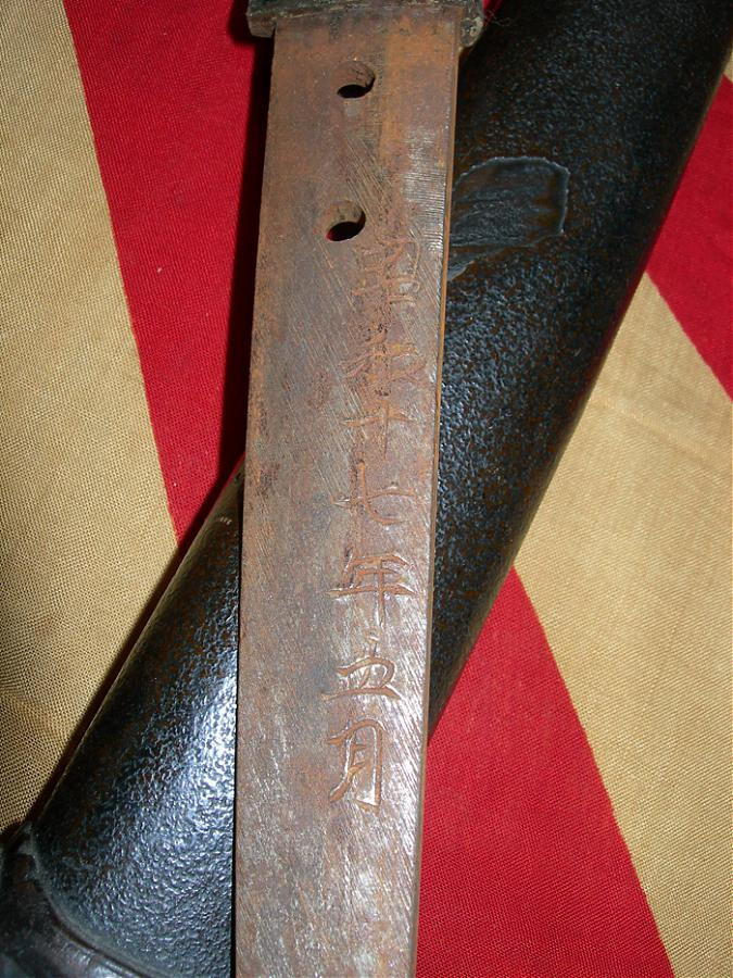

Kiipu Posted February 16, 2022 Report Posted February 16, 2022 Thanks Bruce. Below is the translation of the tang for your records. Obverse: 龍宇作 1301 = Ryū’u saku, serial number 1301. Reverse: 昭和十七年五月 = May 1942. I have revised the post above about observed Type 100 serial number ranges to include serial number 1301. Quote
Bruce Pennington Posted February 16, 2022 Report Posted February 16, 2022 On 2/15/2022 at 6:42 PM, Kiipu said: Starless Type 100s, serial number range 106 to 798, dated July 1941 to January 1942, serial number is upside-down. Starless Type 100s, serial number range 1129 to 1301, dated April 1942 to May 1942, normal serial number. ☆ [star] stamped Type 100s, serial number range 1525 to 2128, dated August 1942 to April 1943. Expand Ok, head's clear now. Quite an interesting observation. I appreciate that. Too systematic to be random fitter shop stamps. Adds weight to my feeling they are Army numbers, for some reason. Quote
