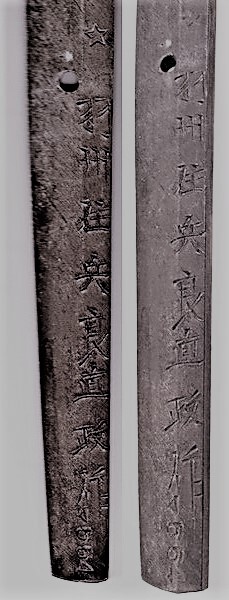

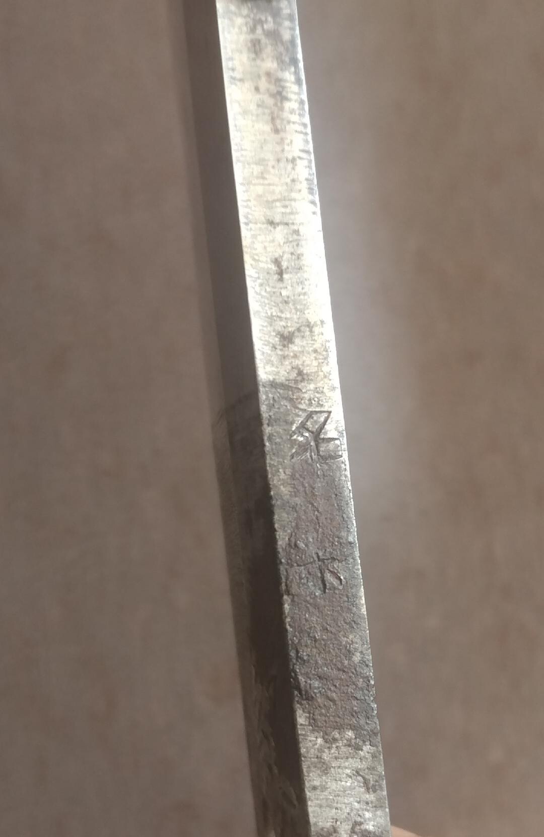

Kiipu Posted April 25, 2021 Report Posted April 25, 2021 On 4/25/2021 at 3:12 PM, Bruce Pennington said: A Miwa Kanetomo, June 1942 with a "Wa Ho 1" on the mune. Expand It is a Nagoya 名 inspection mark. 1 Quote
Bruce Pennington Posted April 25, 2021 Report Posted April 25, 2021 On 4/25/2021 at 3:19 PM, Kiipu said: It is a Nagoya 名 inspection mark. Expand Ok, I can see it. The bottom is left off or poorly struck and corroded. *sigh of relief!* Because the only other Wa marked blades were Masakazu from Fukushima, and Seki isn't anywhere near there. Thanks Thomas! Quote
Bruce Pennington Posted April 27, 2021 Report Posted April 27, 2021 Finished searching for RJT smiths of Gumma - no luck on numbered blades. Haven't tried the web yet. Quote

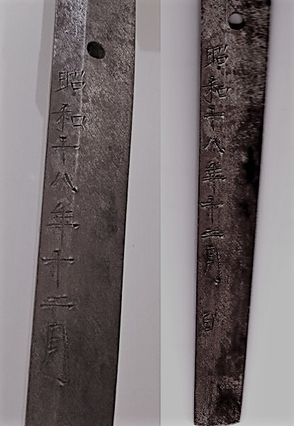

Bruce Pennington Posted April 27, 2021 Report Posted April 27, 2021 Alright! Got a hit searching Yamagata prefecture RJT smiths - a Dec 1943 Naohisa, star, "Ma" 664: That gives us 2 "MA", both from Yamagata: マ 431 Star Munemitsu No date マ 664 Star Naohisa Dec 1943 Quote
Bruce Pennington Posted April 27, 2021 Report Posted April 27, 2021 Another odd development No katakan, just the numbers on the nakago. Blade marked "34" was made one month later than the blade marked "95". Not sure what to think about that. Quote
george trotter Posted April 29, 2021 Author Report Posted April 29, 2021 On 4/27/2021 at 4:27 PM, Bruce Pennington said: Alright! Got a hit searching Yamagata prefecture RJT smiths - a Dec 1943 Naohisa, star, "Ma" 664: That gives us 2 "MA", both from Yamagata: マ 431 Star Munemitsu No date マ 664 Star Naohisa Dec 1943 Expand Might be my old eyes, but those pics seem to show Naomasa number Ma 554? (but yes, might also be 664? 1 Quote
Bruce Pennington Posted April 29, 2021 Report Posted April 29, 2021 You're right George! I've made the corrections to my files. Thanks! Quote
Kiipu Posted April 29, 2021 Report Posted April 29, 2021 On 4/27/2021 at 4:37 PM, Bruce Pennington said: Expand Make that three. A "star" stamped 源盛延 [Minamoto Morinobu] dated September 1942 with number 94. This sword also uses this number as a subassembly number. Note that the nakago mune is marked twice with ホホ. Star stamped blade I also found another Morinobu with a double marked ホホ nakago mune which is dated August 1942. This one does not seem to have a number stamped on the tang. Minamoto Morinobu Gendaito In Gunto Koshirae Maybe vajo could check his Morinobu to see what markings it has. (Minamoto) Morinobu Quote

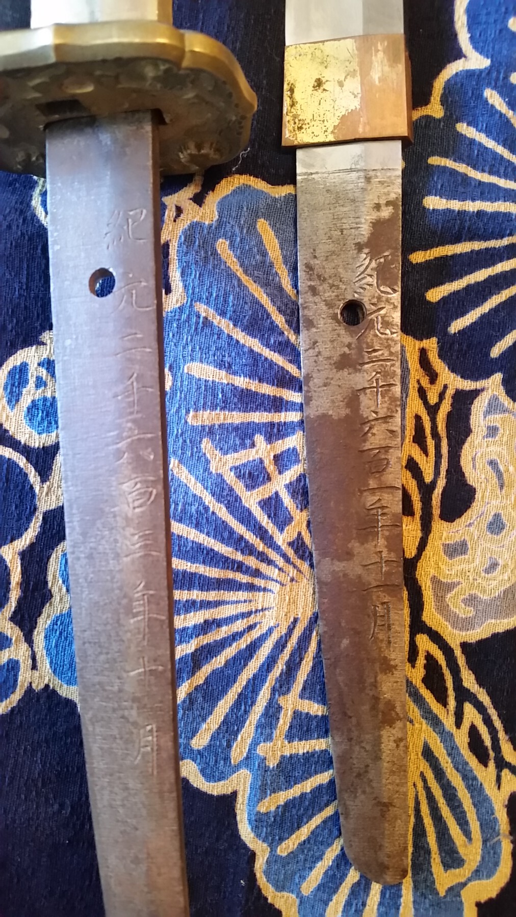

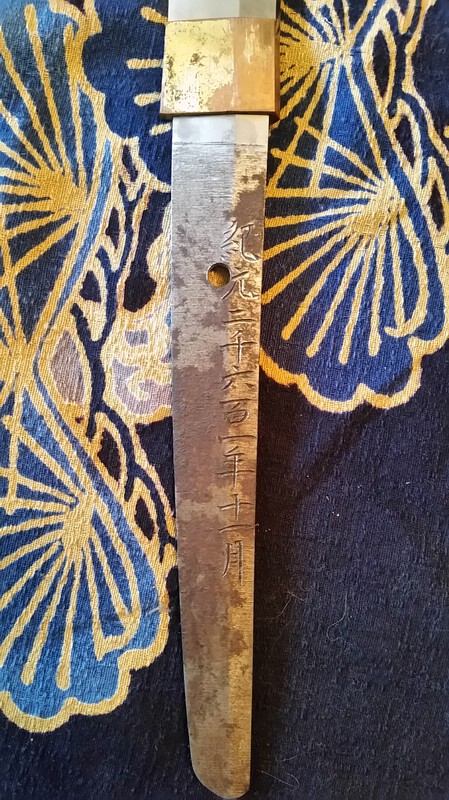

PNSSHOGUN Posted May 2, 2021 Report Posted May 2, 2021 A sword by RJT smith Muto Yukihiro, made in November 1941. No star stamp but Nagoya stamp on the Nakago Mune. Pics comparing an RJT sword by him made in 1943. Quote
