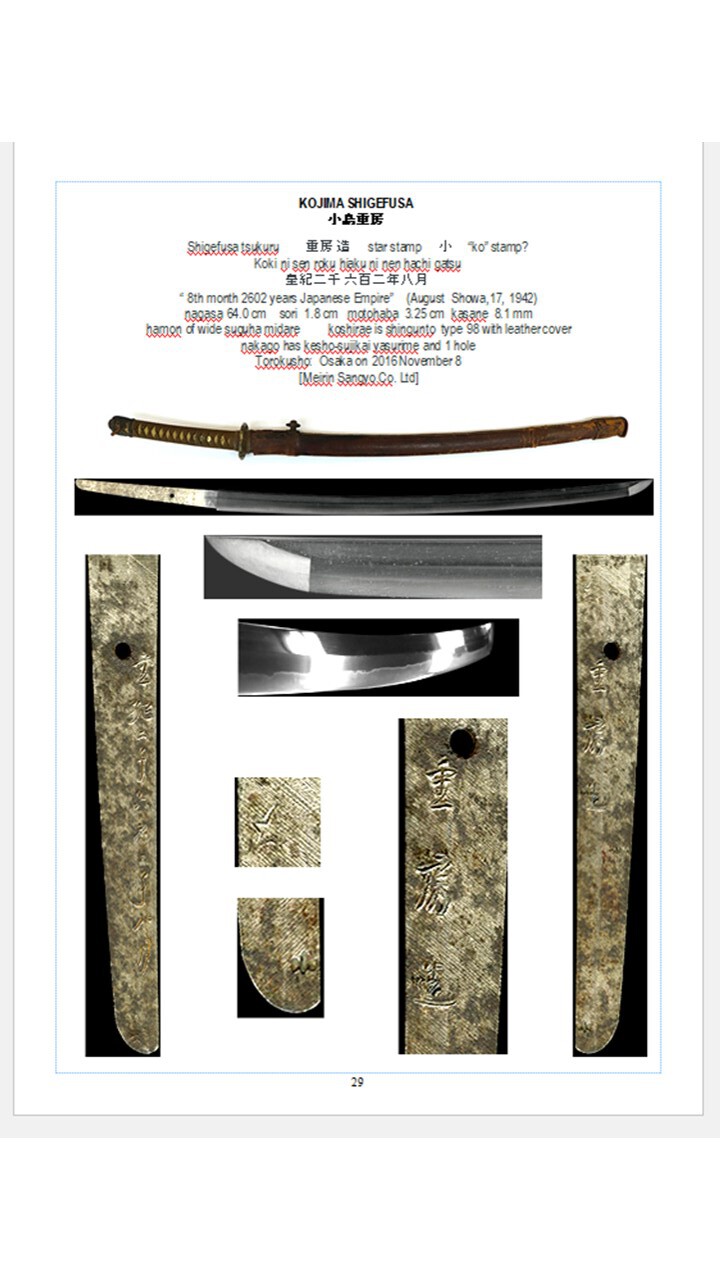

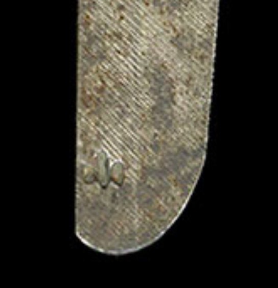

Bruce Pennington Posted April 24, 2021 Report Posted April 24, 2021 On 4/22/2021 at 10:49 PM, mecox said: Shigefusa star and "ko" Aug 1942. Expand Mal, On your first Shigefusa, page 29, I can't see the Ko stamp. Do you have a more clear shot of it? Also, what is that at the bottom of the nakago? Is it a hotstamp? Quote
Bruce Pennington Posted April 24, 2021 Report Posted April 24, 2021 On 4/23/2021 at 1:44 AM, mecox said: Thomas, that is interesting aspect, but Shigefusa was from Tokushima, he also set up his own forge there, and he was an appointed RJT at Osaka Arsenal and lived at Osaka for a while, and was ranked in exhibitions. You seem to be saying that this blade was made in Kokura and distributed out, and that he "finished" it. Very hard to believe that. However, I have not examined the blade...maybe I misread the stamps, also there was some discussion over the original post in 2011. cheers Mal Expand Mal, I'm going through my Star-stamped files and the first one I found with Star and Ko is of Hidehiro. Slough says his "last known residence" was Okawa city, Sakami. My google search says that is in Fukuoka. Assuming he did his work there, that's nowhere near Tokyo. So I'm thinking my "collecting, packaging, and shipping to Tokyo" might be the answer to these inspection marks. But wait! (idea just hit me) - these blades are from 1942. We don't see Osaka, Nagoya, or other arsenal stamps show up until 1943 and 1944. Maybe the inspectors that traveled all over the country carried Tokyo Arsenal inspector stamps because they were from Tokyo! Quote
Kiipu Posted April 24, 2021 Report Posted April 24, 2021 On 4/24/2021 at 2:21 AM, Bruce Pennington said: On your first Shigefusa, page 29, I can't see the Ko stamp. Do you have a more clear shot of it? Expand Here you go Bruce. 重房作 皇紀二千六百二年 Quote
Bruce Pennington Posted April 24, 2021 Report Posted April 24, 2021 On 4/24/2021 at 2:54 AM, Kiipu said: Here you go Bruce. 重房作 皇紀二千六百二年 Expand Thanks Thomas, that one shows the unusual stamp at the end of the nakago, but it doesn't show the "KO" stamp. I don't see it anyway. On the topic of weird stamps - what the heck?: Quote
mecox Posted April 24, 2021 Report Posted April 24, 2021 Bruce, my draft had "ko?" but I will change to unidentified as I dont know. Quote

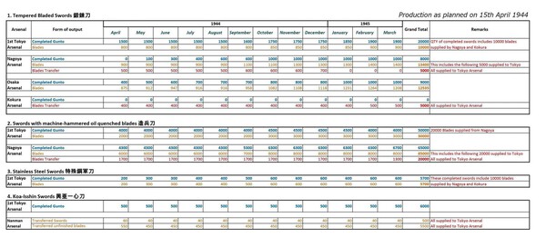

Bruce Pennington Posted April 25, 2021 Report Posted April 25, 2021 This 1944 production chart (and I assume other years had similar stats) showed that Nagoya Arsenal (along with SMR and Nanman) transfered blades to Tokyo 1st. This is why I have never been bothered by seeing the mix of stamps. Quote

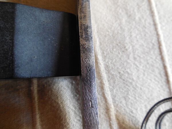

Bruce Pennington Posted April 25, 2021 Report Posted April 25, 2021 Ok, I know - too much stuff all at once! But this one blew my socks off. A Miwa Kanetomo, June 1942 with a "Wa Ho 1" on the mune. It doesn't seem to have a star, but he was RJT at some point in the war. Best I could find on his location was "Seki". Quote
