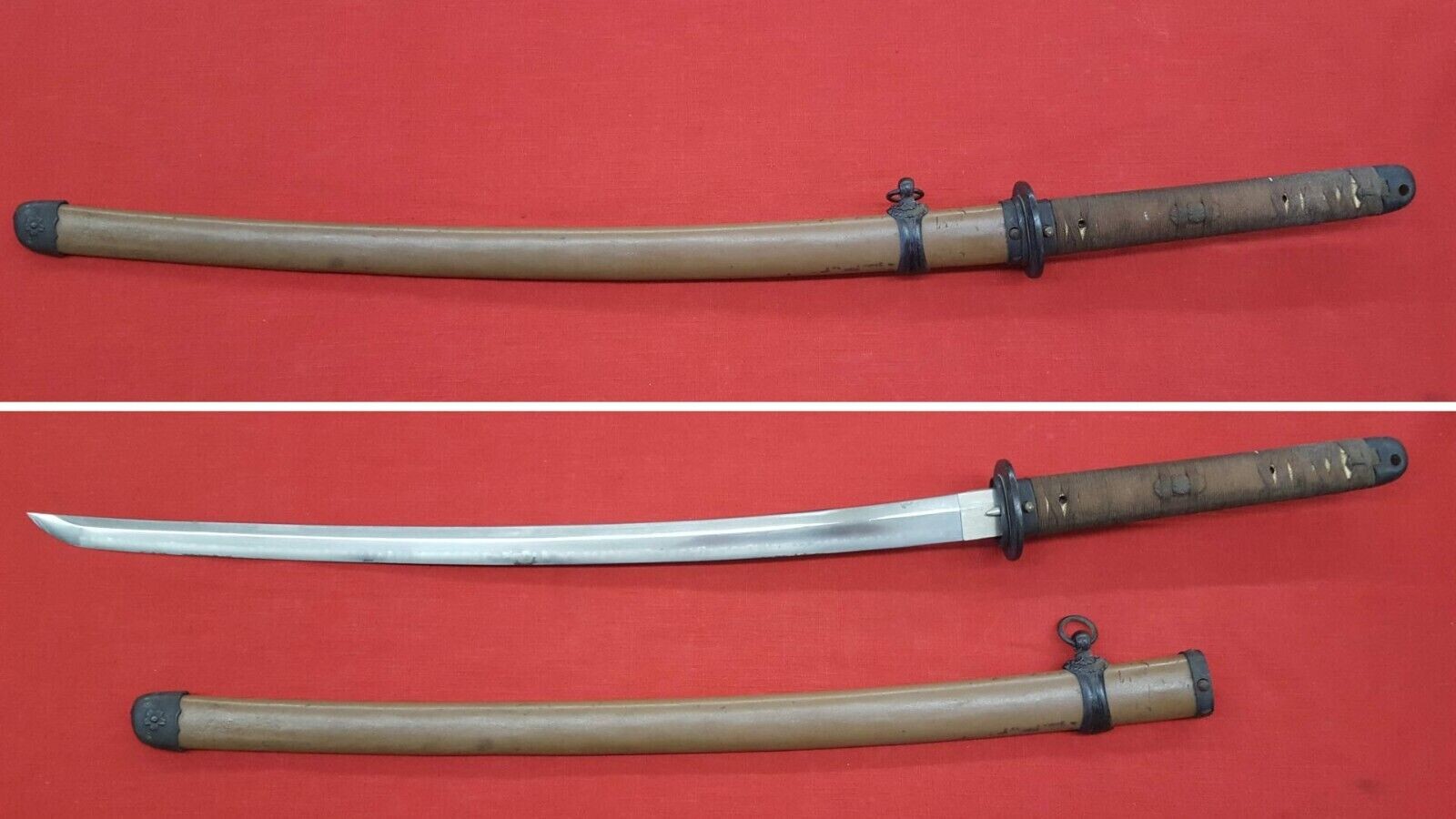

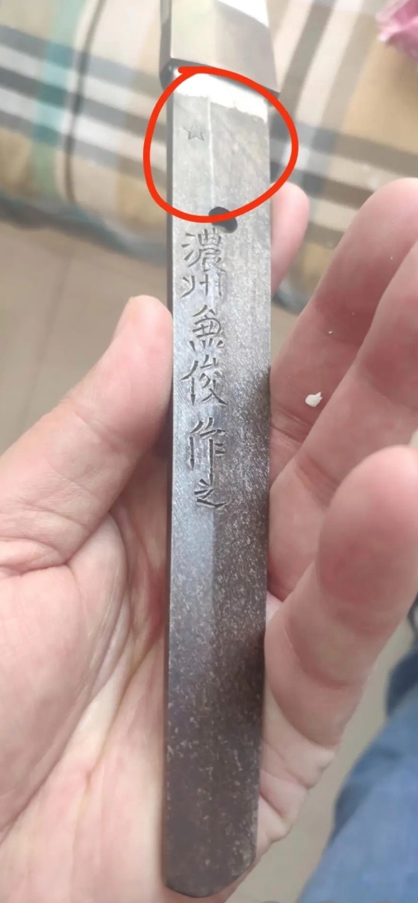

John C Posted February 12, 2023 Report Posted February 12, 2023 What does the blade look like? Does it look like a typical water quenched blade using tameshigiri or does it look like a well made oil quenched blade? Could say a lot about whether or not the star is legit. John C. p.s. probably just the camera angle, but the star looks a bit small and chunky relative to the size of the mekugi-ana. Quote
Bruce Pennington Posted February 12, 2023 Report Posted February 12, 2023 10 hours ago, BANGBANGSAN said: I doubt this one starts with the star. Please compare the mei with the one in Slough's book, same smith same year, and month, but clearly with no star. The one with the star is in China, which has many guntos and bayonets modified, just to sale higher prices. By Nick " 1942 July: The Army called upon each prefecture to solicit volunteers through these unions, who may be interested in getting into sword production. These messages from the military originated in the First Tokyo Army Arsenal and got passed onto the union through the Trade and Industry Dept. of the Prefectural government, and then from the union to its member smiths." https://www.warrelics.eu/forum/Japanese-militaria/rikugun-jumei-tosho-rjt-star-stamped-blades-documentation-789067-6/ Post#54 From Ohmura: In order to increase the production of military swords for officers, the Army began to solicit swords from around March 17 through each prefectural office, and each prefecture also solicited blacksmithing unions, hardware associations, or swordsmiths in each region who wished to manufacture and deliver swords to the military. A couple of thoughts, Trystan. First, let me say it is certainly possible the star was placed there later than June of '41. But simply because Slough shows a blade in the same month and year without one doesn't disprove the idea of the star being there in June '41. As we well know, many RJT smiths sold swords on the civil market while they were working for the Army. As to the Komiya and Ohmura quotes, the discussion was concerning increasing sword production and recruiting potential swordsmiths. Nick had started the paragraph in 1939 and 1940. In '40 each prefecture had their own trade unions, and he discussed how many smiths were just making kitchen knives. So by July '42, the Army made a push to recruit those smiths, using the trade unions, into swordmaking. None of the discussion refered to the establishment date of the RJT program. Quote

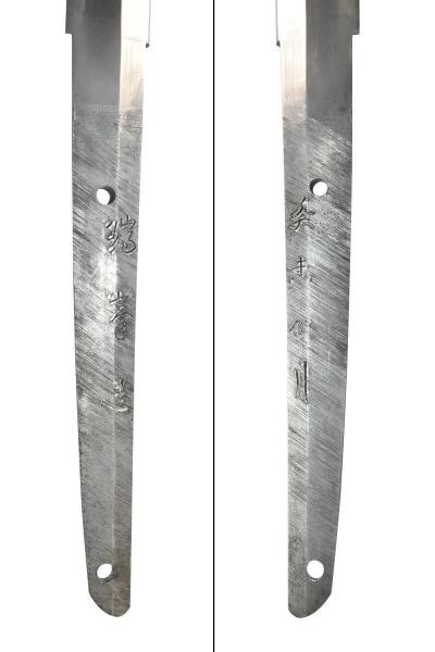

BANGBANGSAN Posted February 12, 2023 Report Posted February 12, 2023 昭和16(1941)年8月,昭久 Akihisa ,no star,in Rinji mount.New on the market. Quote
vajo Posted February 12, 2023 Report Posted February 12, 2023 something looks wrong in my eyes.. Tachi mei vs Katana mei? If it was made for a gunto it should have Tachi mei. But this has Katana mei. btw the nakago looks cleaned. The pictures are not good enough to say anything about the blade. Typical Showa22 sword. Signature looks good. --------------------------- to compare: 1943 late war 1944 2 Quote

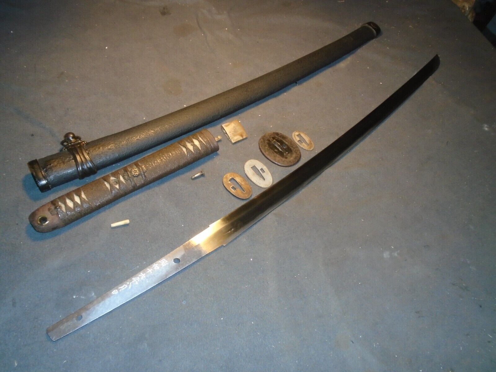

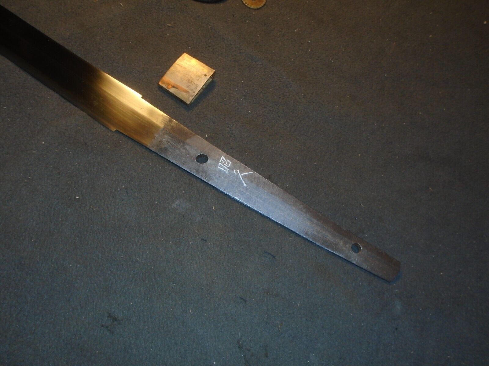

Bruce Pennington Posted February 16, 2023 Report Posted February 16, 2023 Another August, 1943 Zuiho. Note the cloth sarute: Quote
