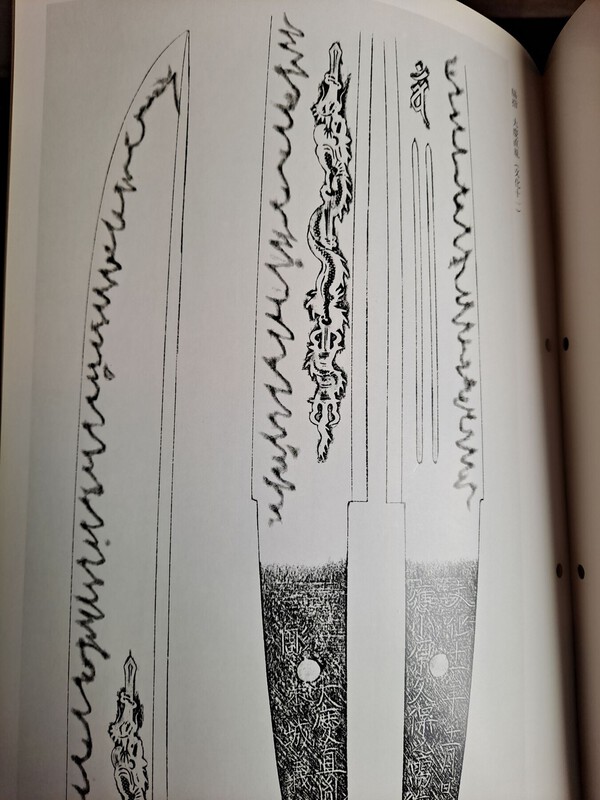

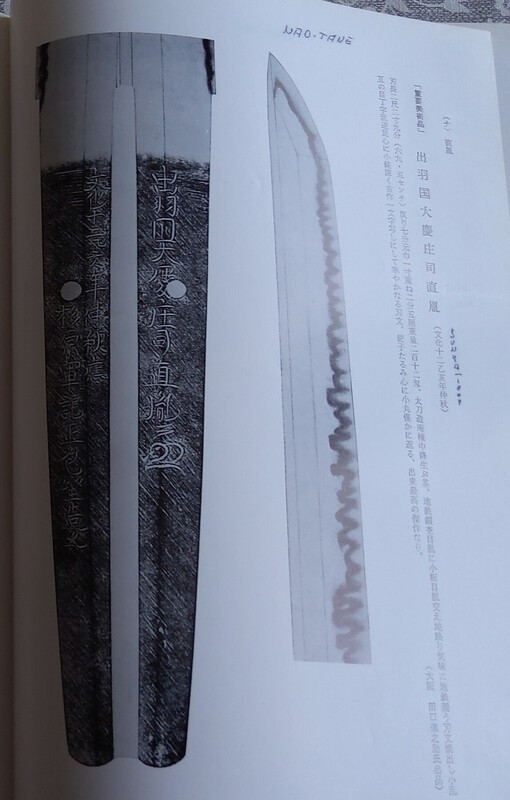

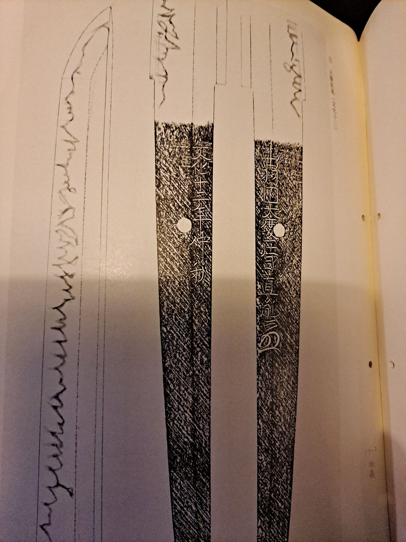

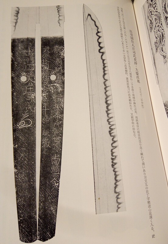

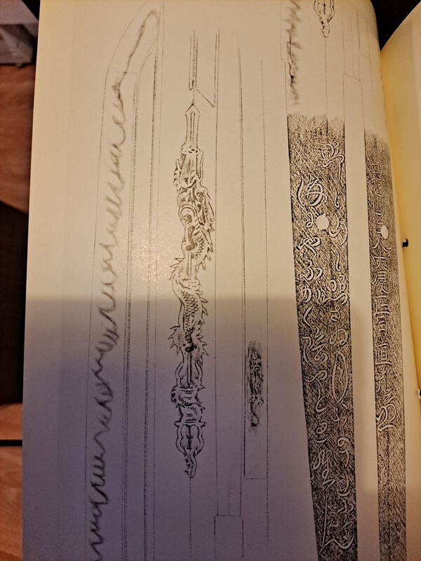

Sometimes you see a Choji-midare with higher elements...(see the picture from the shin shinto taikan)....but this is not the O-Choji-midare from the Ichimonji school.

Hi Didier MARKUS translate the NIHON SHINSHINTO SHI...THE EXAMPLE SHOWN is imo not an ICHIMONJI HAMON..
