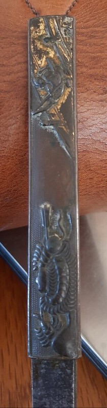

I should use this opportunity, Florian and other knowledgeable kozuka guys out there, to show a kozuka that I am in the process of getting. Pics to follow. I very much liked the extended script on the tang, which I imagine to be the smith's name plus perhaps a poem or something. But that's all I can think of. Please explain what's going on there, if you all will be so kind! Johan

The knife is upside down, but the writing is
金華於濃州長良川邊藤原清長
Kinka oite Nōshū Nagaragawa-hotori Fujiwara Kiyonaga
It means Fujiwara Kiyonaga, from the Nagaragawa region of the Province of Nōshu near Mt. Kinka forged this.
Note that the general consensus is that most signatures on these kogatana are not authentic signatures. They are said to be mostly fake signatures (or, as we say, an homage to the smith mentioned). This is almost certainly the case with the Kanemoto signature above.

Thank you, Brian. I would lastly ask the assistance of Steve M or anyone who is able to come in, to help identify the design on the kozuka pictured in post #8. Some kind of long-bodied animal (dragon?) has been wounded by an arrow, but I can't make out the topmost gold-plated picture (probably the archer/samurai?). I do not unfortunately have the kozuka in hand yet, so no better picture. Please help. Johan
Stephen & Steve, thank you. I am a person who is not really satisfied with merely getting people's opinions on eg. kozuka, but like to puzzle things out myself too. I became stuck with researching these three kozuka, and therefore had to ask for assistance, which you all kindly gave. Regarding the centipede kozuka, directly after Stephen replied with his suggestion, I Googled that story and became convinced that he was right. Then Steve confirmed it. Thank you, guys - much obliged! I do think at this stage that of the three kozuka in this thread, the centipede one is the more interesting (combined with its blade, of course). Of these three kozuka, (1-gourds, 2-commander's staff and 3-centipede), can you perhaps tell which one may be the oldest?
