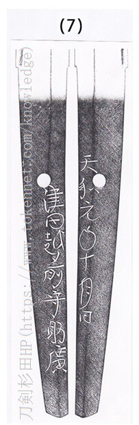

lancashireparade Posted March 26, 2021 Author Report Posted March 26, 2021 Wow, these are really great responses and I have my homework cut out for me. I will read with interest! Earlier in this thread Geraint and Mark C asked me to provide some measurements. I'm using the measuring rules from this page: Japanese SWORD MEASUREMENT (japaneseswordindex.com) . According to this, this torii sori shoto has the following: Nakago: 5.5 " Nagasa: 21" Kissaki 1 1/16" Also, I have been looking for images of a punched mekugi ana, because I am wondering how to tell if mine is drilled or punched as per Mark C Quote
