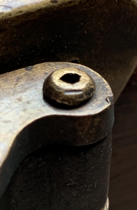

Arthur G Posted March 30, 2021 Report Posted March 30, 2021 One part I'm struggling with making right now is the pan cover pin. I'm not quite sure how they were made. My first attempt just now was a failure. If anyone has super closeups of one or insights, I'd greatly appreciate. My first attempt was using a brass rod that I had to file down considerably but leaving extra material for the head. I then drilled all the way through to hollow it out and the hole was way off center when it came out the other side. Were these completely hollow? And if so, were they made out of a solid rod, or out of a rolled sheet? Thanks for any insights in advance guys! Quote
Bugyotsuji Posted March 30, 2021 Report Posted March 30, 2021 Yes, they were completely hollow, a tube with a lipped top, and with horizontal holes across the bottom. You should be able to insert a wire down from the top, to support a rain protector, somewhat like a cocktail umbrella. 1 Quote
Arthur G Posted March 30, 2021 Report Posted March 30, 2021 Fantastic, that's what I thought. Have a pile of old guns here I'm holding onto/restoring for a friend, and none of them have pins for me to look at. I'm very happy with the overall shape of the first one I made, but had a severe screw up with drilling it out and realized "huh, they probably didn't do it this way". So, is it a rolled sheet or a drilled out rod? Got any clear photos I could have a look at? The way to really tell I think would be to look at the underside of the head, and see if it's flush or concave. Quote
Bugyotsuji Posted March 30, 2021 Report Posted March 30, 2021 Without pulling my guns apart I cannot answer that immediately, Arthur, but there does seem to be some variety among them. My gunsmith drills down through brass screws, (I believe), though I have not seen him actually doing it. I can recognize work by him at a glance, though. In fact I have adjusted the shape of the 'mushroom' at the top of his work in the past to make it flatter, as I find it too prominent and square-shouldered. The first 6-Monme' Hinawa-ju I bought was missing the pin. When I mentioned it, the Banto immediately and casually reached over and pulled out one from another gun's pan lid/cover. 1 Quote
Bugyotsuji Posted March 30, 2021 Report Posted March 30, 2021 This is the bottom of the pin on my Kumamoto Castle 7-Monmé long gun. Dated 1847. Pin wired in place. Really tough to get this shot but I think it shows evidence of a rolled sheet. (with the top perhaps furled in some way?) 1 Quote
Arthur G Posted March 30, 2021 Report Posted March 30, 2021 Dear lord it is a rolled sheet, I was doing this completely wrong!!! Ok, I can see exactly how they made this now, thanks a bunch piers!!! 1 Quote
Arthur G Posted March 30, 2021 Report Posted March 30, 2021 It looks to me like there is a seam on the head as well, so they probably rolled it first, inserted it into a wooden or metal plate with a hole of the same diamter drilled out, mashed it with a hammer, then drilled it out a little at the top to clear out the excess material. You can see looking at it that it looks like it was done with a square bit Japanese hand drill. A lot of the parts on these guns were not made at all like people think. Some things were cast, some weren't, and it's really dependent on the style. For example, it seems like none of the parts on Kishu guns were cast. The square shape that people notice about them is a biproduct of the manufacturing method. How they were done was they cast a tapered plate out of brass, and cut everything out of that. How do I know this? If you hold up a lockplate, hibasami, outer spring, etc, they're all of the same thickness and taper. If you look on the edges there are often still sawmarks that they didn't completely hide, especially on the inner side of the outer springs. I can't really speak with any authority on other regional manufacturing methods currently though. Aspects of these are far less complex than people think, and some things are far more. I'm finding different brass mixes for different parts on guns, and it is consistent throughout. Very intentional. Another thing I haven't seen others comment on is the use of silver solder. I assumed it was anachronistic to use that, but after looking over lots of different locks I've started finding it more and more. Talking about Kishu specifically, the way the head of the hibasami is attached is through silver soldering. Quote

Arthur G Posted March 30, 2021 Report Posted March 30, 2021 Just attempted making the roll pin from scratch, and got it on my second try! Not perfect as the seam twists along the length of it rather than being totally straight, so room to improve there, but this is definitely how they did it. Quote
Arthur G Posted March 31, 2021 Report Posted March 31, 2021 How's this for a first attempt? I have room to improve here. The hole for the retaining leather is too high up sadly, and I wasn't able to get the seam on the roll pin straight (hand forged it from a small sheet of brass). I tried to imitate the flaws in the hole at the top that seem to be prevalent on originals. Still need to do a final polish and patinate it. 1 Quote
Bugyotsuji Posted March 31, 2021 Report Posted March 31, 2021 Looks very good Arthur. The horizontal holes are often high like that. 1 Quote
