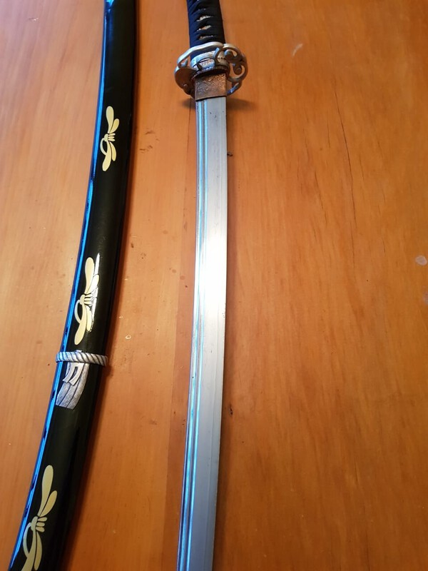

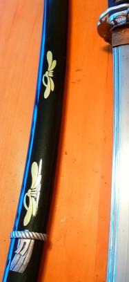

I would like to know if this decoration on my sword's saya is indeed a flower,
as a friend reckoned it to be a dragonfly. The blade is circa 1680,
but I don't know if the saya can be that old.
Perhaps members know it as a common decoration
and can tell me what it represents.FlowerPicture.jpg.5acfc3ed9fa5423a9b4a46ac9f95072a.jpg
There are five of them in total. I can just feel the slightly
raised design as I move over it with a finger.
It's not metal, I don't think. Please advise. Johan.

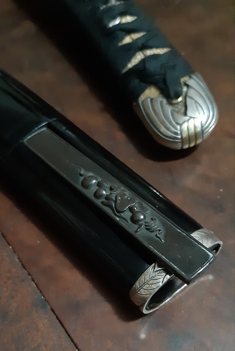

John, Chris & Brian, thank you. Perhaps more suggestions as to the "flowers" will come in, as it seems a positive ID has not yet been made. While the prayer papers have been mentioned, I might as well post pics of the kashira and kojiri as well. Any comments you have on them will be appreciated. This is great, to at last be communicating with folks with shared nihonto interests! Johan
Jean and Stephen have cast a gloomy shadow over the saya with its makie, prayer papers and other parts of the koshirae. The thing is, rather the truth be known than to live in a fool's paradise!  So bring it on, I say. I had believed the embellishments to be silver, and of an appropriate age suiting the katana. I must say, the saya lacquerwork is truly beautiful and I had wondered how such an old saya could have remained so neat. The previous owner merely said he had always thought the sword and its mounting had been made at the same time. The tsuba is silver, according to a friend dealing in silver and gold, and I see it is signed as well. I'll put up some more pics. (And no hard feelings from my side, Stephen and Jean!) Johan

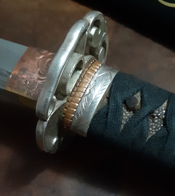

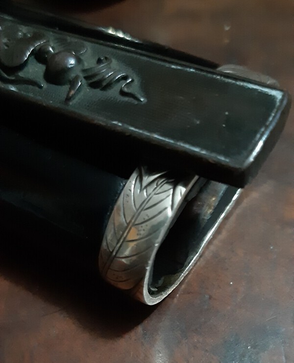

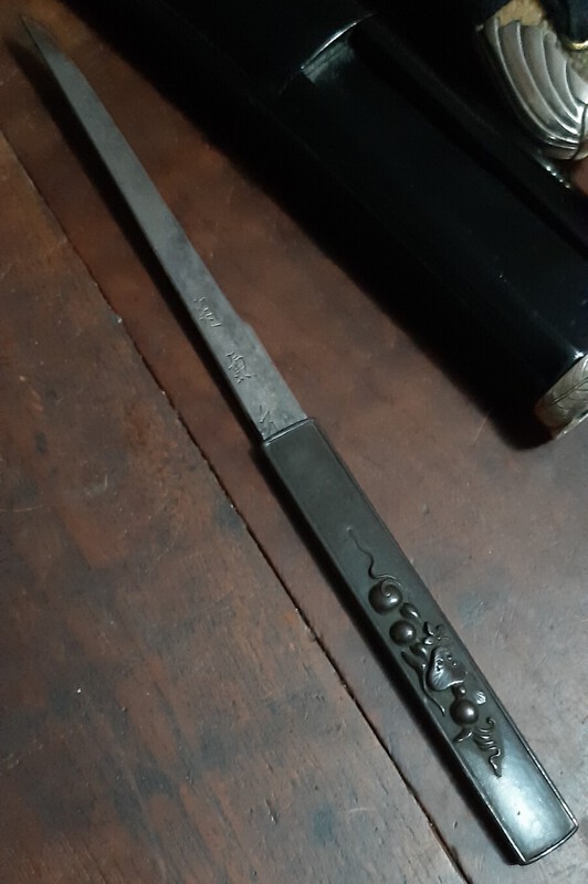

The kozuka looks to be very good. You need to post better pics of that.
The other fittings appear to me to be modern....like yesterday. And not Japanese. Maybe made by an amateur restorer/jeweller.

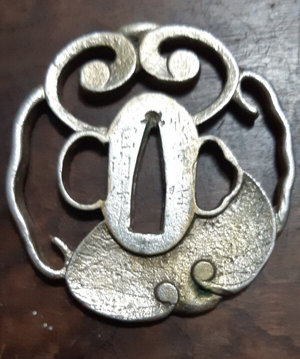

The tsuba may be real and old, but has been buffed "in it's moer" and is pretty much destroyed. The wrap is modern and incorrect.  Menuki appear to be modern too.
Blade is a SA restoration...Adrian or Gus way back? Sorry to be blunt. But the blade is the most important part of this package, so let's see the tang?
Brian, I'll put up some pics of the two kozukas and one kogai I have, soon. Concerning the tsuba, dis ook seker al manier waarop 'n mens 'n boggerop kan beskryf! Too bad one cannot just turn back the time and undo the damage.  Concerning the blade, as I said the blade is being discussed in the Nihonto section under "Lucky Dragon on Tang". I apologize once again if I should have kept to one board.
But what about the saya itself and that wonderful lacquer job it has? Any possibility that it had been with the blade all along and has been spared the ravages besides the fittings which then seems to be later additions?

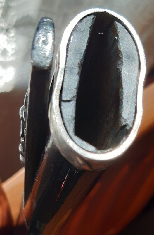

Went and looked at the blade...happy to find the real deal. Like i said ther consider a shirasaya. My second look at the saya (crawfish) im leaning its new as well. Pic down its throat should tell.

the photos do not allow to read the signature of the TSUBA correctly, but it may read ECHIZEN KINAI. If so, it could well be a genuine TSUBA which was silver coated in the recent past to match the other parts of the mounting. That may indeed be the work of an amateur as Brian suggested. Except for precious metals, all other metals usually were patinated. Silver can appear as bright metal if the design required it, e.g. to represent the moon.
The lacquer work cannot be judged by photos, I am afraid. Modern SAYA usually have printed on decoration which looks very even in magnification. Traditional lacquerwork looks different. As Stephen suggested, a look into the KOI-GUCHI might reveal more (to an expert who can compare).

I should say that the criticism vs. your KOSHIRAE is just a 'technical' or artistic one, and you should not feel bad about us pointing out weak features of it. This should not keep you from liking it, but as most of us, you will be in a learning process which will change your view the more you see and compare.

Jean and Stephen and others, you have kindly advised that I add a pic of the saya throat. Please see below. I'd also like to put a pic or two of two utility knives I have. They seem of real interest. Any comment will be greatly appreciated.  Johansamswaardthroat.thumb.jpg.e9f4eedc453e77f273017eacc7cd8f88.jpg
