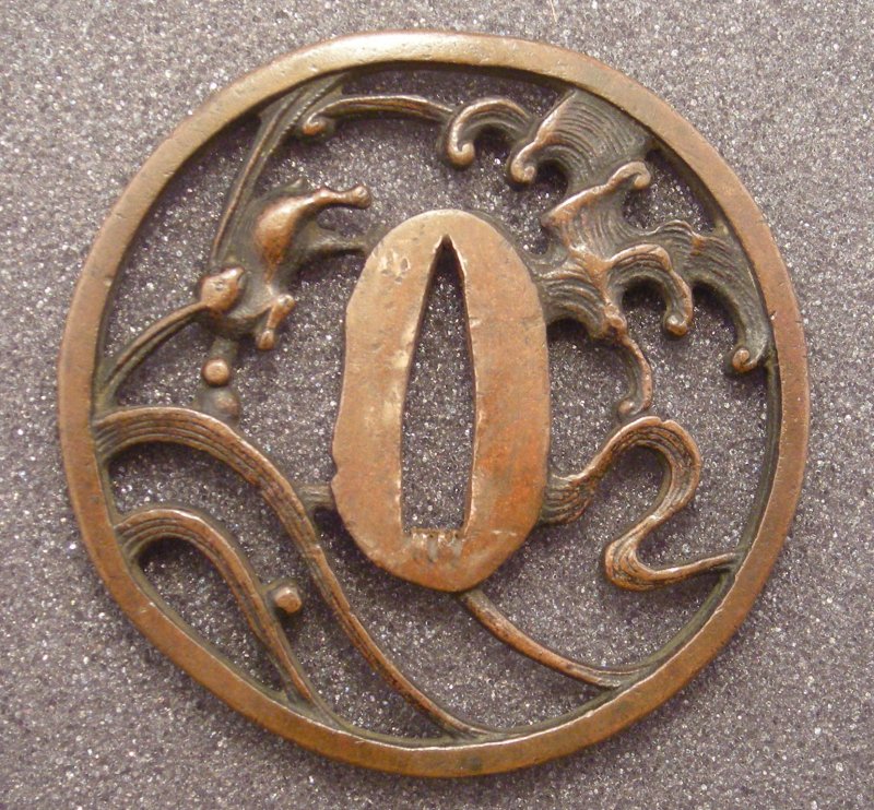

shan Posted December 23, 2008 Report Posted December 23, 2008 Here is a tsuba that came with the Koshirae and Blade i have asked questions about. I believe it to be copper. Its as you can see of a rabbit and waves and i would like to know the story or Tale this might relate to, as well as a period for the Tsuba and school from the poeple who know. Does this fit with the Koshirae or would it be an add on in your opinions? This is the last of my final 3 questions. I am then going to cease to post items on the forum. again i will not respond unless asked to specifically. regards shan Quote
Bungo Posted December 23, 2008 Report Posted December 23, 2008 take it with a lump of salt........ bunny jumping over waves is a fertility symbol. Urban sword myth ? milt Quote
Brian Posted December 23, 2008 Report Posted December 23, 2008 Shan, I haven't had a chance to look yet, but at the top of General Discussion there is a post with links to all sorts of good pdf artices, and one of those is a free download of "Legends in Japanese Art" by Joly. I would check that out for any mention of a rabbit and waves. I am sure it must relate to something. Will look more tomorrow. Brian Quote
reinhard Posted December 24, 2008 Report Posted December 24, 2008 Bungo said: bunny jumping over waves is a fertility symbol. It was invented by famous philosopher and philantropist Mr.Hugh Hefner. reinhard Quote
Bugyotsuji Posted December 24, 2008 Report Posted December 24, 2008 Check out the famous story of Inaba no Hakuto. (White rabbit of Inaba) He was quick enough to use sharks (or crocs) as stepping stones, but he is probably checking behind to see if they are after him. Quote
Nobody Posted December 24, 2008 Report Posted December 24, 2008 Look up “Nami Usagi” (波うさぎ). There is a legend about the Moon, a hare, and waves. That is also a theme of Noh play Chikubu-shima (竹生島), maybe. Quote
Patrick Hastings Posted December 24, 2008 Report Posted December 24, 2008 The motif shows the rabbit leaping about the waves during his crossing. He jumps from snouts and backs of sharks or alligators to cross the water. They are almost always unseen in the motif at least in sword fittings. The Rabbit lies to the predators promising them a reward if they will help him get across the waves and back to shore. They let him start crossing then try to eat him. He makes it across jumping from mouth to mouth. In the end he loses all his fur and makes it to the other side where he is found and cared for by royalty. There is more to it and many versions(in english), but that is the jist of it from all the versions I have read. patrick Quote
Bungo Posted December 24, 2008 Report Posted December 24, 2008 Felix, Check out Joly's Legendsin Japanese Art page 195. " It is said that the female conceives by running on the waves on the 18th day of the 8th moon, if the sky is clear, or by ...( some foreplay which I don't think the censor will appreciate, so i won't even try ). Or............. for those more " learned ", as pointed out by Nobody san, there's this totally dull entry that involved the Bonze of kencho-ji, Jikyu Zosu, visiting Chikubujima in Omi and had this moment..........alluding to some Chinese poem of old about tree, rabbit running on waves, holy lights and beginning of time and such. See Afu Quarterly ( Summer issue ) page 78-79. milt Quote
