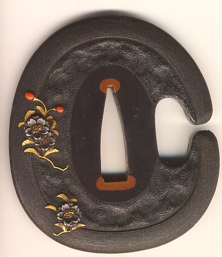

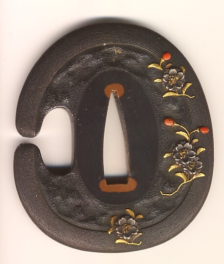

This is an early 19th century piece by Horie Okinari. It features coral 'berries' and a malachite inlay representing a mossy rock.
The use of gemstones, glass, ivory, lacquer and other such non-metallic materials in tosugu decoration isn't very common but we do occasionally see examples. This suggests that while not unknown it wasn't, evidently, ever a hugely popular feature.
Curiously, though, the use of enamels (the Hirata school output being most notable) was highly appreciated. And Murakami Jochiku is celebrated for his creative use of mother of pearly in his compositions.
The Tsuba is copied from the "Tosogu, Treasures of the Samurai" catalogue by Graham Gemmell, one of my early mentors in this field.
