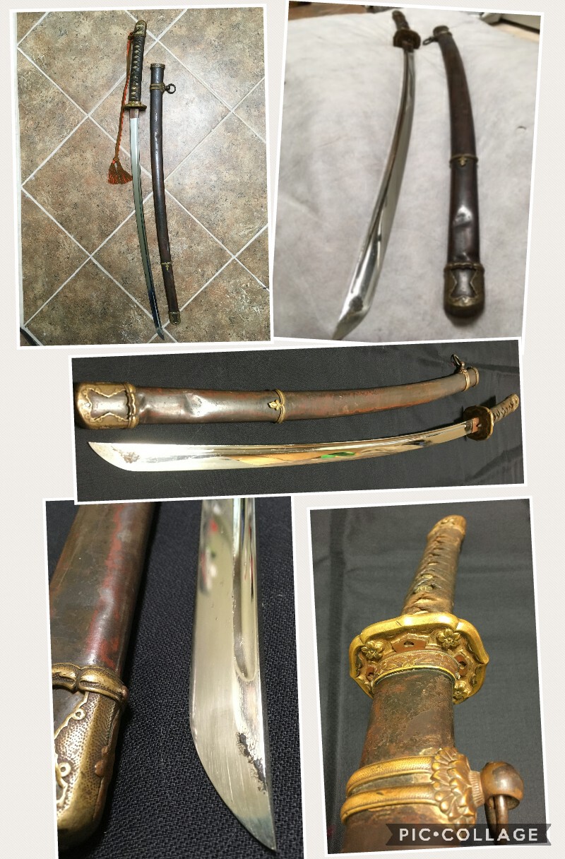

ribendao Posted March 9, 2021 Report Posted March 9, 2021 Just found this online and ordered it. Am I safe to assume its a lightweight gunto like from page 160 from Dawson's book? Or is it possibly some sort of replica? Would love to hear your opinions. Thanks 2 Quote
Shamsy Posted March 10, 2021 Report Posted March 10, 2021 Looks like a LWG but it is missing the habaki sadly. Condition is not great, bit these are pretty darn rare so better to have an example and maybe upgrade in the future. I don't mean that in any derogatory way, I do the same with my own collecting. Quote
ribendao Posted March 10, 2021 Author Report Posted March 10, 2021 Some of the other examples in Dawson's book (like on pg. 156) are also missing the habaki. The type 19 dress swords are also without habaki I think, so it makes sense that this would also not have one, right? My main concern was that someone took a type 19 dress sword blade and put it in a type 98 mountings. But the proportions look small/correct and the ito wrap looks professional enough I suppose. 2 Quote
PNSSHOGUN Posted March 10, 2021 Report Posted March 10, 2021 It has a dress sword blade without habaki. The mounts are very early Type 94 pattern, missing the 2nd hanger, great find. 1 Quote
Shamsy Posted March 10, 2021 Report Posted March 10, 2021 On 3/10/2021 at 1:50 AM, ribendao said: Some of the other examples in Dawson's book (like on pg. 156) are also missing the habaki. The type 19 dress swords are also without habaki I think, so it makes sense that this would also not have one, right? My main concern was that someone took a type 19 dress sword blade and put it in a type 98 mountings. But the proportions look small/correct and the ito wrap looks professional enough I suppose. Expand If other examples don't have the habaki, then that's a good indicator the sword is correct. I made an assumption they would have a habaki and I think the example Neil used to own did have a habaki? I'll see if I can find the photo before he sees this. The blade looks fine, I don't think there are people bodging up LWG. If you remove the tsuka you could easily check and see if everything lines up and has not been tampered with. The dress swords have screw fittings I believe so that should be obvious to see? None of this is my area of experience, so I'll leave it for others with more knowledge to continue contributing. Quote
PNSSHOGUN Posted March 10, 2021 Report Posted March 10, 2021 From what I can understand both types of dress blade with/without habaki are correct. Considering how early the mounts look the Habaki version may have come later on. 3 Quote

Ontario_Archaeology Posted March 10, 2021 Report Posted March 10, 2021 Here are a few pictures of my lightweight.. 3 Quote
Ontario_Archaeology Posted March 10, 2021 Report Posted March 10, 2021 A difference I see is the first post has a thick tsuba where as the other two do not. Quote

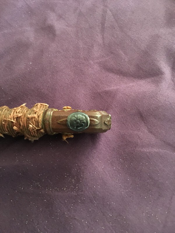

ribendao Posted March 14, 2021 Author Report Posted March 14, 2021 Received my LWG quicker than expected. It had a clan mon on it I’m hoping someone can identify for me. Picture below. Quote

ribendao Posted March 15, 2021 Author Report Posted March 15, 2021 I measured the blade and it appeared to be exactly 0.9 inches. I attempted to poke out the menuki but couldn’t get it to budge. One side of the menuki Ana is covered by the ito wrap. I was able to move it a little but the ito wrap is so tight and fragile I would rather not futz with it for now. ps. Any one know what clan the mon is? 1 Quote
Kiipu Posted March 15, 2021 Report Posted March 15, 2021 On 3/15/2021 at 12:12 AM, ribendao said: ps. Any one know what clan the mon is? Expand Thanks for the prompt reply. In regards to the mon, post the picture in the thread below. Help Identity Our Mons. Quote
