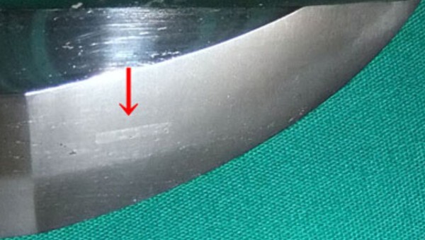

Novalame Posted March 8, 2021 Author Report Posted March 8, 2021 Hi, Apologies for the delay. My camera decided that it was about time to give up the ghost, so I only have the one. I'll try to get a shot of the whole katana when I can. I've taken a photo, damage is located towards the middle of the blade: two smaller hagire either side and one big one. By best guess is that either someone's tried cutting something than they shouldn't have (possible as it was brought back by a Second World War Veteran) or that it's old battle damage. It's also scuffed and somewhat rusted. It is an older sword, Koto, likely Muromachi or so I've been told and is signed "Kanefusa". Thank you again for all your replies and guidance. Quote
b.hennick Posted March 8, 2021 Report Posted March 8, 2021 I see no way to fix that. You could have it made into a tanto or wakizashi. You could have the original mei inlaid in to the new tang. Or, you could leave it as is and enjoy it for what it is/was. Or you could have a polisher open a window so that you could appreciate the hada and hamon. Quote
JH Lee Posted March 8, 2021 Report Posted March 8, 2021 Oh, yikes. No, there's no way to fix that except maybe cosmetically with a "patch" blended in. But its life as a serviceable weapon is over, unless it is shortened o-suriage. Quote

DoTanuki yokai Posted March 9, 2021 Report Posted March 9, 2021 Ofc this can be weld together but that would destroy the temper. It can be a nice study piece after polish but lost most of its value for collectors. Quote

DoTanuki yokai Posted March 9, 2021 Report Posted March 9, 2021 I think i once saw a blade where something like this was tried (?) and in the end it would have looked better with only the hagire. Im not sure what they tried on this blade or if the damage have something to do with this activity but maybe someone saw something like this before ? The hagire is still visible. Quote
