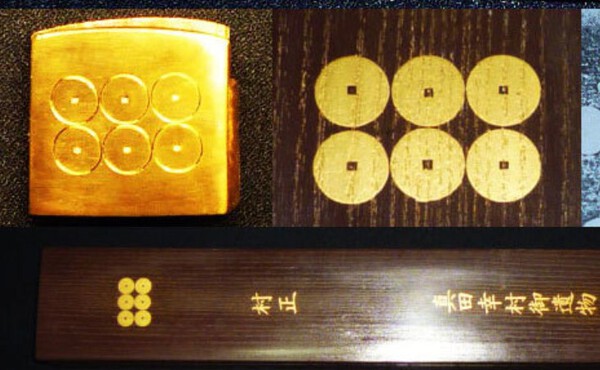

Bruce Pennington Posted February 28, 2021 Report Posted February 28, 2021 Anyone know that mon on the habaki? Quote
Toryu2020 Posted February 28, 2021 Report Posted February 28, 2021 真田六文銭 Rokumonsen - Six mon coins, usually associated with the Sanada family. -t 2 Quote
Bruce Pennington Posted February 28, 2021 Report Posted February 28, 2021 23 minutes ago, Toryu2020 said: Six mon coins, Thanks Thomas! Quote

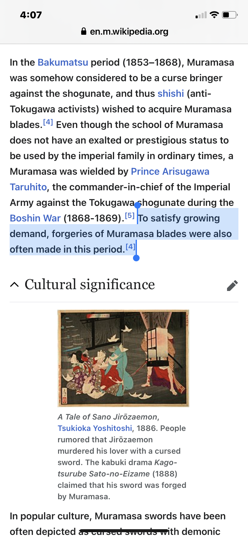

Karusk Posted March 10, 2021 Report Posted March 10, 2021 Alot of muramasa gimei were done in the bakumatsu period. Ive seen a couple obvious gimei murmasa go for a couple thousand dollars on ebay. One the seller was even quite clear about the fact that it was gimei. It sold for around 4k. So someone thought it was worthy of collecting. I did. Ive seen it said a few times here. Its worth what someone will pay for it. Obvious gimei? Yeah. Worthless? No. Its worth 300k yen to someone. That koshirae is probably worth a chunk of yen too. for 3k in that koshirae i think they hit around the actual value of the blade. These gimei were more often done to supply a demand for muramasa blades than to defraud someone in the modern market. I personally think that would be an exceptional talking point. Any opinions on their worthiness to collect? https://www.ebay.com/itm/AY-82-Very-old-Blade-SAGAMINO-KUNI-SADAMUNE-sign-NANBOKUCHYOU-age/324282305398#vi__app-cvip-panel Here is a very old gimei. Someone paid 4600 for it. Like today actually i had checked it yesterday. IMO this gimei was probably done to hide the original maker. Possibly a muramasa. There was another smith(name escapes me) that has alot of gimei done to his work to prevent it from being confiscated because the emperor wanted all of his swords for his own daiymo. The mei is very worn but there are 0 examples of a sadamune signature existing. When i asked koushya was very honest please dont judge him poorly. His collection is impeccable and a good portion of my papered collection came from him. My point is no one is out there ruining blades in modern times. They weren’t doing this to deceive you. They were doing it to deceive someone 170 years ago. Im new here do your worst😑 1 Quote

Karusk Posted March 10, 2021 Report Posted March 10, 2021 @JH LeeThese specifically were done more as a political statement. There is a long history/legend of Muramasa being hated by Tokugawa ieyasu even though he actually collected them and most of his daiymo had them. My point is even gimei has its place in the history and study of nihonto. Someone clearly cared enough for this blade to keep it in such good condition and pay for that lacquered box. (Which honestly i got a thing for boxes and that one does it for me🥵) The polish also looks fresh and i know you all know how expensive that is. IMO whoever picked this up got a decent deal and probably knew exactly what he was paying for( that sweet sweet box🤤) 2 Quote

Hoshi Posted March 13, 2021 Report Posted March 13, 2021 Go for quality. Some gimei blades are of high-quality. This is rather the exception than the rule, but one can typically find Shinshinto stunners with gimei throwbacks to Nanbokucho top smiths, along with all sorts of deceptive elements such as artificially aged nakago, extra mekugi-ana, etc. I would take a beautiful Shinshinto gimei to Kanemitsu over a run-of-the-mill soshin muromachi sukesada any day. Shinto and Shinshinto high quality swords get their value literally obliterated down 80-90% when they are mumei or gimei. So if you're hunting for top quality and on a strict budget, this is where to look for. You'll never know who made it as attributions in the latter periods on mumei blades are (mostly) statements of quality. But one needs to train the eye...it's an ongoing process. The blade above doesn't fit in this category. These dress-up packages on YJP, you need to think of all the elements as recently cobbled-up together, including boxes, fake Kinzogan or Kinpun, fake honami docs, fake sayagaki etc fake (and ugly) habaki...These guys run a business of turning low-grade shinto-to-gendai blades into national treasures. It's an investment for them to get the dress-up "done right" - so expect to pay for it. Much much cheaper to get an "honest gimei" Quote
