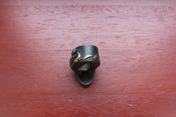

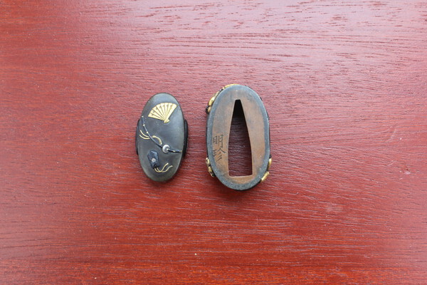

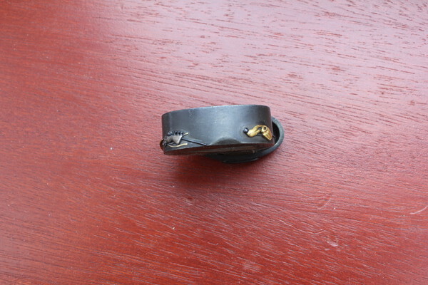

Bob M. Posted May 7, 2021 Author Report Posted May 7, 2021 Item No. 38 Fuchi Kashira in shibuichi with gold , silver and shakudo . Monkey and trainer with all the accoutrements . Inscribed Myochin . Another set with a questionable signature ? Decent quality work , although not outstanding... Quote
DirkO Posted May 7, 2021 Report Posted May 7, 2021 Hi Bob, indeed, a solid set, but maybe not as outstanding as other pieces. It's portraying sarumawashi, training a monkey to dance - but you already caught that. 2 Quote
Tanto54 Posted May 8, 2021 Report Posted May 8, 2021 Dear Bob, On No. 38, it looks like an early mei of Haynes 06403 Myochin Kingyokudo (it could also be an early mei of Hirosada). This Myochin is, of course, not related to the famous armorers but may be related to the Umetada family. The work looks like something that he could have done early in his career to me. 2 Quote

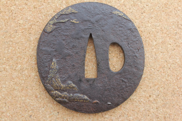

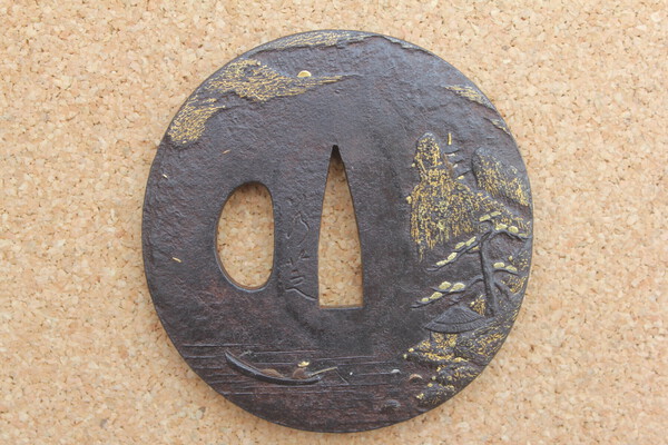

Bob M. Posted May 9, 2021 Author Report Posted May 9, 2021 Item No. 39 Iron Tsuba with gold , silver , copper and shakudo highlights and details 6.95 cm x 6.74 cm x 0.52 cm A Jakushi tsuba with moon in a cloud , temple in the distance on the mountain , an old hermitage by the pine trees and fisherman on a boat. Signed Jakushi , but which generation ? Bought nearly 20 years ago from a Japanese seller on Ebay. Not in bad order for a Jakushi... 1 Quote
