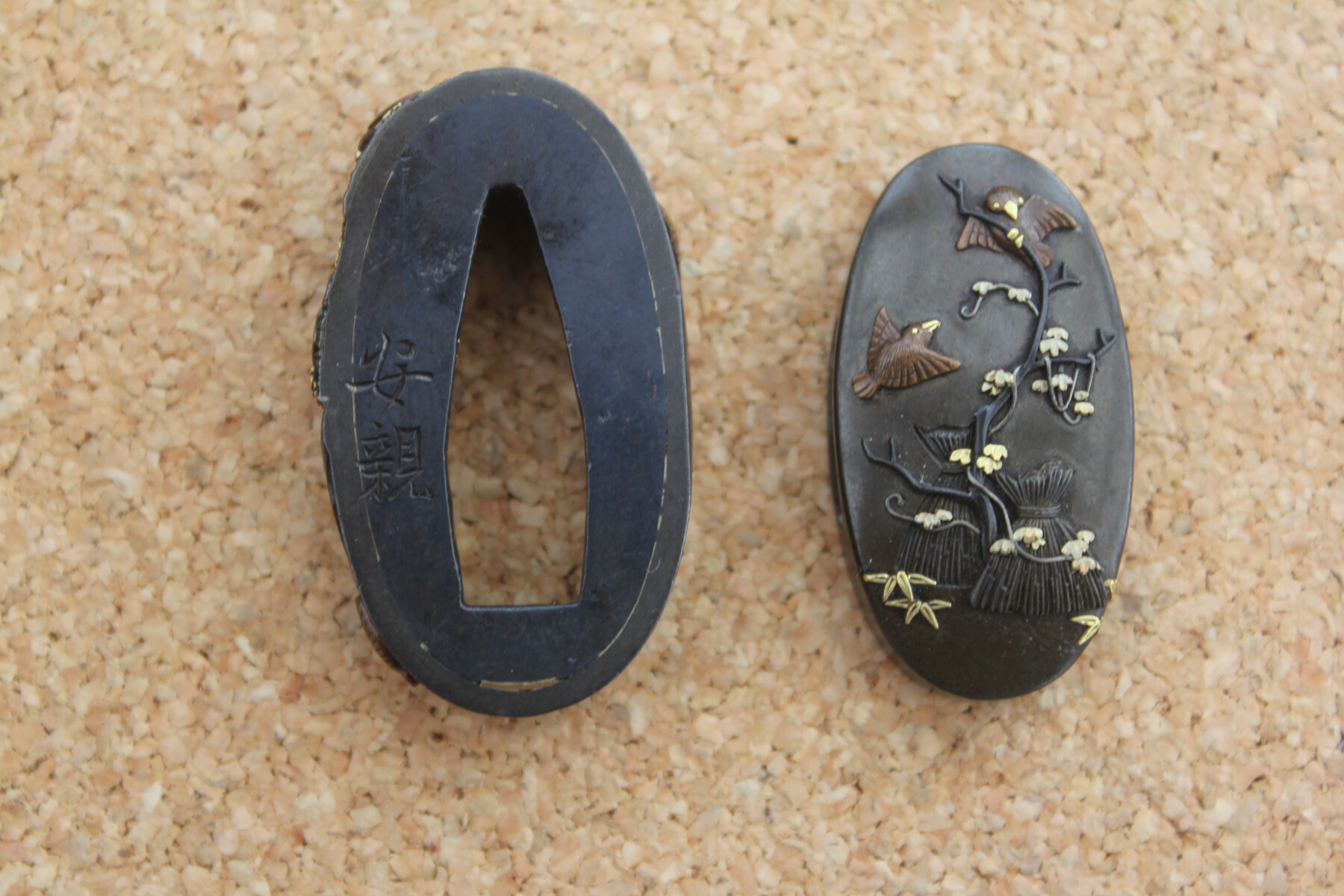

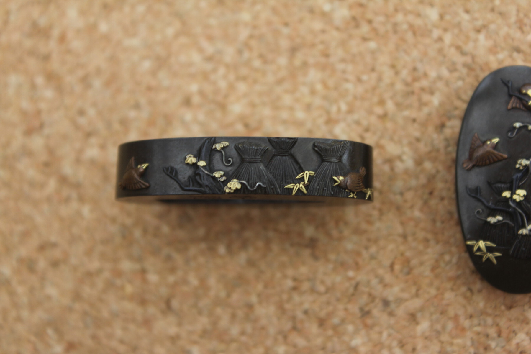

Item No. 23 - Shibuichi Fuchi Kashira with copper , shakudo and gold inlays.
Sparrows ? flying amongst stooks of rice , signed Yasuchika ?

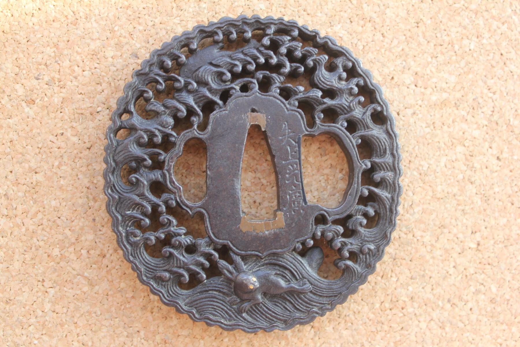

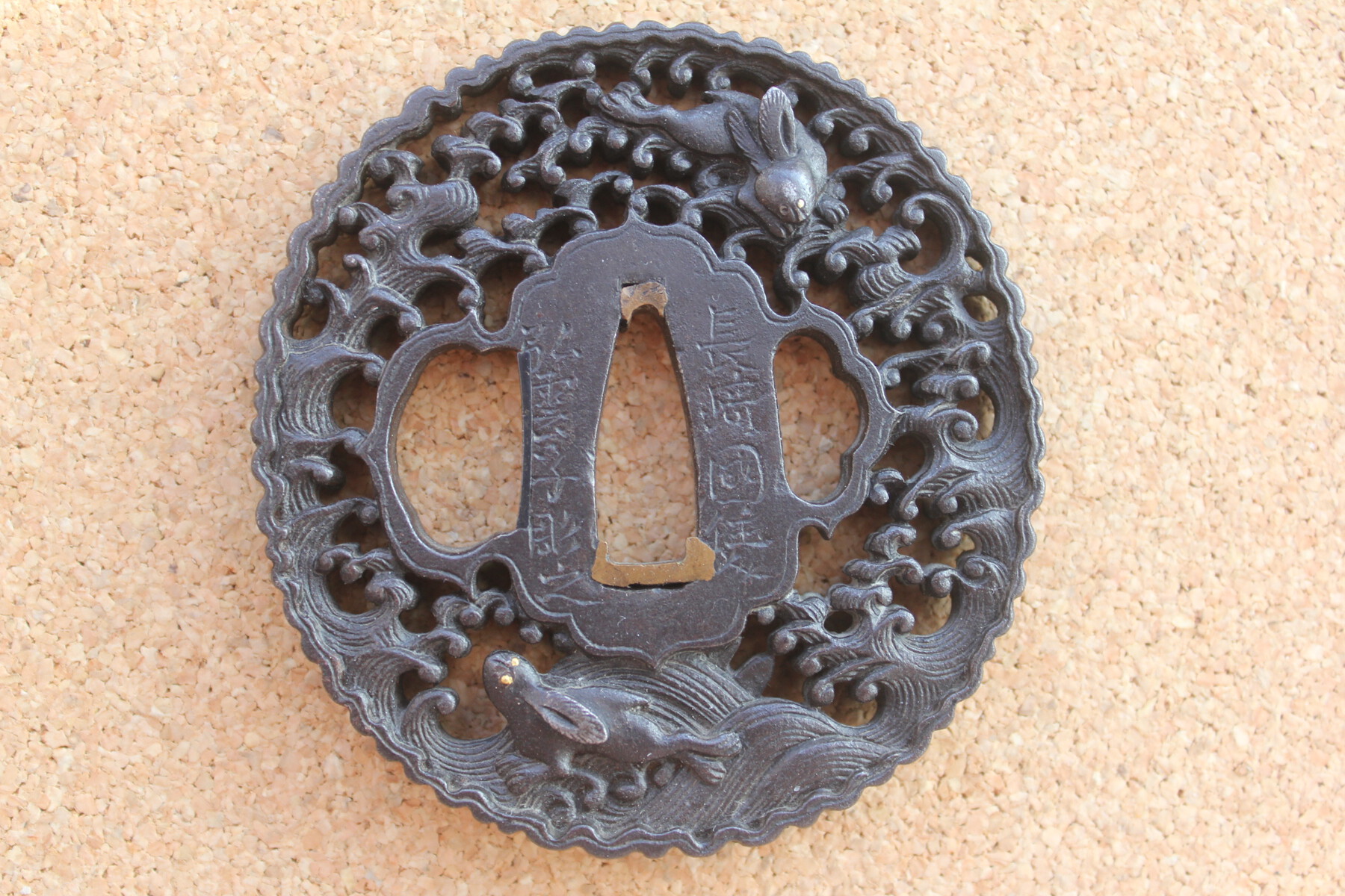

Item No.24 - Iron sukashi tsuba  - Yagami school , Hizen - late 18th century 7.60 cm dia
Subject of three hares running with stormy waters
Signed Yagami Mitsuhiro on rear - Can anyone translate the inscription on the front ? Is it a dedication for a commissioned piece ?

Thanks for your positive comments ...
Still trying to sort out if the longer inscription is a dedication...
Any views ?
Regards
P.S.  Apparently it reads - Nagasaki kuni ju Kounshi kore wo cho -
Hi Bob,
On Number 24, instead of First Master of the Yagami School (Haynes Index no. H05200), your tsuba is by the Third and final Master of the Yagami School (Haynes Index no. H05202) who was a descendant of the First Master (see Haynes entry below).  The tsuba reads: Nagasaki kuni ju nin ("living in Nagasaki"); Kounshi kore [wo] horu ("Kounshi this carved"); Yagami Mitsuhiro.  He was the son, nephew or grandson (it is unclear) of the First Master.

Hi George ,
Thanks for your reply on item 24.
An interesting signing on an unusual piece.
Is there a tale in Japanese mythology or folklore that is being referenced here do you think

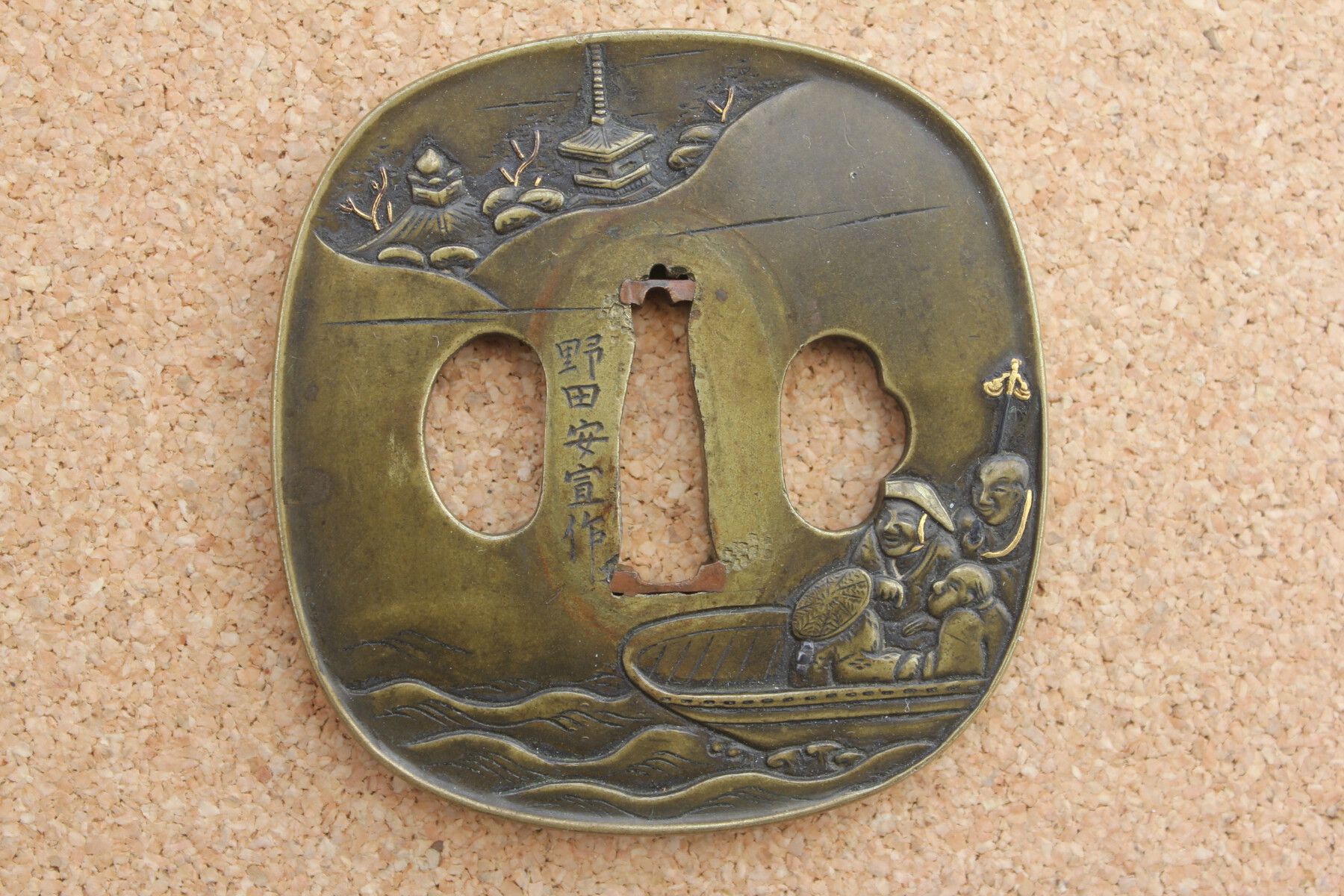

Item No. 26 -  Tsuba in Sentoku with Gold and Shakudo takazogan highlights   7.2cm x 6.9cm x 0.4cm ( 0.5cm over rim )
Subject of travellers in a ferry boat with temples in the distance , boatman and river bank on rear.
Carved using sukidashibori and shishiabori techniques with takazogan highlights.
Signed Noda Yasunobu saku - According to Sesko Geheologies , page 22 , he appears to be the founder / head of the Uemura school in Kyoto.
Ex Clarence McKenzie Lewis Jr. collection
Ex Michael Tomkinson Collection
Ex W.C. Hope Collection
Quite heavily encrusted with dirt in places , could probably do with a light clean , but not to disturb the mature patina...

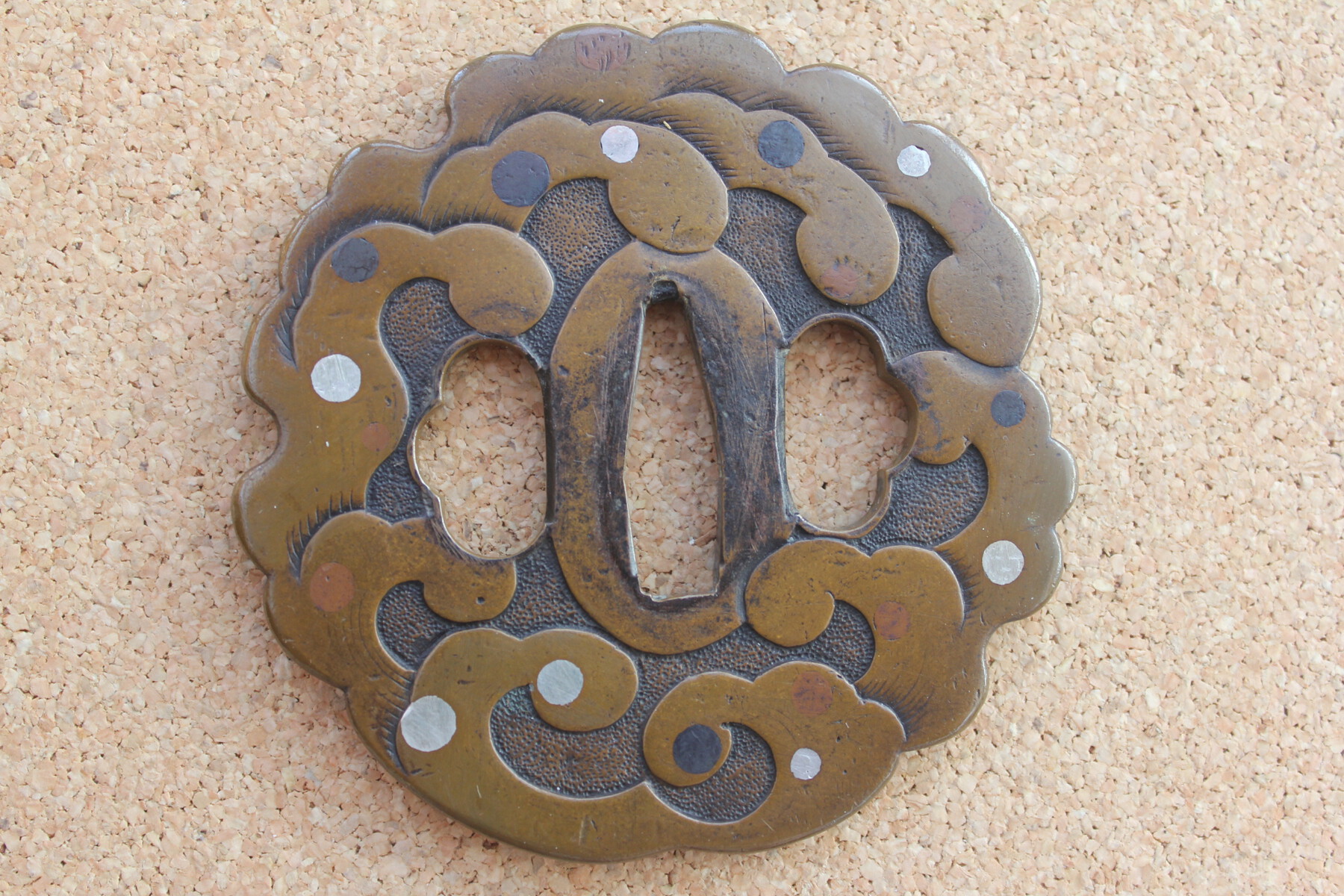

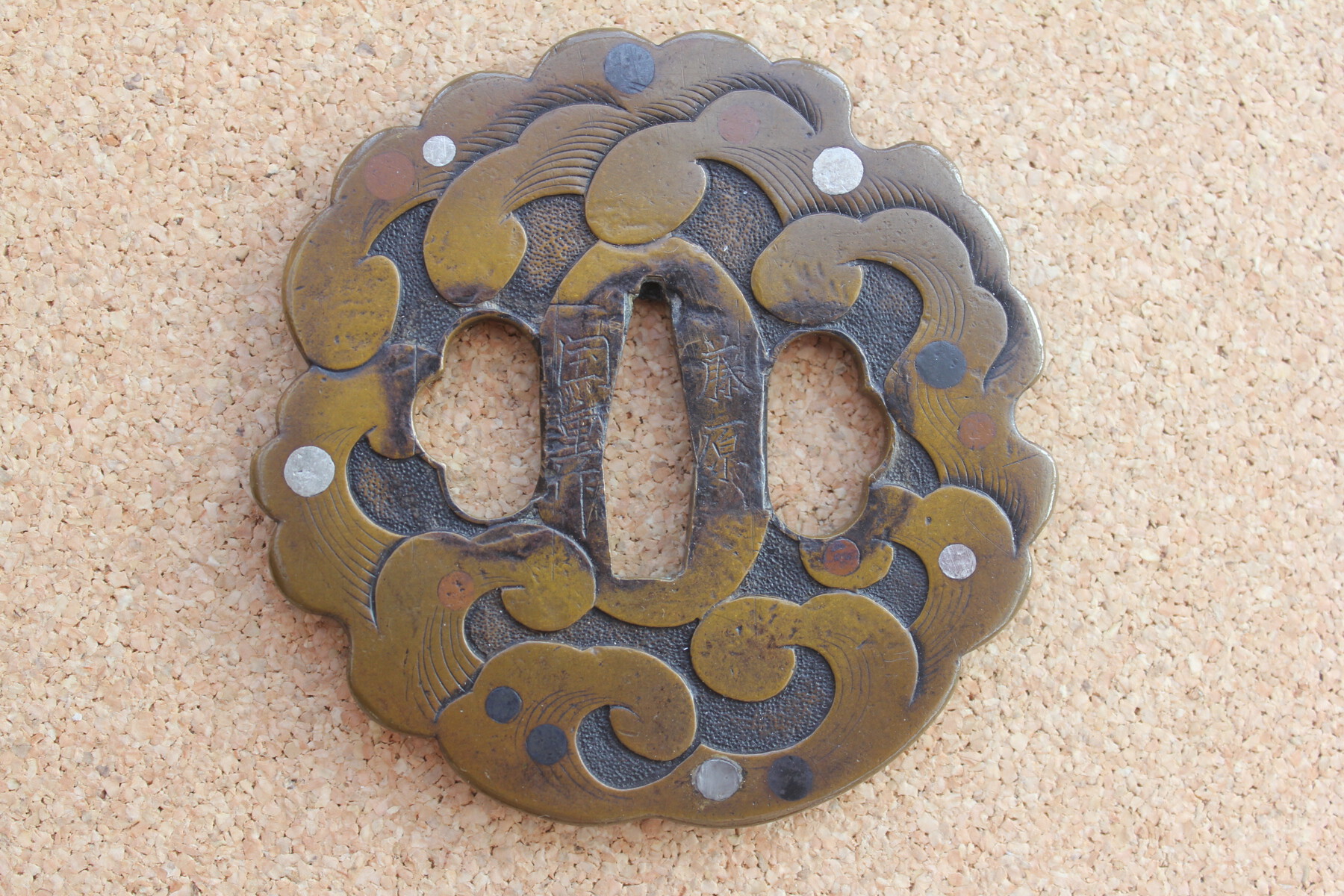

Item No. 27 Katana sized tsuba in brass and mixed metals inlay   7.81cm x 7.92cm x 0.44cm
Theme of waves.
NBTHK Hozon papers
I have had this tsuba for over 18 years but it was not until writing out this post that I realised I do not have a translation of the signature or papers. If anyone can help , I would appreciate it...
A scan of the papers is attached separately , as the signature itself is indistinct and is not easy to read.
The tsuba looks different today from when it was papered - I have had the Hitsu-ana plugs removed . Where a tsuba has plugs which are the first things you see when glancing at it , then unless they are part of the original design , in my view have just been added to make the fitting more saleable to the Western buyer or tourist ( who like a bit of extra flash ). If the plugs are discreet or have been incorporated into the original design , then they are part of the history of the piece and should be left in place . Not in this case  , however. Any alternative views ?
