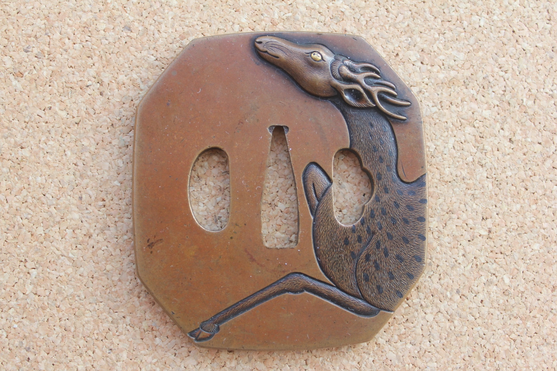

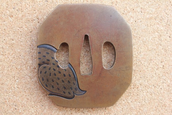

Item No. 282   Tsuba in Copper with shakudo and gold    7.15 cm x 6.62 cm x 0.39 mm over plain , 0.65 cm over inlay.
Subject of deer, possibly moon watching . Unsigned but attributed to Tsuchiya Yasuchika.
I believe this to be quite a well known piece showing very good craftsmanship and decorative skills. The image extends seamlessly around the edge .
In the hand, the light reflects off the deers coat in the same way as seen in nature , following the contours of the animals body.
Ex Naunton Collection No. 3641

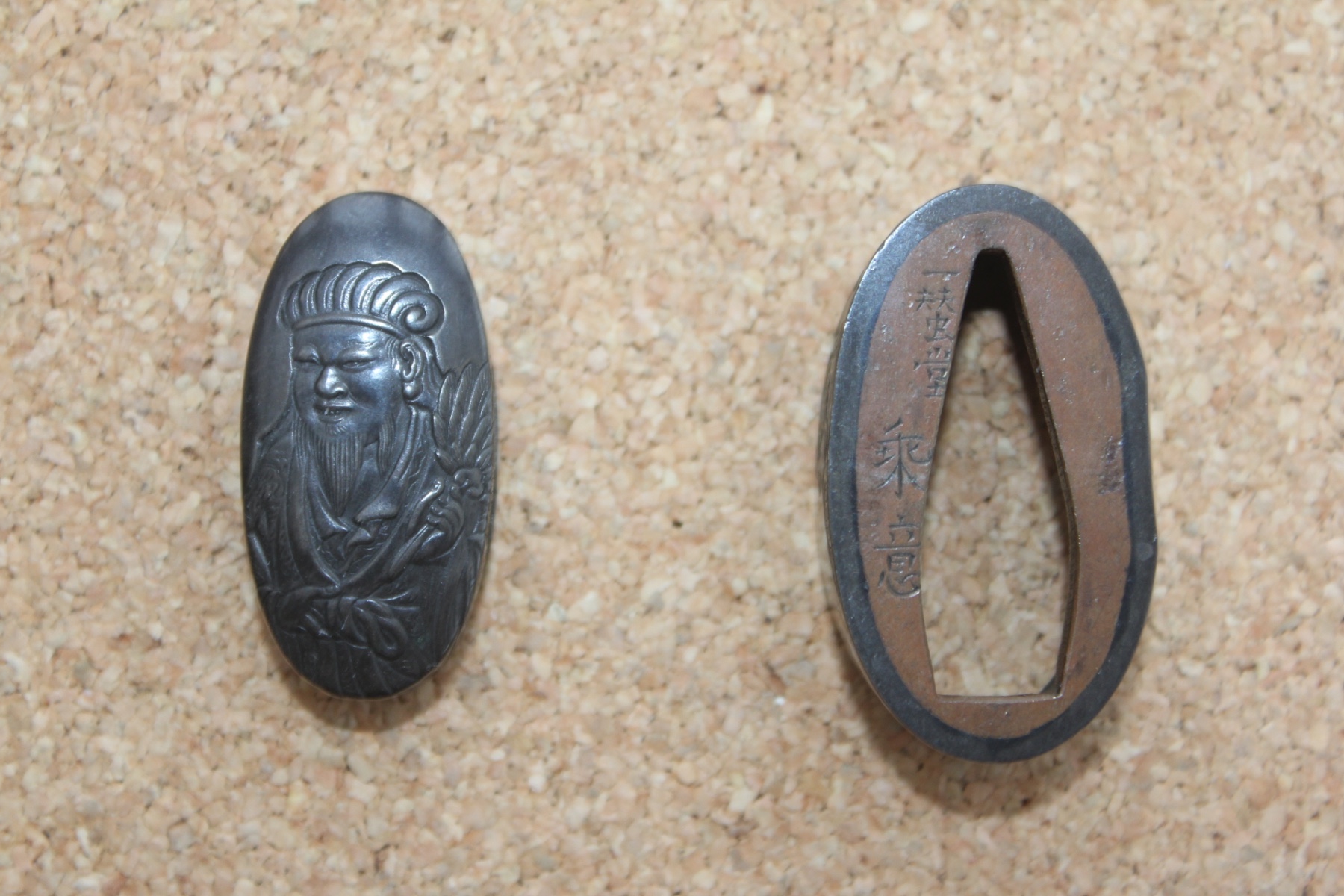

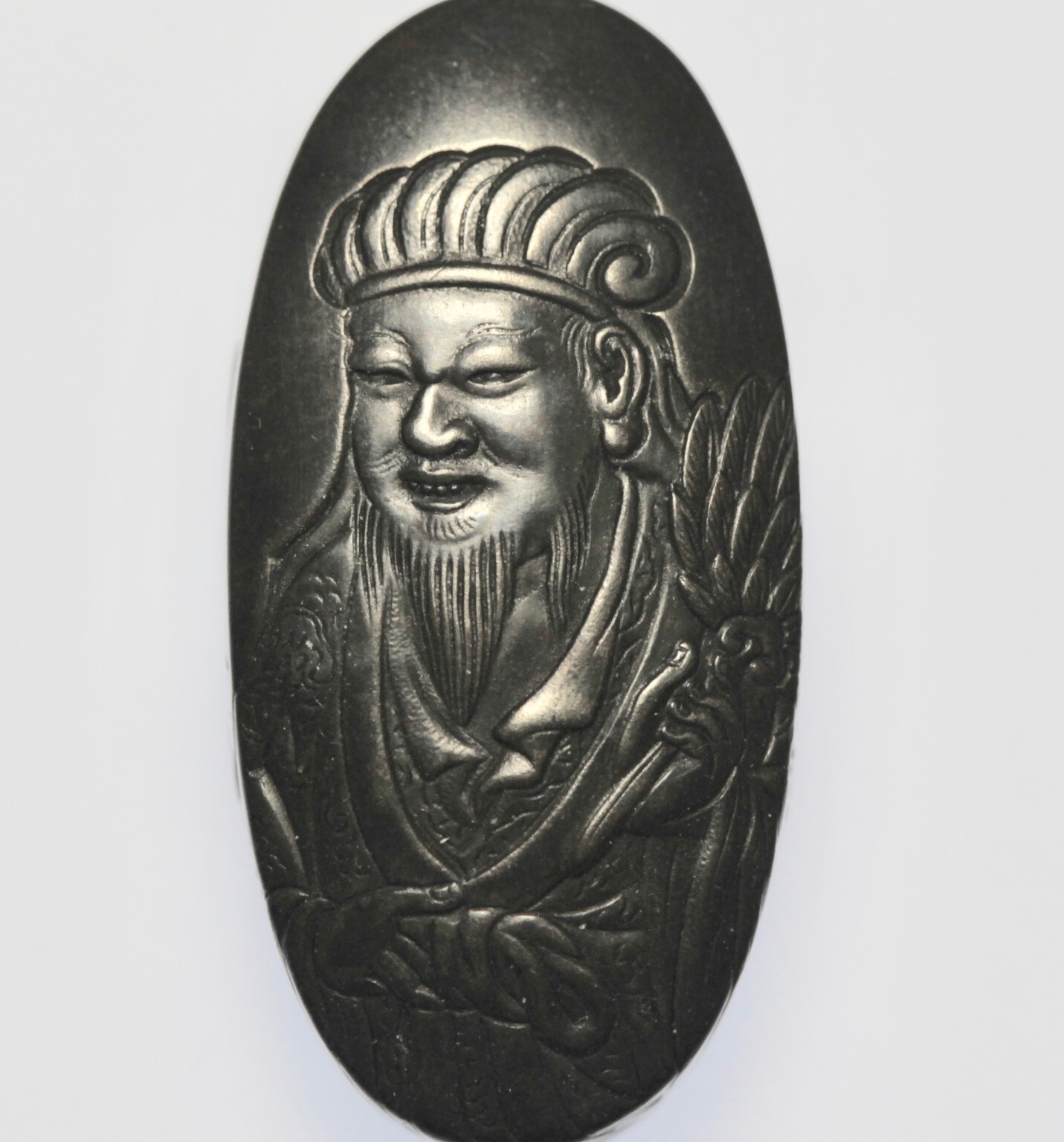

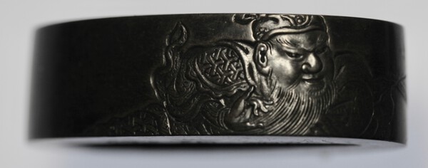

Item No. 284   Fuchi Kashira in Shibuichi carved in Shishiabori.
Subject of Guan Yu & Zhuge Kongming . Signed Issando Joi ( 18th Cent. )
Important figures from 3rd cent. China, symbolising wisdom and strategy , they are depicted with almost photographic realism on these fittings.

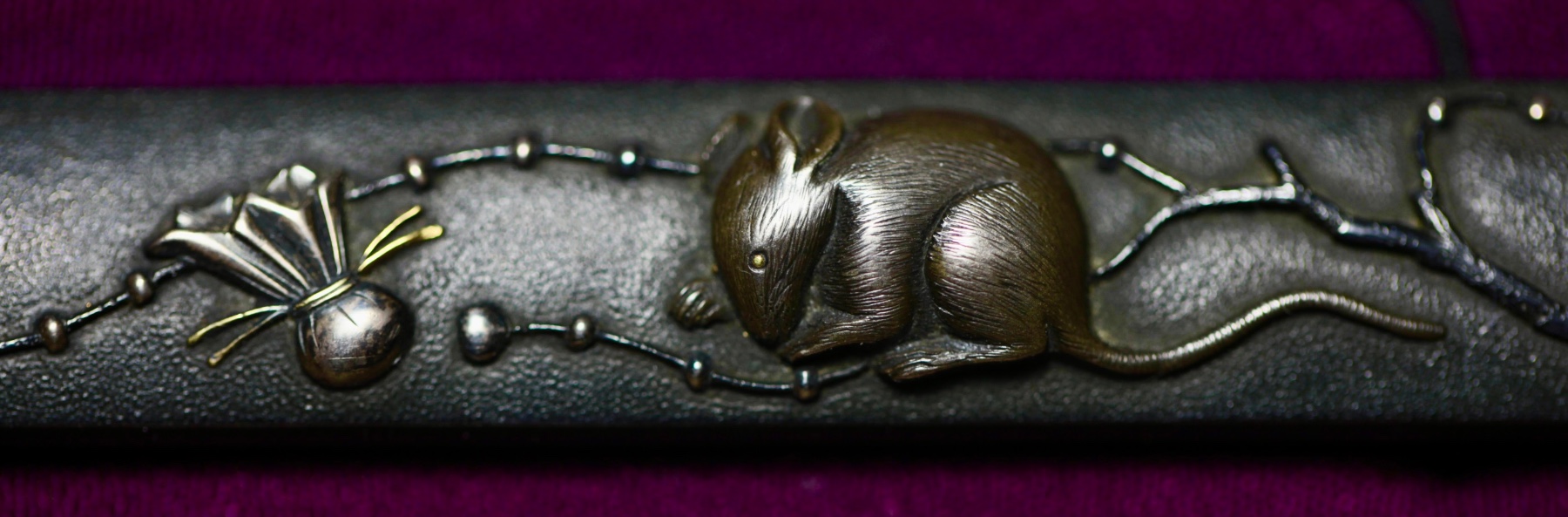

Item No. 285   Kozuka in Shakudo with copper , silver and gold.
Subject of a rat with a sack and a branch . Signed Tsuneyoshi and , unusually for a Kozuka , bearing a date. This is shown as 1813 which would seem to place the artist in Kyoto's Ichinomiya School.
A full translation of the inscription would be most welcome.
Good quality work , the rat appears to have been carved in a brownish shade of shakudo with many contrasts of texture and detailing shown through the piece.
The confident execution of the signature adds to the overall effect.
