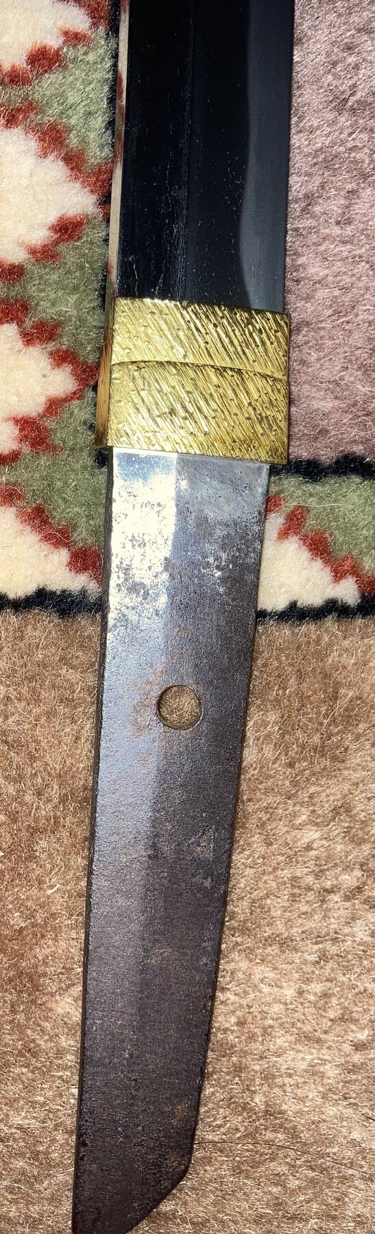

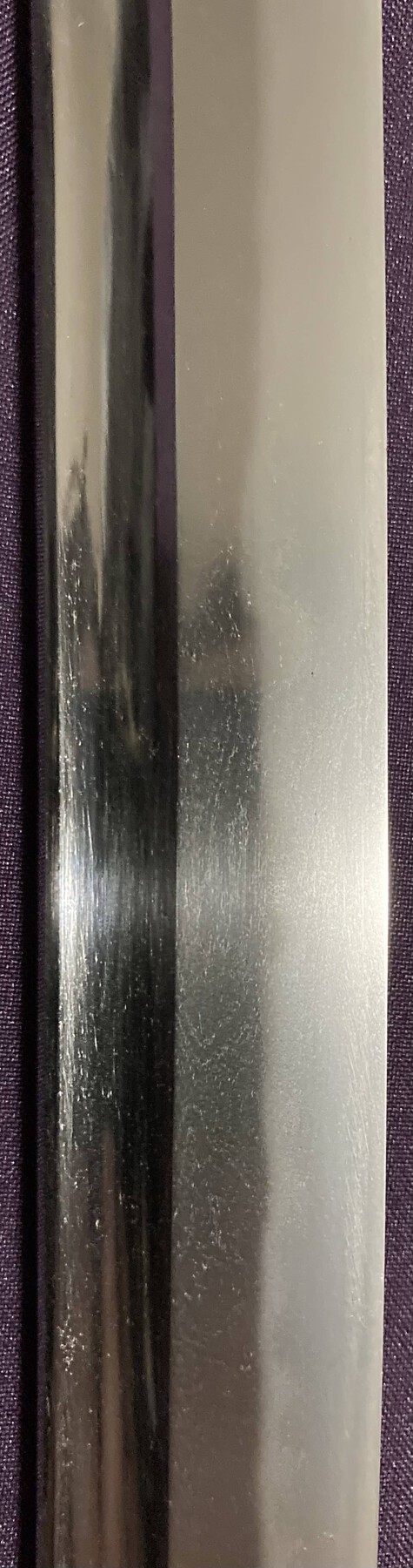

Anyways, last year I bought an unsigned sword with old Kicho papers attributing it to Kashuu Kiyomitsu. I know that’s less reliable than new papers but I genuinely like the sword, and it’s got the kaga nagako and matches what Marcus and others write about Kashuu Kiyomitsu traits like the Ashi and coarsish Itame hada with the occasional masame thrown in.
I can’t read Japanese though so my ability to understand the NBTHK papers is limited to what OCR software can tell me which is that it says Kashuu Kiyomitsu and it’s an old certificate from the 50s. If anyone can tell if the papers narrow the attribution down to a generation that would be great. Or if not, might it be possible to use the photos to guess which Kiyomitsu made it? The ashi and konie in a hamon that’s otherwise nioi kind of sound like what the books said about Hinin Kiyomitsu, and he has an interesting story so I think it would be nice if this sword were conected to him but even if it weren’t, I’m quite fond of it.
I hope the photos of the certificate, and ones where I tried to capture the hamon, or hada help with identifying the maker.

Also if it’s of any use, here is a photo of what was its torokusho, some nagako photos, and a couple more photos where I tried to catch the masame that shows up in the hada.
Also the swords proportions are as follows: Nagasa is over 61cm, and the sori is about 1.5cm.
Thanks again
