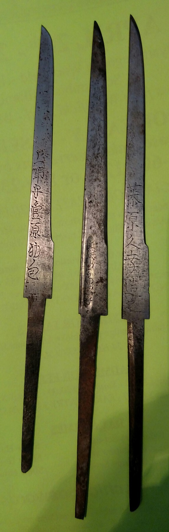

Mark Posted February 24, 2021 Report Posted February 24, 2021 Jose where in KY are you? I was in Louisville last weekend and could have brought all my items to show you. Not all blades and handles fit all koshirae so sometimes the fit is important if you need it for a particular use. you can email me at nixe@bright.net mark Quote

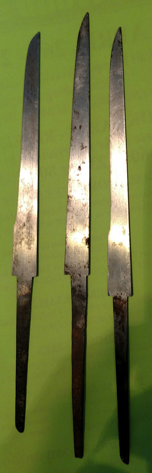

Mark Posted February 24, 2021 Report Posted February 24, 2021 I have to these 3. $150 plus post each. i also have a couple of polished blades in shirasaya 1 1 Quote
Battara Posted March 7, 2021 Author Report Posted March 7, 2021 I may take you up on this. Would these blades fit any kozuka? Would they together fit any Wakizashi? Jose C Quote
Fuuten Posted March 8, 2021 Report Posted March 8, 2021 I think the one way to find out is stick a piece of paper in, deepest point total length. I'm not entirely sure if they're simply squared out or rounded. Pretty sure they are not shaped to specific kogatana although who knows perhaps that happened at some time or another, not standard. Quote
Brian Posted March 8, 2021 Report Posted March 8, 2021 I would say usually yes. There isn't a huge variation in kogatana/kozuka sizes although there is some. But generally speaking they should work fine. Quote
