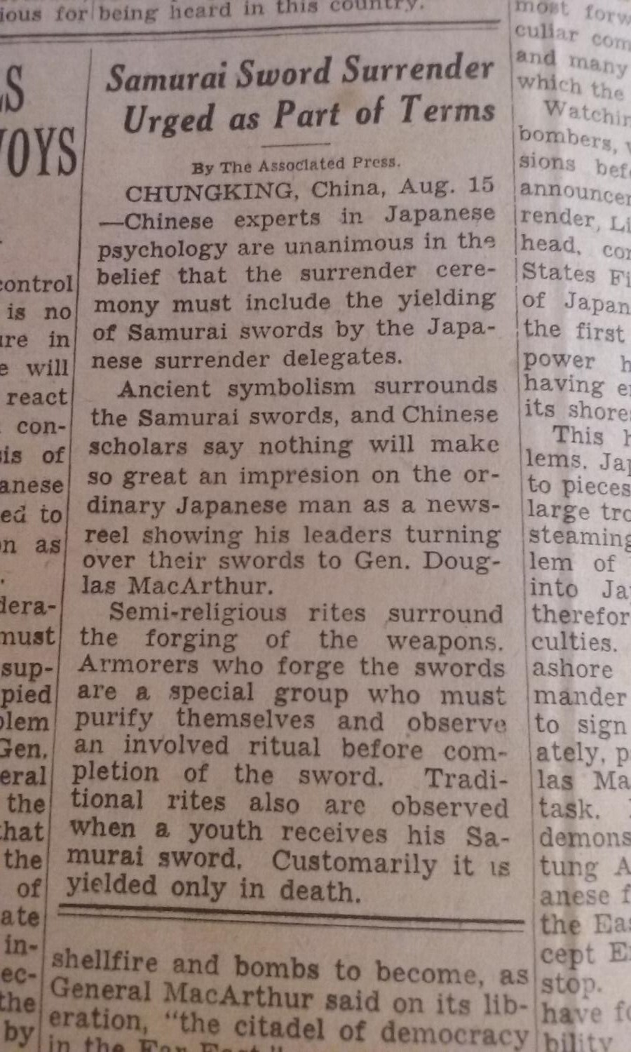

 Pressure from the allies.
58 minutes ago, BANGBANGSAN said:

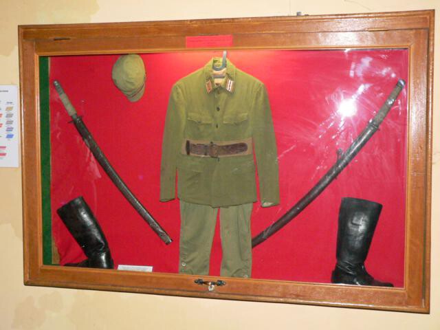

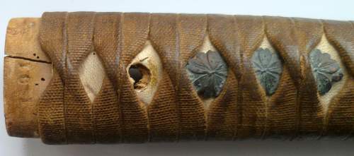

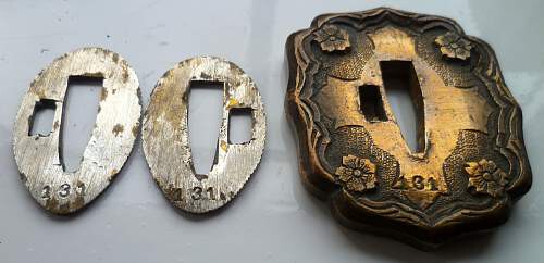

It is such a shame that the photographs of the time can be so hard to make out clearly. The wrap on the sword in the first photograph sure appears to be the same style... but is that a brass tsuba? I just can't make it out.
It would be good to see what is on the nakago (if anything) of the sword... should the handle be possible to remove.
I'll share what I popped together after a 'Chinese fake' was discovered to be a Javanese sword and people started to share photographs.
Those are coming from below.  That is one of the better marked examples of the Java-tō.

Thank you for sharing pictures of this interesting sword.  I am of the personal opinion that these swords were intended for use by Pembela Tanah Air (PETA).
The top picture that Shamsy posted above is coming from the Pembela Tanah Air [Defenders of the Homeland] Museum in Indonesia.  Possibly you can contact them for more information about those two swords.
