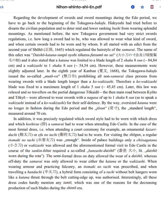

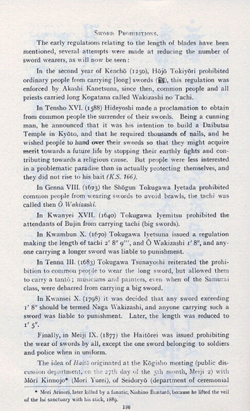

ChrisW Posted February 17, 2021 Report Posted February 17, 2021 Written into the very laws of Japan by the various rulers throughout history. E.g. Tokugawa shogunate laws restricting sizes and who could wear. 1 Quote
DoTanuki yokai Posted February 17, 2021 Report Posted February 17, 2021 Yea I know but where do they say that the blades allowed for not Samurai are wakizashi. Quote
ChrisW Posted February 17, 2021 Report Posted February 17, 2021 I can't remember where to find them. Maybe someone has a link to the article detailing the progression of sword laws? Quote
Gakusee Posted February 18, 2021 Report Posted February 18, 2021 We really ought to hit the books more...... it took me a bit of time to prove the point Christian S was contesting.... 2 1 Quote
ChrisW Posted February 18, 2021 Report Posted February 18, 2021 Thanks for finding it again Michael! I knew someone had to have it on hand. Quote

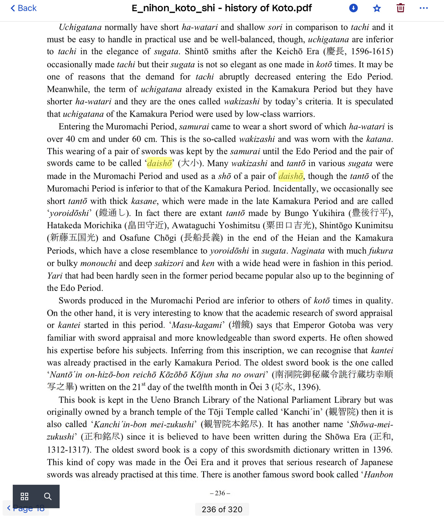

Shugyosha Posted February 18, 2021 Report Posted February 18, 2021 There's an interesting article here on the swords of the 47 ronin. It's surprising how many of the examples cited carried a short sword of what we would regard as katana length. http://www.japaneseswordindex.com/ronin.htm Quote
IanB Posted February 18, 2021 Report Posted February 18, 2021 I think we can get very fixated about sword definitions and lengths. As mentioned in Marcus's article, the Tokugawa were obviously uptight about commoners carrying swords that were just below 2 shaku, probably in overlong saya, and decreed the maximum lengths. Having said that, the samurai class were obviously not so rigid in their attitude, wearing swords commensurate to their stature. I have a daisho in which the daito is only 22.4" (57cm) long and the shoto 18.1" (46cm) which I worried about for a while before being told it was for a small person. Ian Bottomley 3 1 Quote

Jean Posted February 19, 2021 Report Posted February 19, 2021 Don’t bother: there is only one official classification done to avoid endless discussion Under or equal to One shaku: Tanto Between one to two shaku: wakizashi Over two shaku: katana or tachi Now you are free to use whatever term you want but officially the above classification will be used. In the same way in official papers, you’ll only see : Naginata naoshi. 1 1 Quote
