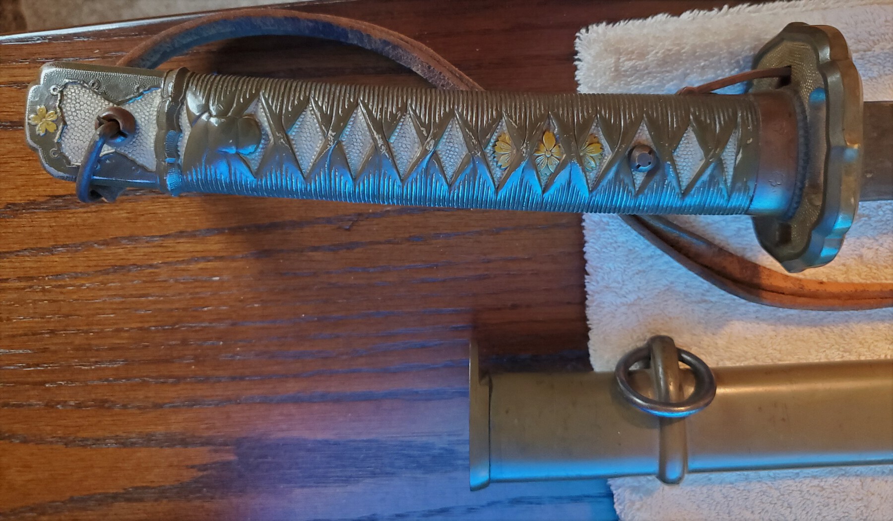

I've had the opportunity in the past to add a Type 95 NCO sword to my collection. I recall passing up 95's even during the days they could be purchased for as low as $125.00 US or less.
The only thing I can attribute not buying a 95 back then was a bit of a arrogant attitude in my younger years in thinking the 95 was somehow a bit inferior to 98's or 94's. Many of the Type 95's I would see were aluminum handles with paint missing , shiny, I thought, why would I want one of these machine made Shin-gunto  imposters in my collection.
I'll never forget my grandmother on occasion saying , " There's no fool like an old fool " while casually glancing in my grandfather's direction. Of course, my grandfather would ignore the allegation as though this could not possibly apply to himself. Well, I've arrived to the point where in many situations I could be classified in the old fool category. Especially when it comes to the Type 95's.
For a few years now, I've come to my senses , and thought how could any Japanese military sword enthusiast not have a least one Type 95. Recently, I stumbled on to a NCO sword and could not pass up the opportunity to purchase it. The tsuka retains est. 90 % of original paint, the saya retains est. 80 % of paint and has no dents. The blade is close to pristine  with a bit of rust and no chips. Looking at the construction of this sword I can't help but notice how well made it is. Everything fits almost perfectly, the design and craftsmanship is excellent. I honestly think the balance is actually better than some of my 98's.
I apologize about my bloviating digression from the intended topic, but wanted to compliment all the diehard Type 95 folks. I was wrong about these swords , they are truly an honest to goodness contribution to Japanese military swords.
Ok, my question to the 95 guys; The matching serial number is  80849, does this place it in the series just after the copper handle group? The tsuka is not the typical brown color normally seen, but more of a khaki green, is this a legitimate variant ? The kissaki has a yokote , is this something which was added to (some) blades?  The tsuba is approx. 11mm in thickness, does this indicate earlier manufacture?? Also, there are no serial numbers stamped on ishizuki ? Hopefully these are all proper characteristics of true Type 95 NCO sword and not a reproduction or one which has been repainted !
Thanks in advance,
Dave M.
Agree with Trystan.  The Kokura stamp tells us that this was made no later than 1942.  Shamsy or Stegel could pin down the date a little tighter, but in the 1940-42 range.  The "ichi" in sakura is officially an unknown contractor, but through some great research on another thread (I'll update if I can find it) there's interesting evidence that says this is the Kobe Shoten company, who later started using the "K" in sakura stamp.  Not proven, but quite possible.
The yakote is standard for 95s.  Quite beautiful on a near pristine blade!  I like Kokura/Tokyo blades.  Their lines are more precise than the Nagoya blades.  Quite attractive.
Hello Dave,
You have a lovely example there, the serial numbers tell me it is early 1941 manufacture, and as Bruce indicated it is the later (not earlier- earlier used 'K' not '-') Kobe subcontractor who made it.
This contractor is known to have used the 'greenish' paint on the handle as well as the more commonly seen brown.
Measure the tsuba, as it should only be the 9mm variant at that stage of production. The 11mm were only for the Copper handled and the very early Aluminium until stock ran out. (a few years before yours was made)
The serial numbers for this model will only appear on the blade itself, and the scabbard throat. (whereas the drag is stamped on the type 32's instead of the throat).
From your pictures, I would consider this to be an excellent to near mint example, with a bonus original tassel... very nice find. Definitely not a Chinese copy or otherwise repainted.
Judging by today's market, i would think this one would easily go for over the $1000 mark -due to it's condition, so i hope you picked it up cheap!
And finally, yes they are reasonably Well made, i agree with Bruce and Trystan, the Tokyo Arsenal made Type 95's are  cleaner and crisper overall compared to the Nagoya and later Jinsen made swords.
Congratulations and check out the link Trystan gave you for more info on these in general.
  • Thanks 2
Thank you Trystan, Bruce, and E.M.
This is all good news I was hoping to hear. I've read most of all of your post regarding the Type 95 NCO's and was glad to get your confirmation as this not being a reproduction or repaint. Maybe, a addition of the copper handle variant next...
Thank you again Gentlemen,
Dave M.
