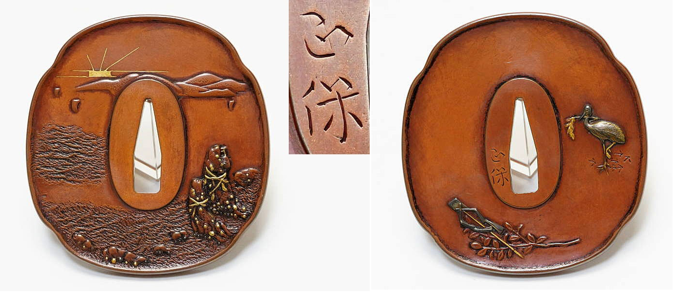

Spartancrest Posted February 13, 2021 Report Posted February 13, 2021 Robert if you see ten that look the same - run. The Chinese fakes are everywhere. You just don't get signatures like that on a real tsuba. This one is also up for auction - any idea of the mei? https://www.jauce.com/auction/r443391065 It looks very modern. The design is by Goto hokyo Ichijo who may have used a woodblock print by Utagawa Kunisada for inspiration. Goto Ichijo's original design below. The proportions are way off in the copy above. These steel reproductions are closer to the correct proportions, these were factory made in large numbers and in other various metals, all are the same rounded shape rather than the subtle mokko of the Goto original. They also lack any celestial body rising on the horizon, [There is at least one example with a silver 'moon' in place of the sun] So what do we make of the first example currently up for auction? 1 Quote

PietroParis Posted February 14, 2021 Report Posted February 14, 2021 On 2/13/2021 at 2:26 PM, Spartancrest said: This one is also up for auction - any idea of the mei? https://www.jauce.com/auction/r443391065 It looks very modern. The design is by Goto hokyo Ichijo who may have used a woodblock print by Utagawa Kunisada for inspiration. The first kanji looks like a cursive 正 (Masa/Sei/Sho) to me, but I can't figure out the second one. Maybe 弥 ? This would make it Masahiro/Masaya/Seiya, does any of these names ring a bell? Or maybe it's 侏 ? Quote
Spartancrest Posted February 15, 2021 Report Posted February 15, 2021 Pietro, I think it is not meant to make sense, it is meant to deceive. 侏 Mijika = in English means 'Actor' 2 Quote
kissakai Posted February 15, 2021 Report Posted February 15, 2021 Pietro - Have noticed the top kanji is a smiley face 1 Quote

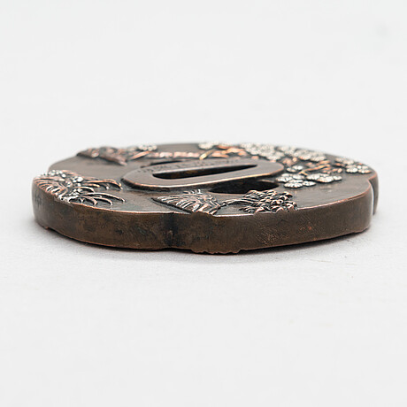

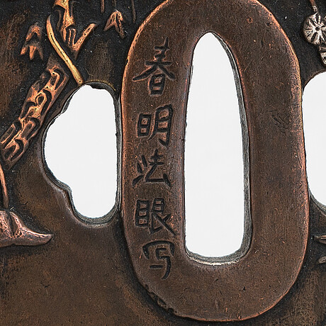

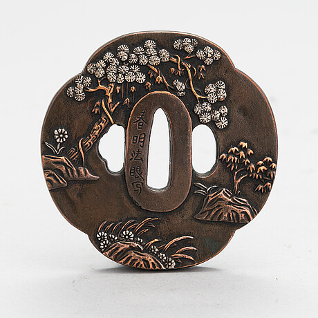

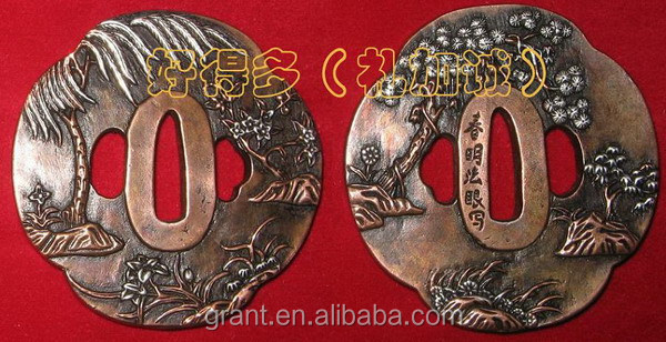

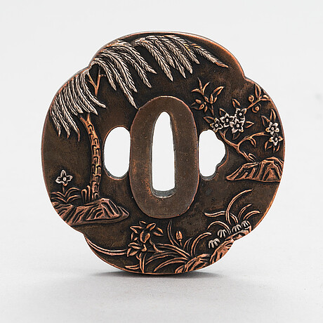

Spartancrest Posted February 15, 2021 Report Posted February 15, 2021 That original Chinese fake - https://www.lot-art.com/auction-lots/A-Japanese-signed-tsuba/1293649-japanese_signed-21.2.21-bukowski - they want somewhere near €250 ($285 USD) 1 Quote
PietroParis Posted February 15, 2021 Report Posted February 15, 2021 Gotta love the description: “The general impression is good.” 1 Quote
PietroParis Posted February 15, 2021 Report Posted February 15, 2021 1 hour ago, kissakai said: Pietro - Have noticed the top kanji is a smiley face I wouldn't put it past them, but I still think it's a cursive 正: 1 Quote
Spartancrest Posted February 17, 2021 Report Posted February 17, 2021 The auction site translates the 'signature' as 正保 = Shōhō I don't know of a smith or tsuba-ko with that name but Shōhō (正保) was a Japanese era name after Kan'ei and before Keian. This period spanned the years from December 1644 through February 1648. [I cannot see this tsuba being made within 300 years of those dates] 1 Quote
