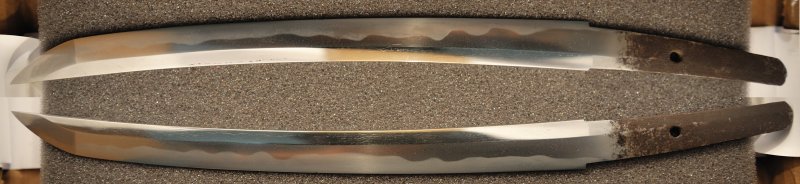

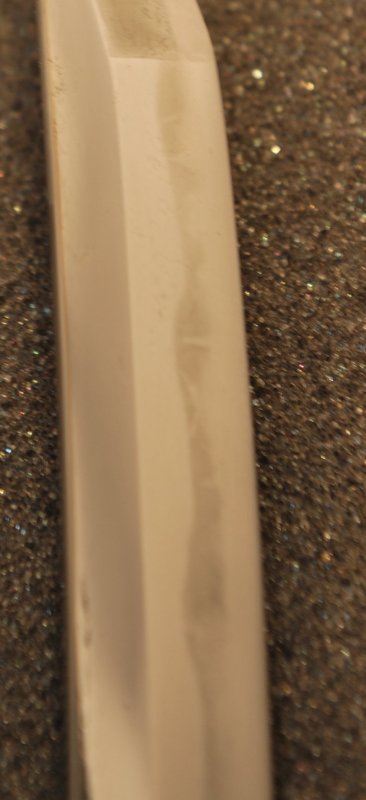

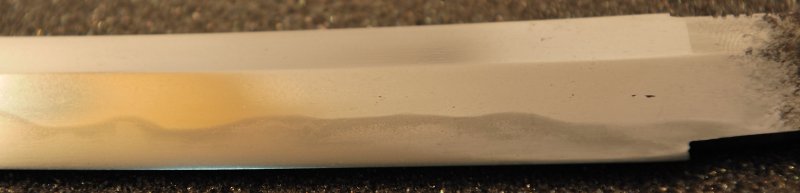

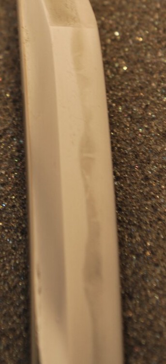

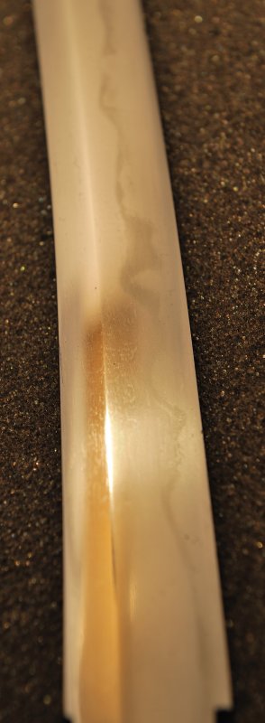

shan Posted December 17, 2008 Report Posted December 17, 2008 This is the tiny 25cm scaled down wakizashi in Miniature scaled down wakizashi mounts that I have. Its not a boys day sword (confirmed by a BDS collector of some standing)and it is defiantly a wakizashi. I do not know what it is, but as samurai were the only ones allowed to wear a daisho, it opens some difficult questions. Please let me have your views on the Blade and activity and again perhaps a rough date and school. Regards Shan Quote

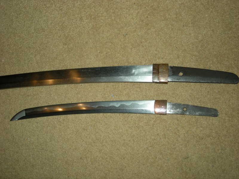

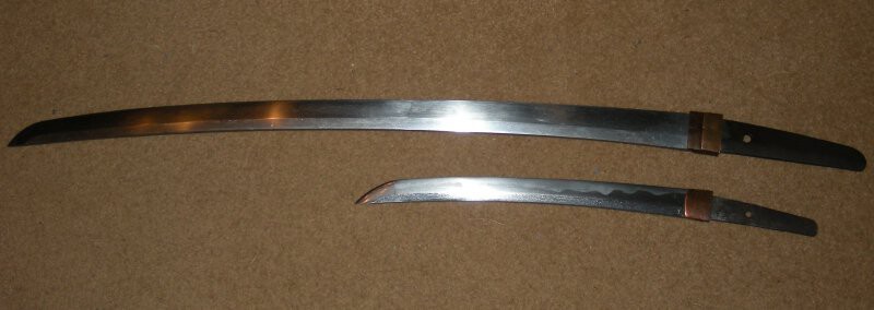

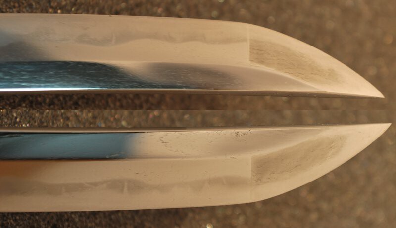

Stephen Posted December 17, 2008 Report Posted December 17, 2008 looks nice any chance to do a side by side of someting so we can get a feeling for scale? Quote
Brian Posted December 17, 2008 Report Posted December 17, 2008 Is 25cm the cutting edge, or the whole blade from kissaki to nakago jiri? I can only think it must have been some sort of presentation piece or dedication or maybe just a sample of work in miniature? Brian Quote
shan Posted December 17, 2008 Author Report Posted December 17, 2008 Hi GuysBrian,Stephen ,i can supply an image of it next to a wakizashi for scale ,i will use one of similar shape. I will post it here tomorrow. Brian,I also think it was a miniature of some sort like an example of workmanship or presentation piece. Its an odd beast for sure but nicely done,but i will try to restore the Edo period mounts as well. Problem is everything was scaled down and the Kashira was missing so i am going to find it Difficult to replace,but all else is there. The nagasa is 25cm sorry. any idea of school or period? Many thanks shan Quote

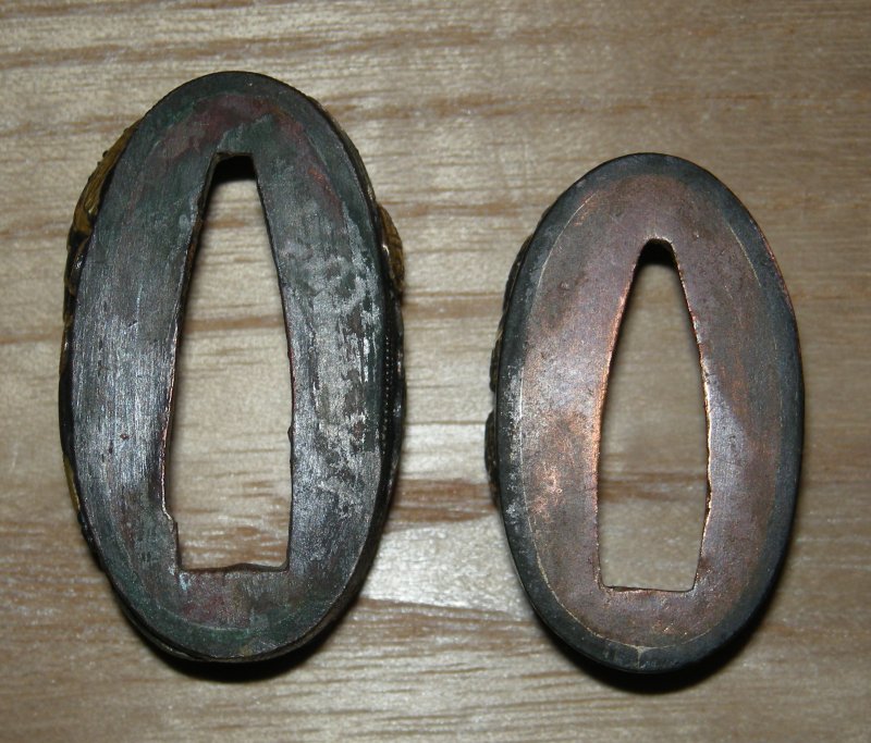

shan Posted December 17, 2008 Author Report Posted December 17, 2008 Here is a quick comparison against a 52cm Wakizashi. and a comparison against a tanto/small waki Fuchi. regards shan Quote
