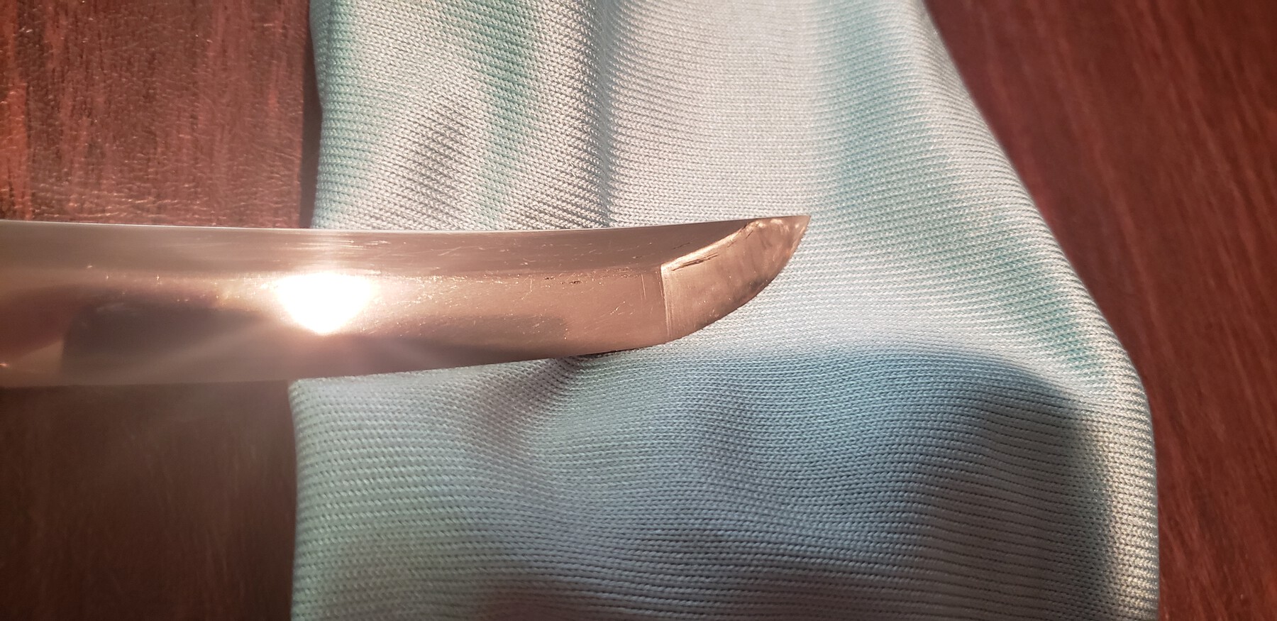

Hello,
I was recently looking over what appears to be a late Muromachi, or early Shinto Wakizashi. When I noticed what looks to be a fatal flaw, on the Mune of the Kissaki. The owner thinks it is just Mune ware.

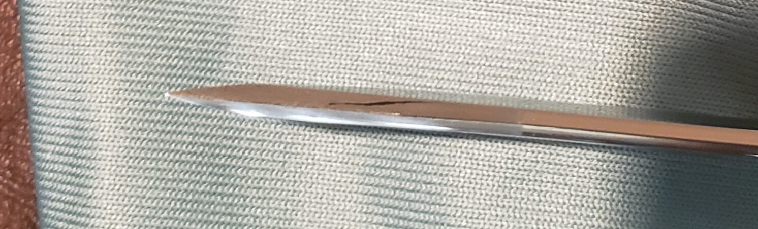

I also noticed an area in the Ji of the Boshi, that also had me concerned.

The piece is a bit tired, but balance and Sori are nice.
If you would please, your thoughts?

If I am seeing what you refer to then are we looking at the delamination in the mune near the kissaki?  If so then the marks on the kissaki do appear to relate to that.  It looks like a forging flaw, a part of the blade where the weld between layers was not completed well.  It's a little ugly but not what would usually be called fatal in that it does not significantly impair the blades functionality.
It may be that this flaw was not visible on the blade originally but has become exposed by subsequent polishes.  It is probably part of the reason that the blade did not cost much.
All the best.
Thank you Geriant, Bryan, and Paul. At first I though delam, however, it is pretty deep and has crisp edges. To me it looks like a stress fracture that someone tried to polish out. I am not sure I would swing this blade as it is at the backside of the strike area; even the slightest slip of the wrist would in my opinion break the blade.
Here is a close up , for Bob.
If, after the close up the consensus is not fatal, I will change my opinion.
I think you are right with muromachi but i dont think that this flaw would really make the blade useless.
As the dislamination appears to be connected i think they are just in the same area where the smith made a mistake but they are not connected throuth the steel.
