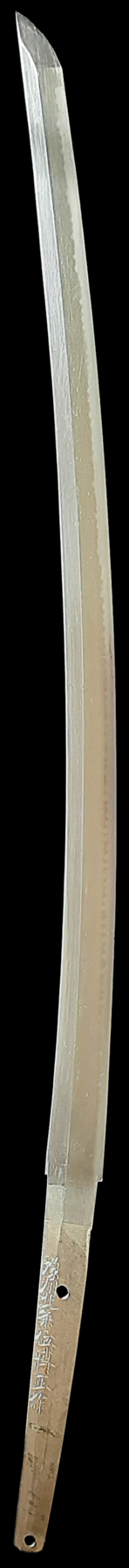

Bruce Pennington Posted March 21, 2021 Report Posted March 21, 2021 On 2/2/2021 at 7:42 PM, IJASWORDS said: Thought I would post a three character (Ichihara) NAGAMITSU Saku, who regularly made swords for the Osaka Army Arsenal. His swords were rated very highly for their cutting ability. This has no date, but a very small mune stamp. He signed his swords in 2 characters, and upto 10 characters. Debate has raged about which signature represent the best quality swords, and those that are "knockouts" for the war. This sword has an Itame haha, and a nice hamon with ko-gunome with ashi. It is in as found war time polish, and the detail doesn't photograph well. And Bruce, the fittings have heart shaped stamps, what can you tell me about this? Nagamitsu (and Emura) swords are becoming quite popular with collectors, and are now being papered. Neil, Sorry for detracting from this thread with my questions, but I assume this Nagamitsu blade has no date since you didn't post a photo? Also, and @PNSSHOGUN and any Type3/Rinji collectors - do I recall a discussion that the high-quality Rinji Seishiki fittings like this are seen in the last couple years of the war? Would the high-quality fittings and the canvas same' push an estimated date for this blade into the '44-45 timeframe? But even as I type this, I realize the blade could have been made before 1942 and re-mounted in '44-45 fittings. But, then again, I may be wrong about the high-quality RS fittings being only late in the war. I'm trying to find blades made by RJT qualified smiths that aren't star-stamped to see if any are dated after 1942. The total lack of stamps is evidence the blade was traditionally made. But if the blade was made after 1942, by an RJT smith, and it's not stamped, then a case is being made that the Star stamp was used by RJT inspectors on RJT smith's blades that weren't traditionally made. So far, I have only found non-star blades by RJT smiths on undated blades. Which likely means they were made BEFORE 1942 and the RJT system. A dated blade after 1942, and no star, would be evidence for the counter idea about the star. But I haven't found any, and yours, if undated, continues to verify the current claims about star-stamped RJT blades being nihonto. Quote

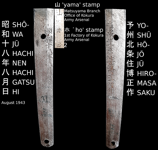

IJASWORDS Posted April 2, 2021 Author Report Posted April 2, 2021 Occasionally a nice, but mystery Gunto comes along, and no end of searching throws up any information about the swordsmith. And the best advice that can be given, is that he is an "undocumented" swordsmith, not that uncommon, but annoying when you are doing research. So here is an example, combined with a cry for help for any information. This is a 1943 YASUMASA, in what looks like its made in the MINO tradition. The photos don't do justice to the hada, homon and hataraki. It is well made in every sense, but I can't find any info about the maker. So any help would be appreciated. 9 1 Quote

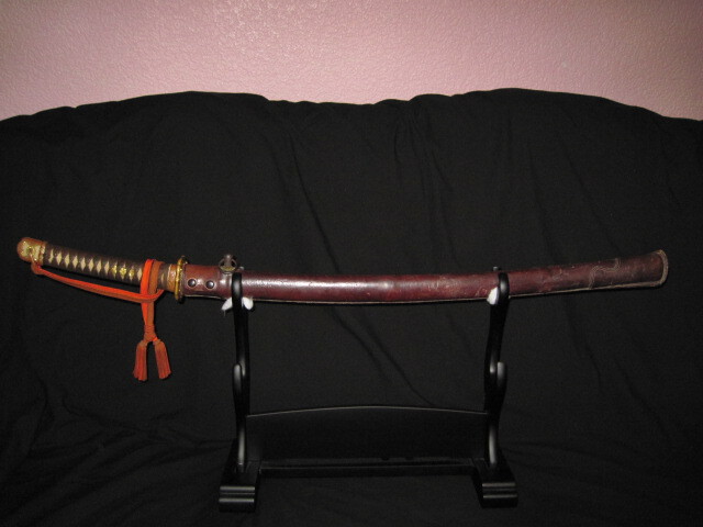

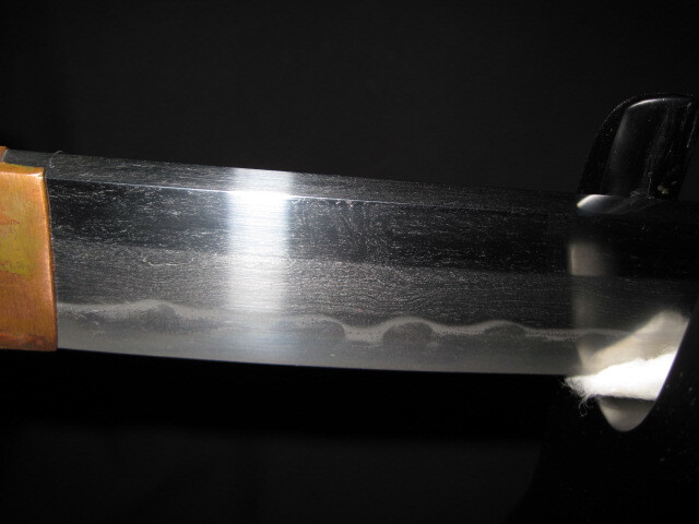

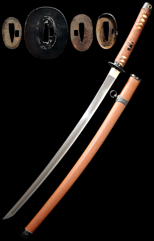

IJASWORDS Posted April 26, 2021 Author Report Posted April 26, 2021 Here is a (Kajiwara) HIROMITSU. It is dated December 1943. It looks like it started its life as a special order Civilian mounted sword, and later, taken to war in a leather combat saya. It has no stamps. The fittings are a complete set of rare Showa Period pine tree motif in brass, and a blue/green ito wrap often seen on WW2 swords. The blade is in full polish. This famous smith was from Fukuoka, was responsible for some nice traditionally made swords. 5 Quote

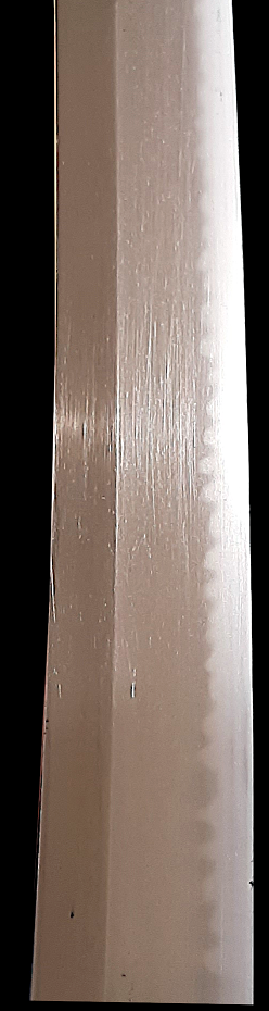

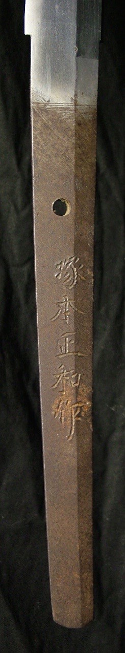

george trotter Posted April 26, 2021 Report Posted April 26, 2021 On 3/21/2021 at 10:07 PM, Bruce Pennington said: I'm trying to find blades made by RJT qualified smiths that aren't star-stamped to see if any are dated after 1942. The total lack of stamps is evidence the blade was traditionally made. But if the blade was made after 1942, by an RJT smith, and it's not stamped, then a case is being made that the Star stamp was used by RJT inspectors on RJT smith's blades that weren't traditionally made. So far, I have only found non-star blades by RJT smiths on undated blades. Which likely means they were made BEFORE 1942 and the RJT system. A dated blade after 1942, and no star, would be evidence for the counter idea about the star. But I haven't found any, and yours, if undated, continues to verify the current claims about star-stamped RJT blades being nihonto. Bruce, I must have missed this conversation, but maybe I can add to it now....not sure if this will help. Here are two post - 1942 blades by the Tsukamoto brothers Both RJT. 1. is Okimasa, worked in Tokyo. 1943 made,. No star but definitely nihonto (papered). 2. is Masakazu, worked in Fukushima. I think this once belonged to Chris Bowen...made 1945, no star but definitely nihonto (Chris wouldn't buy showato). I think that the main point about RJT smith work post 1942 but no star is just that these are private order blades IMO. Hope this helps. 1 Quote

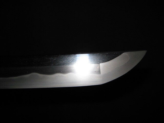

IJASWORDS Posted May 4, 2021 Author Report Posted May 4, 2021 Thought I would put up a (OTA) YASUTSUGU, he is featured on page 194 in Slough. Although rated a Medium-High Grade Gendaito, he did make some really nice swords. The nice polish on this example, displays his skill in sword making. 4 2 Quote

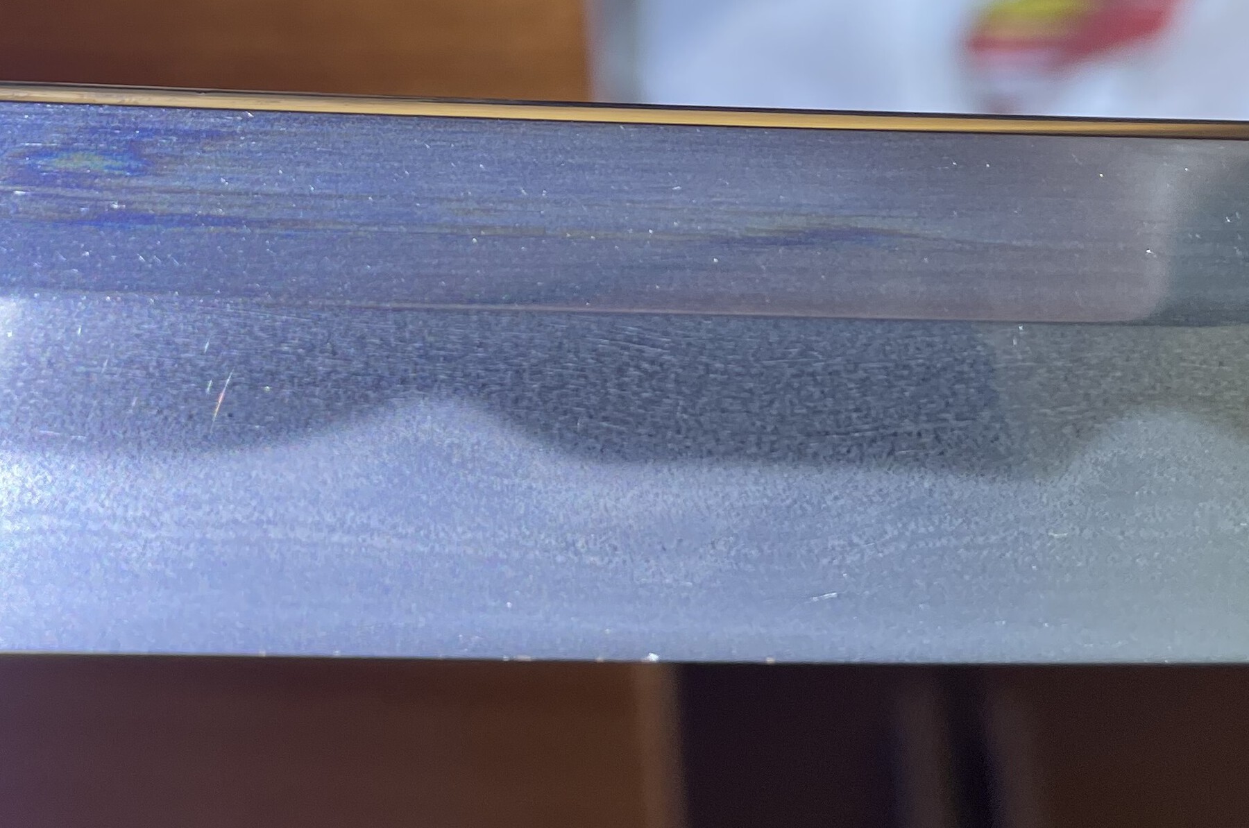

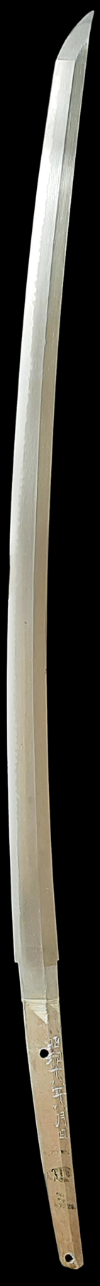

IJASWORDS Posted May 12, 2021 Author Report Posted May 12, 2021 Wish I could take photos as good as Tom above, but here is my attempt. A 1936 GASSAN SADAKATSU, polished, papered, which shows the AYASUJI hada. The sword is dedicated to the birth of the Imperial Prince. 9 2 2 Quote
MarcoUdin Posted May 12, 2021 Report Posted May 12, 2021 The hada on that is beautiful Neil, executed perfectly 1 Quote
francois2605 Posted May 12, 2021 Report Posted May 12, 2021 Oh wow, this Gassan is absolutely stunning Thanks for sharing this beauty ! 1 Quote
Bryce Posted May 21, 2021 Report Posted May 21, 2021 G'day Neil, Beautiful sword! Are you sure it wasn't made in Showa 8, 1933? Cheers, Bryce 1 Quote
IJASWORDS Posted May 22, 2021 Author Report Posted May 22, 2021 Bryce, you are correct, slip of the keyboard. Quote

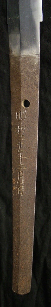

Ed Posted August 4, 2021 Report Posted August 4, 2021 AKIHIDE, KURIHARA NBTHK HOZON SUGATA: SHINOGI ZUKURI MEI: KUNYON-TO KURIHARA HIKOSABURO AKIHIDE DATE: SHOWA JU ROKU NEN HACHI GATSU KICHI JITSU (1946) NAGASA: 74.93cm (29.5″) OVERALL: 97.15cm (38.25″) For more photos: https://yakiba.com/akihide-kurihara/ 3 1 Quote
