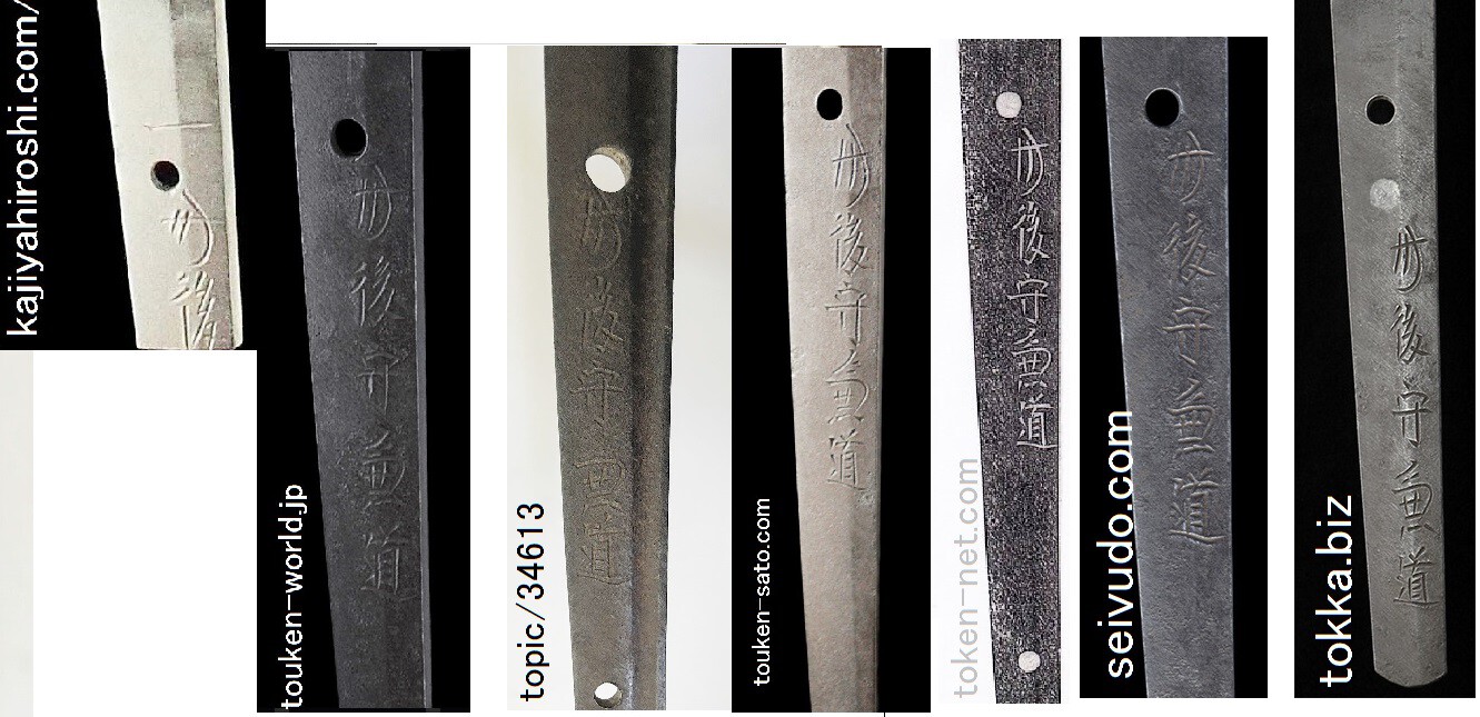

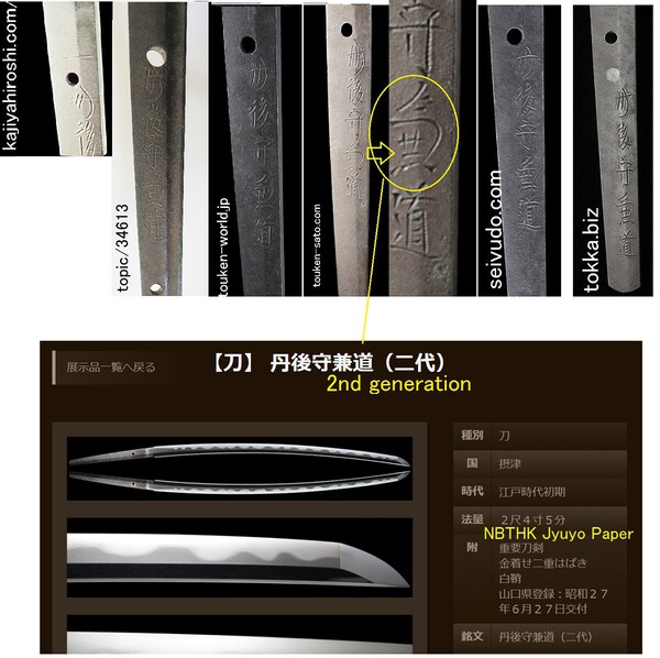

Yasaka Azuma Posted January 28, 2021 Report Posted January 28, 2021 Hello Bryce. The first generation of Kanemichi is in the style of Kanbun-shinto, and the second generation is in the style of Genroku-shinto. None of them are the revival of old-fashioned Katana. I picked up several types of Kanemichi's signatures online. With the sword of your topic in between, the left side is the first generation and the right side is the second generation. I couldn't determine which topic sword belonged to. Do you know the answer? 1 Quote
Jacques Posted January 28, 2021 Report Posted January 28, 2021 On 1/28/2021 at 11:14 AM, Yasaka Azuma said: Hello Bryce. The first generation of Kanemichi is in the style of Kanbun-shinto, and the second generation is in the style of Genroku-shinto. None of them are the revival of old-fashioned Katana. I picked up several types of Kanemichi's signatures online. With the sword of your topic in between, the left side is the first generation and the right side is the second generation. I couldn't determine which topic sword belonged to. Do you know the answer? Expand All are from the nidai except the one suriage I let you search and find which difference allows to identify the shodai (right oshigata) of the nidai (left oshigata) Quote

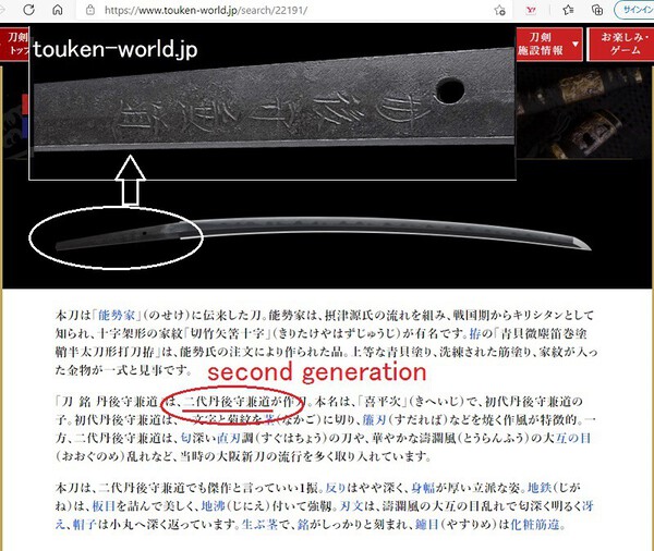

Yasaka Azuma Posted January 28, 2021 Report Posted January 28, 2021 Oh! s**t, I made a mistake. The source says it's second generation, and I should have put the image in the right place. I couldn't find a satisfying image of the first generation of Kanemichi. https://www.touken-world.jp/search/22191/ 1 Quote

Yasaka Azuma Posted January 29, 2021 Report Posted January 29, 2021 (I secretly fix it) Fujishiro's signature pictorial book is a good guidepost , but since it was edited 80 years ago, the actual thing that doesn't apply will come out afterwards. The publisher has revised it, but the current situation is that it cannot catch up. Bryce. There's a reason I've lined up the photos instead of Oshigata Kanemichi on topic / 34613 will talk assuming your katana. You may have noticed by looking at the image that your katana is peculiar compared to other tangs. It's rusting progresses, I can't see the traces of filing that should be there at the resolution of the image already uploaded. It may be fine while you own it, but I'm a little worried about the bad signs. https://www.touken-sato.com/event/katana/2012/08/K-kanemichi_2nd-01.html Quote
Bryce Posted January 30, 2021 Author Report Posted January 30, 2021 G'day Yas, With the blade in hand you can see the file marks on the nakago. The particular mei you have circled is subtly different from the others you have illustrated including mine. My sword has NBTHK tokubetsu hozon papers. I didn't realize that this smith had swords that had papered Juyo. Cheers, Bryce 1 Quote
