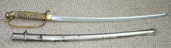

Kaiser21 Posted January 27, 2021 Report Posted January 27, 2021 This is my first posting on NMB so please forgive my lack of technical knowledge of this subject. I’m primarily an Imperial German collector but now that I’m retired, I’ve been dabbling in other areas that interest me. Just last week I picked up two Japanese swords through an on-line auction site. They come from the estate of a Captain who served with the British Army Royal Engineers during the campaign in Burma. I also picked up a Naval Gunto parade sword which is much better shape but with a factory blade in it. Pictured is an Army Kyu Gunto. It was badly stored as a result the scabbard has some significant rusting on one side but the saving grace is the blade was well oiled (for the most part) and only has one area of rusting. I suspect this sword, not being as "pretty" as the Naval sword nor having the look of a stereotypical Samurai blade was relegated to storage in the basement of the condo in which this gentleman lived on the waterfront. I was drawn to this sword by the two mekugi pegs on it on the basis of almost all the examples I found on-line had only one peg. I sensed this one was out of the ordinary. It also has a visible Hamon which is irregular which I hope indicates the blade was hand made. I managed to get the blade unmounted (without losing a finger) and it appears the tang is not signed. I have three questions for the experts. 1 - How should I go about removing the rust on the blade nearest to the Habaki? 2 – The blade appears to be unsigned. I have not touched any of the rusted areas. Can I assume that the blade was hand made? 3 – If the blade was hand made; with better pictures and dimensions etc. do you think it would be possible to narrow down it's date or place of fabrication? I find these blades quite interesting but I'm very early into the Learning Curve so any insights would be appreciated. I should say that this sword will be remaining in my collection for as long as my curation of it lasts, so no opinions will be posted beyond this forum. Quote
ChrisW Posted January 27, 2021 Report Posted January 27, 2021 That is because it is a traditionally-made Japanese blade (nihonto) that was fitted in kyu-gunto mounts. This is not uncommon, but nevertheless desireable! A good find even if mumei! (mumei is unsigned). Welcome to the NMB! As for the rust issues, you should follow the care-guide found here: http://www.nbthk-ab.org/swordcare.pdf Short answer is that you should not attempt to remove any rust yourself and let a professional togishi handle it. it would be helpful to the members here if you gave blade edge measurements as well as full-length pictures of the bare blade without any of the fittings. 1 Quote

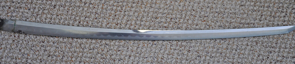

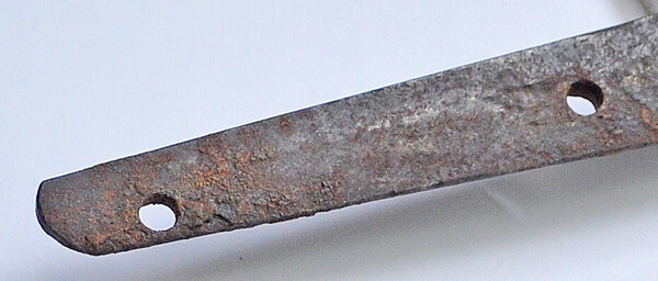

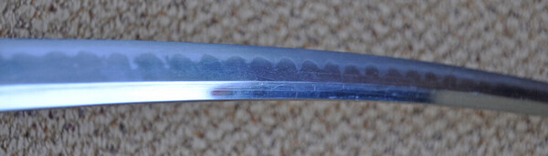

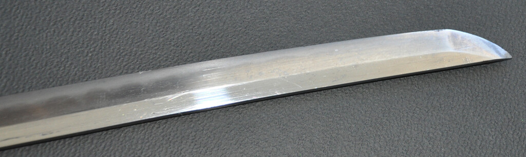

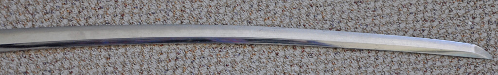

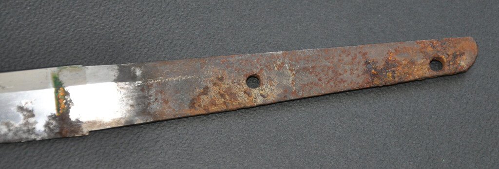

Kaiser21 Posted January 27, 2021 Author Report Posted January 27, 2021 So, I have taken some measurements as follows: The length from the notch in the Nakago to the tip of the Kissaki is 24 5/8 inches. The distance between the straight edge in image #2 to the Mune is 15/16 inches. Hopefully the attached images will be informative. Next five photos in my next post. Quote

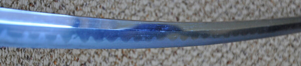

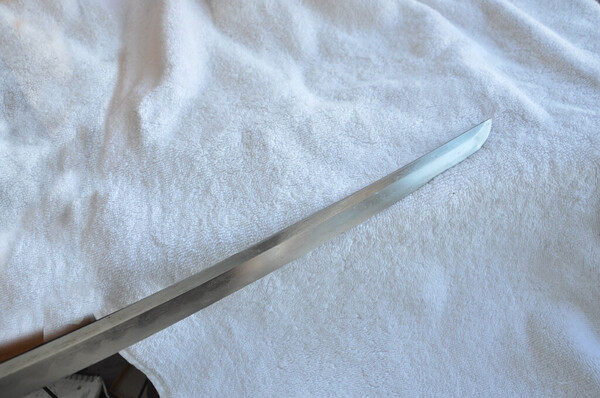

Kaiser21 Posted January 27, 2021 Author Report Posted January 27, 2021 Last five photos. If any additional/ better photos are required to help identify this sword let me know. Thanks in advance for looking. Steve N Quote

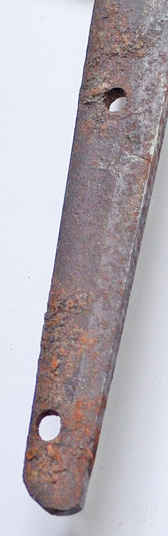

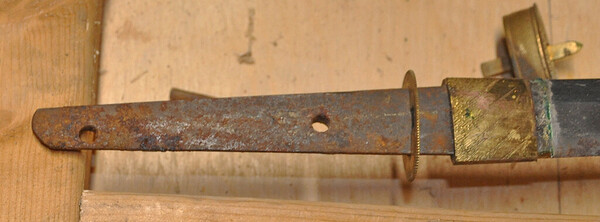

ChrisW Posted January 27, 2021 Report Posted January 27, 2021 My gut says mid 1800's on this blade, the patination on the nakago isn't too dark. If you want to address the red rust on the nakago, GENTLY take antler (deer/elk) and scrape it off. Black rust is good rust though, its stable and helps date the blade. As for any rust on the blade itself, I would just oil it and leave it be until it sees a togishi (if you want to spend the money to do so, it is pricey). Quote
French nihonto Posted January 27, 2021 Report Posted January 27, 2021 Nice find, from what I see a hamon gunome which loses in amplitude in this approach of the kissaki, I am of the same opinion as Chris. Any late edo, or possibly any early meiji. There doesn't seem to be any major flaw. On the other hand it seems to me even red rust on the site of the habaki, it is necessary to stabilize it. Quote
Kaiser21 Posted January 28, 2021 Author Report Posted January 28, 2021 Thank you both for taking the time to respond. I must say this is good news as I was taking a risk in bidding on this sword. I am a moose/deer hunter so finding a piece of antler was not an issue. I have gently removed the red rust from the nakago and near the habaki and re-oiled the blade. Are there any means of narrowing down the area where this blade would have been created? It is quite an attractive blade and having done a considerable amount of research on these blades over the past week, I have developed a clearer understanding as to why people find them so appealing. Again, I appreciate you having taken the time to provide your insights. Steve N Quote

Surfson Posted January 28, 2021 Report Posted January 28, 2021 As to area, I would suggest that it is Mino school based on the regular "pine tree" shapes in the hamon. If it were mine, I would probably take some ivory (like an old piano key cover - needs to be ivory that is fairly soft and doesn't have inclusions). You can gently rub off the active red rust prior to oiling it. Be very careful not to cut yourself! Nice blade by the way. 1 Quote

Surfson Posted January 29, 2021 Report Posted January 29, 2021 Steve, it hinges a bit on the condition of the tang. Was it shortened ever? How is the patina. It looks like it may be original, since the end is not cut straight off, but rather retains what may have been the original shape. But sometimes they will cut them off and round the end, so that is not absolute. It is also helpful if one can tell the patina of the steel in the tang, but the photos are not clear enough. If you can take some better photos of the tang that allow us to see the condition of the steel, the filemarks, the holes (whether drilled or cut by chisel) etc. we might be able to make a better guess. Quote

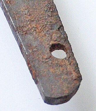

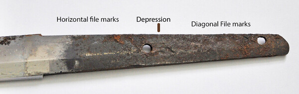

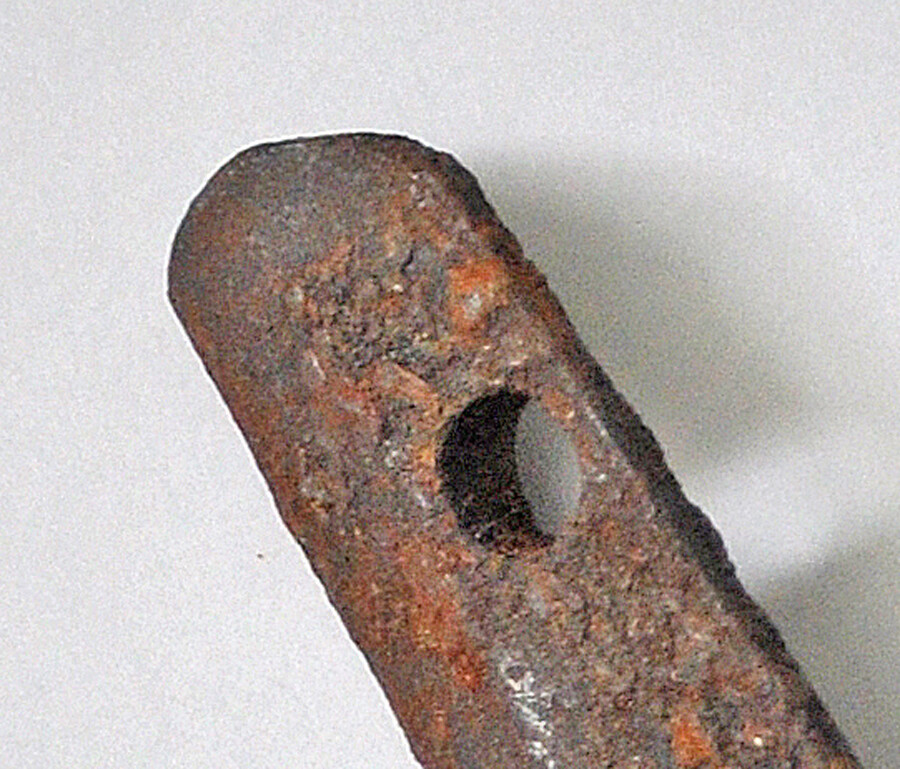

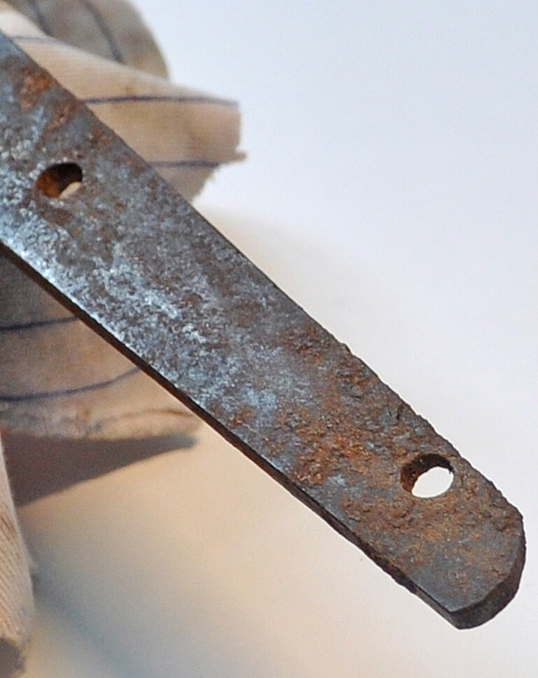

Kaiser21 Posted January 30, 2021 Author Report Posted January 30, 2021 Bob: I've done my best to improve the quality of the photos attached. Should the pictures not tell the tale then I can offer the following: Regarding the holes; I got my micrometer out and measured them. They are not circular. The one at the rear of the tang is visibly out of round. The diameter horizontally is 5.75mm and vertically 5.34mm. The one at the front is better, measuring 5.46mm on the horizontal and 5.31 on the vertical. The rear of the tang appears to have been filed into shape. There appears to be file marks but they are not very distinct. There are file marks running vertically on the Kissaki side of the front hole. They are hard to see without magnification. There are diagonal file marks on the section of the tang between the holes and the marks are canted towards the rear of the tang on the right side of the blade. I noted that there is a depression in the metal on either side of the tang just behind the front hole. More pictures to follow. Quote
Kaiser21 Posted January 30, 2021 Author Report Posted January 30, 2021 The balance of the pictures. Quote
ChrisW Posted January 30, 2021 Report Posted January 30, 2021 Could be much older than initially thought! The first set of pictures made the patination appear much lighter than these do. I would see if there's anyone in your area that could give an in-hand assessment. Quote
Surfson Posted January 31, 2021 Report Posted January 31, 2021 It looks like it has some nice old patina, but it also has a lot of severe active rust. If it were my blade, I would take some horn or ivory to the tang until I got as much of the active rust off that can be readily removed. Although some may disagree, I would then likely rub in a little choji oil on it with a soft cloth to stabilize it. 1 Quote
Kaiser21 Posted January 31, 2021 Author Report Posted January 31, 2021 The active rust issue was pointed out to me earlier in this thread. I did use a piece of deer antler to remove some of the red rust but I guess the "don't mess with the tang" message has me erring on the side of caution, perhaps too much so. Quote
Surfson Posted January 31, 2021 Report Posted January 31, 2021 My reasoning in these cases is that if I don't remove the active rust, the rust will mess with the tang even more. Quote
Kaiser21 Posted January 31, 2021 Author Report Posted January 31, 2021 Bob: I agree with your reasoning. I guess I'm hesitant for fear of taking too far. Once done it can't be undone. Quote
