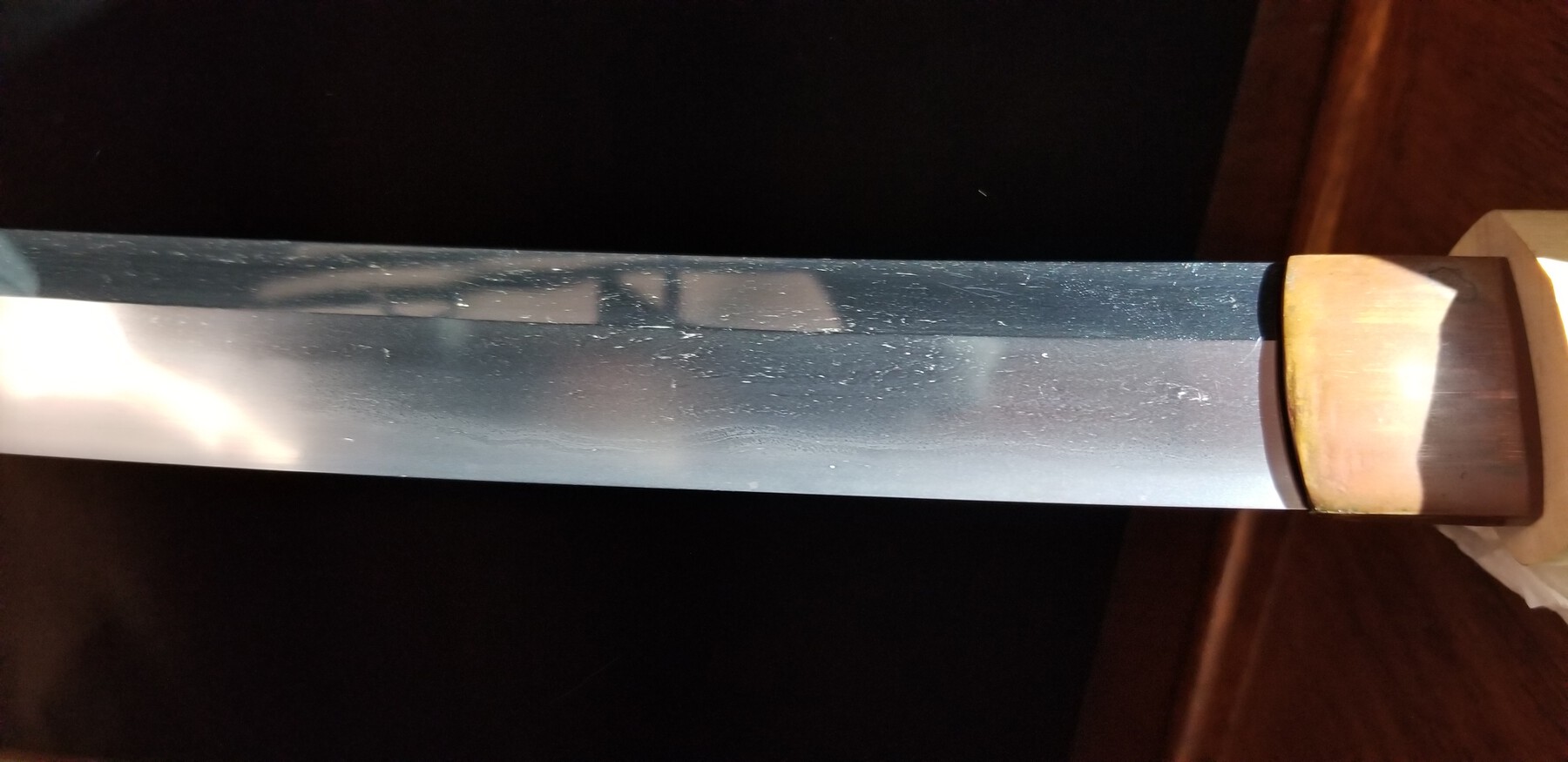

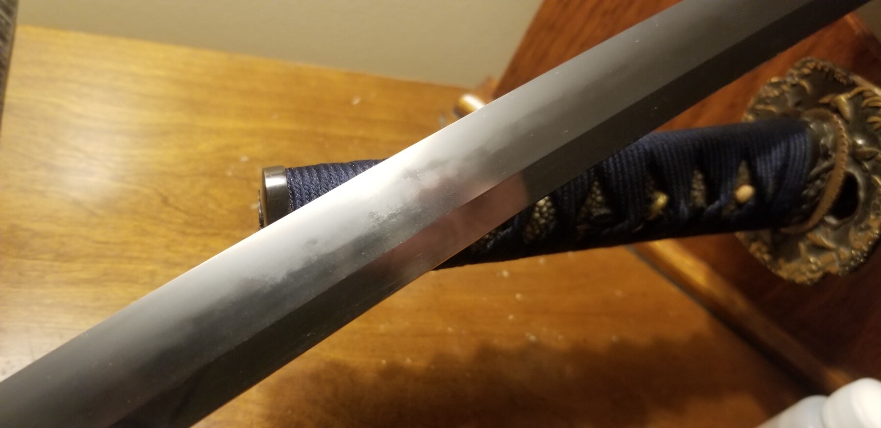

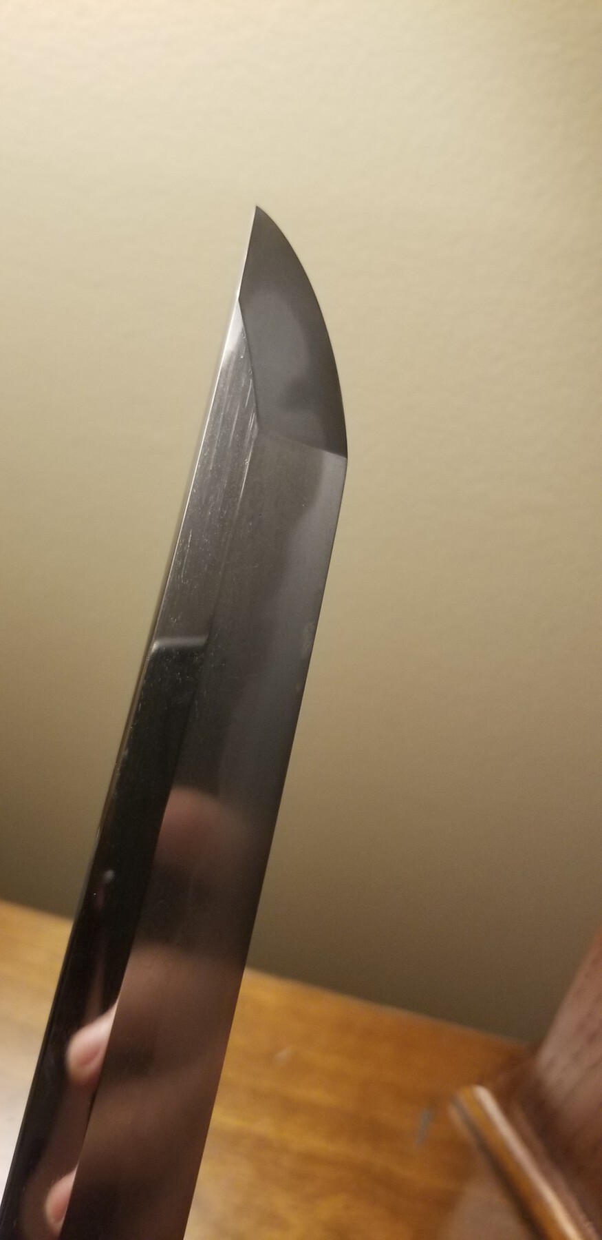

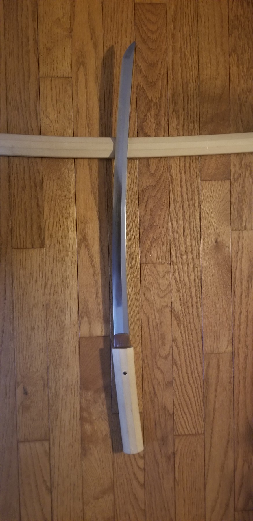

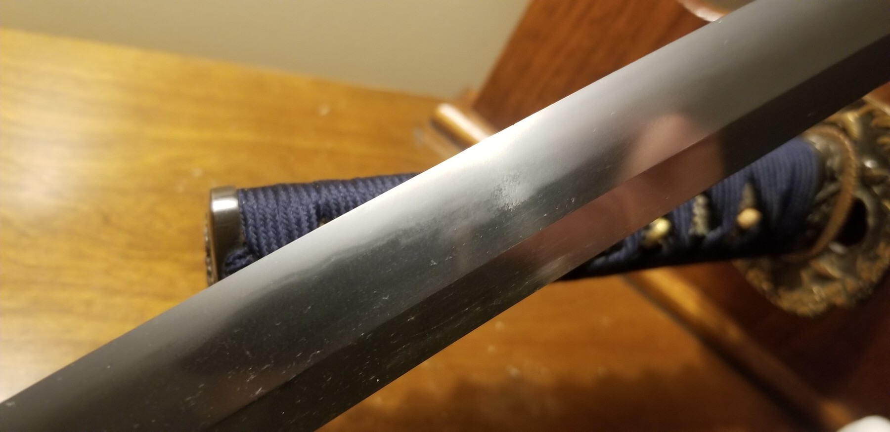

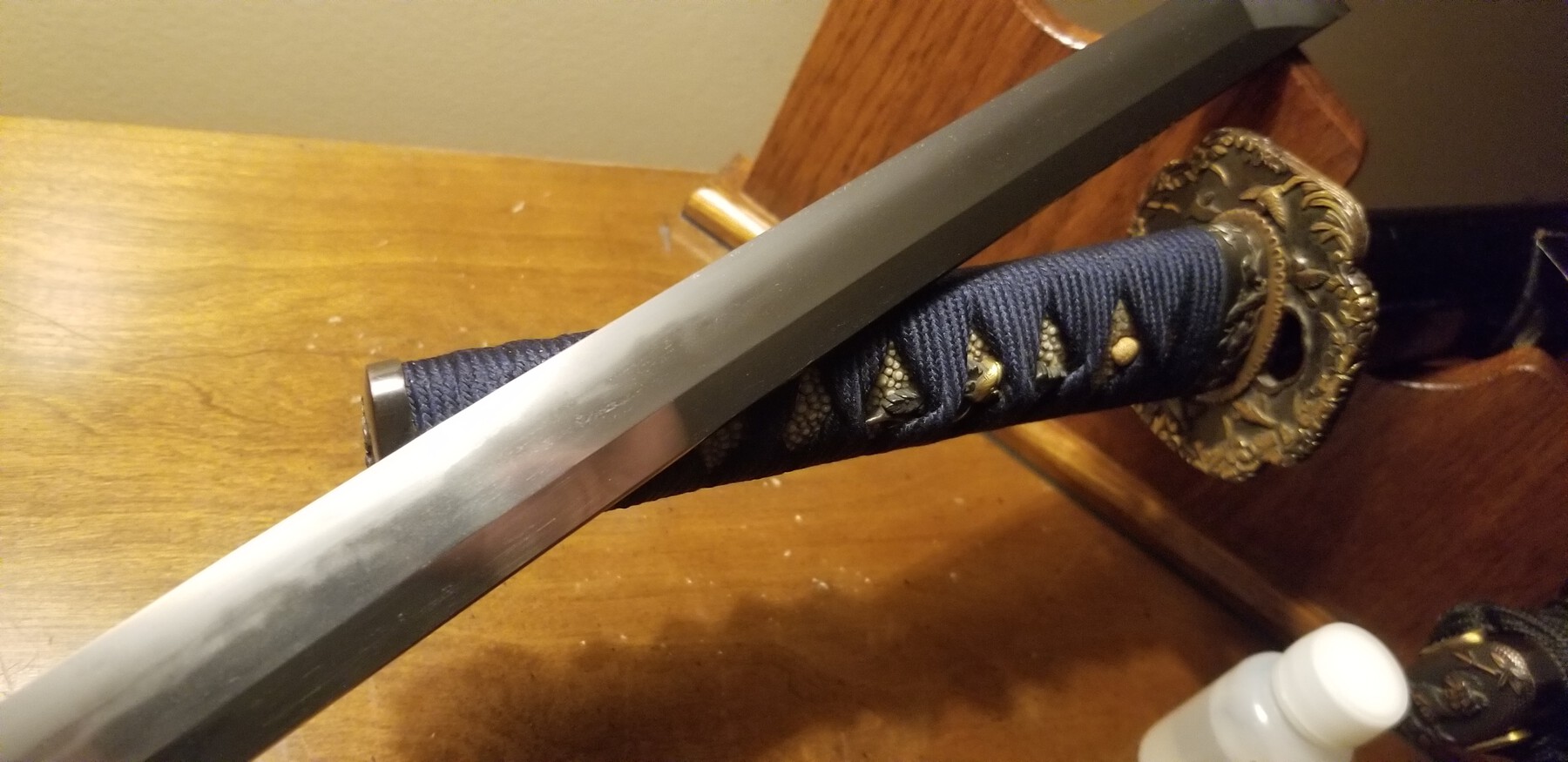

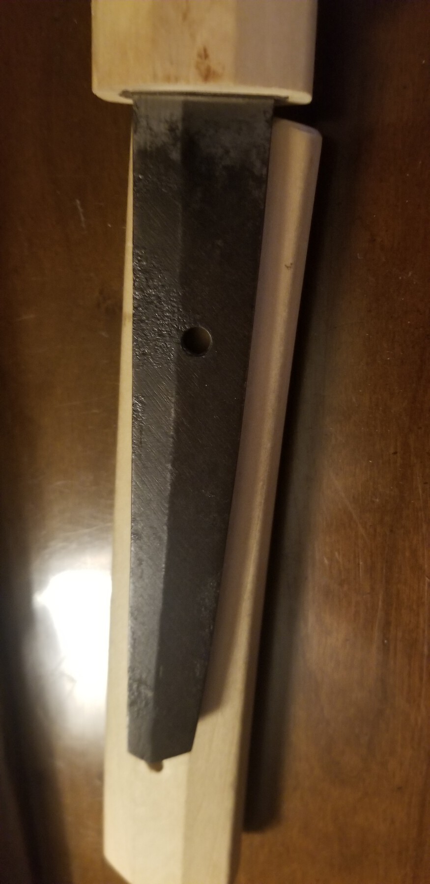

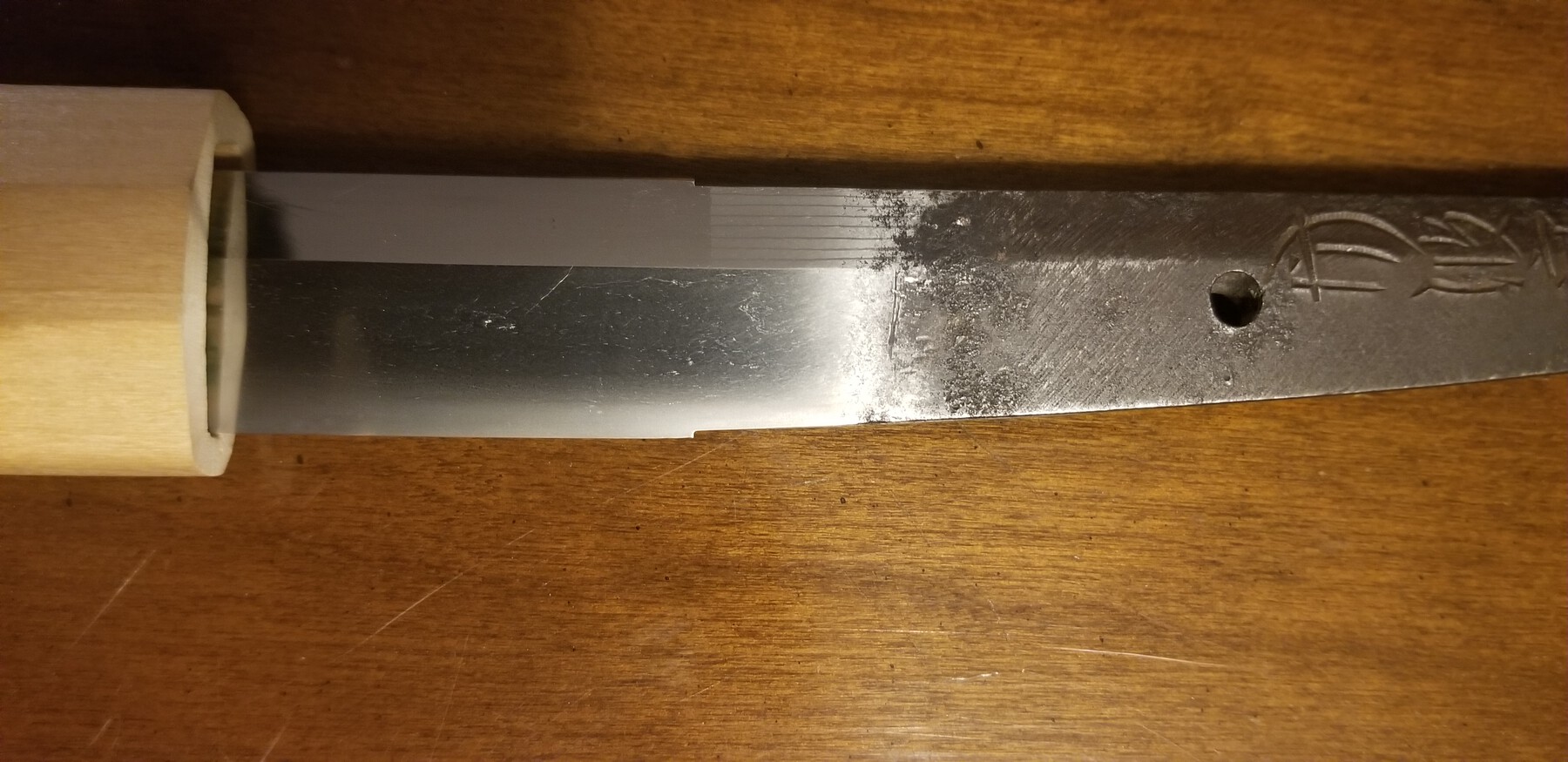

Hanito Posted January 26, 2021 Report Posted January 26, 2021 My first nihonto. I would like to see what you all think of it any guesses towards the age and maker and why before revealing the mei (no cheating). It came in shirasaya with its koshirae, unfortunately the koshirae didn't belong to the blade (hole almost an inch off). I'm in the process of seeing if its worth it to get a new handle or get the old one re-drilled and also a new tsunagi-habaki made as it was cracked. I am curious if anyone believes this sword is worth submitting to shinsa? I am not great at capturing the beauty of the sword on camera and if needed I can take more photos. So any guesses??? PS: More information upon request Quote
Mark S. Posted January 26, 2021 Report Posted January 26, 2021 Tamba No Kami Yoshimichi Osaka Mishina school Shinto I’m not good enough to know which generation Yoshimichi. 2 Quote
Rivkin Posted January 26, 2021 Report Posted January 26, 2021 Hard to vote without hedging. My first choice would be late Muromachi Soshu influenced. Most likely Uda Kunimune. Distant second is shinshinto, somebody slightly junior, like second generation Naokatsu or lesser Satsuma smith. Would appreciate seeing sugata though. Quote
sabiji Posted January 26, 2021 Report Posted January 26, 2021 50 minutes ago, Mark S. said: Tamba No Kami Yoshimichi Osaka Mishina school Shinto I’m not good enough to know which generation Yoshimichi. I think Sandai or Yondai 1 Quote
Rivkin Posted January 26, 2021 Report Posted January 26, 2021 I have to admit gentlemen you are probably right. Later generation Tamba no kami Yoshimichi is a good match. 1 Quote

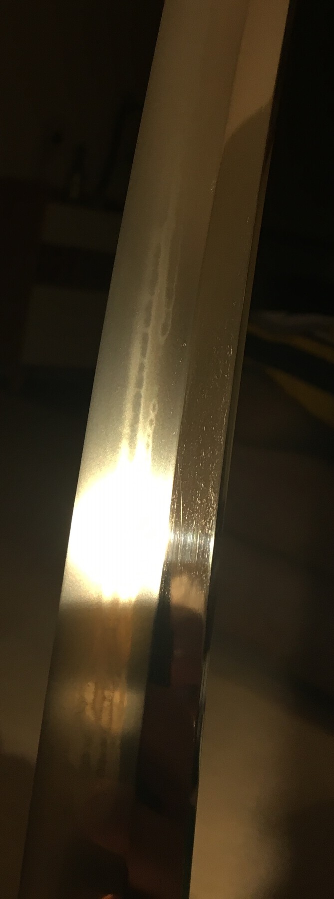

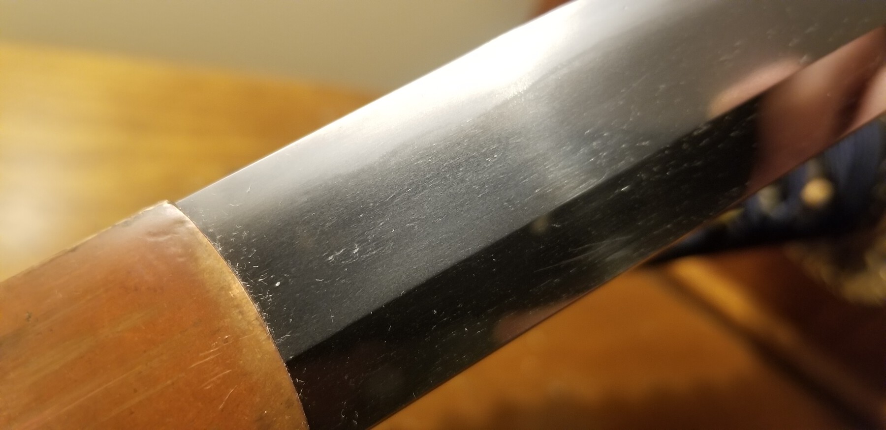

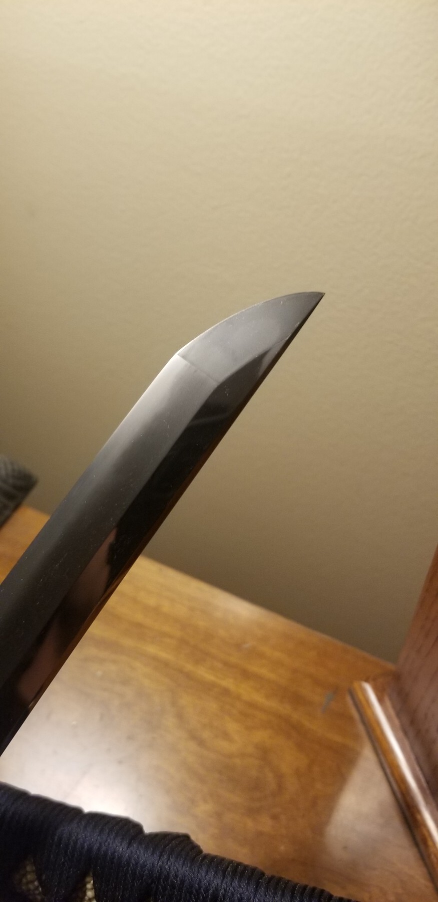

Mark S. Posted January 26, 2021 Report Posted January 26, 2021 10 hours ago, Hanito said: ....maker and why... Ahhh... the 'why'. For me, it started with the tell-tale sign of the "Tamba ball" in the boshi... usually a very clear sign of the Osaka Yoshimichi school. Once again, not sure about generation. In almost ALL cases, to use one identifying feature is NOT the proper way to kantei. But that ball in the boshi is usually a dead giveaway and leads to looking for other specifics. The sudare-ba-like hamon helps back up the kantei to Osaka Yoshimichi school... although, the pictures and/or polish do make the hamon seem a bit 'misty' or 'muddy'? Usually (and I use that term cautiously), sudare-ba is much more 'distinct' (see attached images), although not a rule. Others may correct me, but I think earlier generations were less distinct and the more distinct sudare-ba evolved with later generations. There were many variations of sudare-ba. This is NOT a criticism or downgrading your blade or your photography skills. Sometimes details are VERY difficult to photograph and can only be seen in the right light and in hand. Just to be sure... you will see both Tamba and Tanba used in reference to these blades. 2 Quote

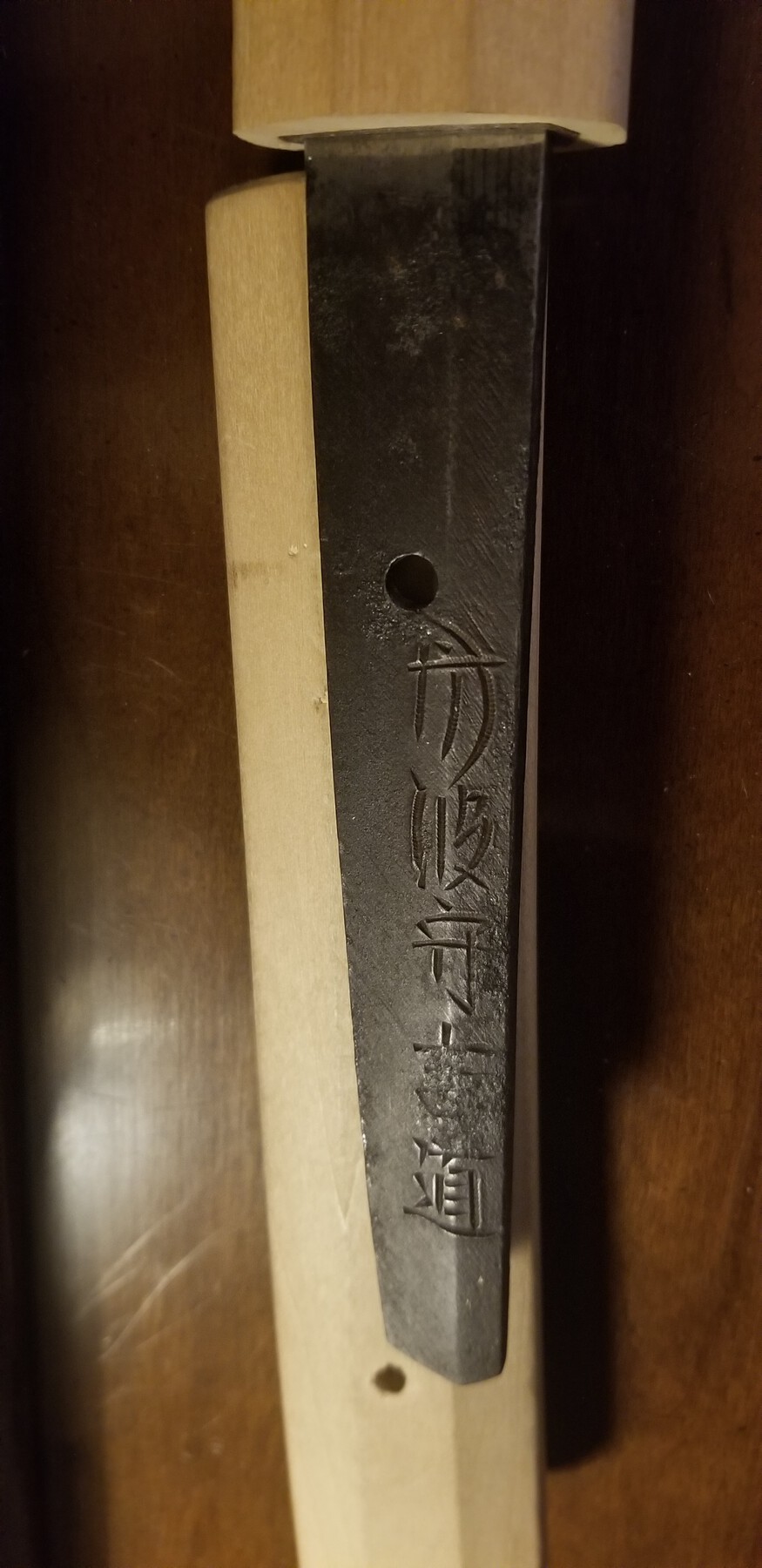

Hanito Posted January 26, 2021 Author Report Posted January 26, 2021 I will post pictures of the nakago later today/tomorrow. While picture quality is a combination of an old phone camera, bad lighting, and sub par photography skill. The lines are much sharper under natural light with the naked eye but until some professional shots (sibling discount) I cannot provide much better. Mark S- That is a very nice blade. I will try get some better pictures of the hamon but it doesn't look like mine has that pronounced sudare-ba hamon as your pictures show. Quote
Hanito Posted January 27, 2021 Author Report Posted January 27, 2021 Many great guesses, and many winners, congrats! I have much to learn. Can anyone figure out the generation? Now for the big question, would you pay for shinsa if you owned this blade? Quote
Jacques Posted January 27, 2021 Report Posted January 27, 2021 It's the Osaka sandai and at first glance mei seems legit. Quote
sabiji Posted January 27, 2021 Report Posted January 27, 2021 9 hours ago, Hanito said: Many great guesses, and many winners, congrats! I have much to learn. Can anyone figure out the generation? Now for the big question, would you pay for shinsa if you owned this blade? Why? It looks like a duck, it walks like a duck, it quacks like a duck, why then necessarily confirm that it is a duck. Better invest the money in the next piece. 1 1 Quote

Japan2112 Posted February 10, 2021 Report Posted February 10, 2021 I wouldn't submit it to NBTHK Shinsa due to the expense and unpredictability of international shipments in present days. In August the SF Token Kai has its show that may give you an option. The sword and mei, though, looks shoshin to even a semi experienced eye like mine. It's sandai Yoshimichi hamon is unmistakeable and there are plenty of references to compare that well carved mei. Nice sword. Quote
