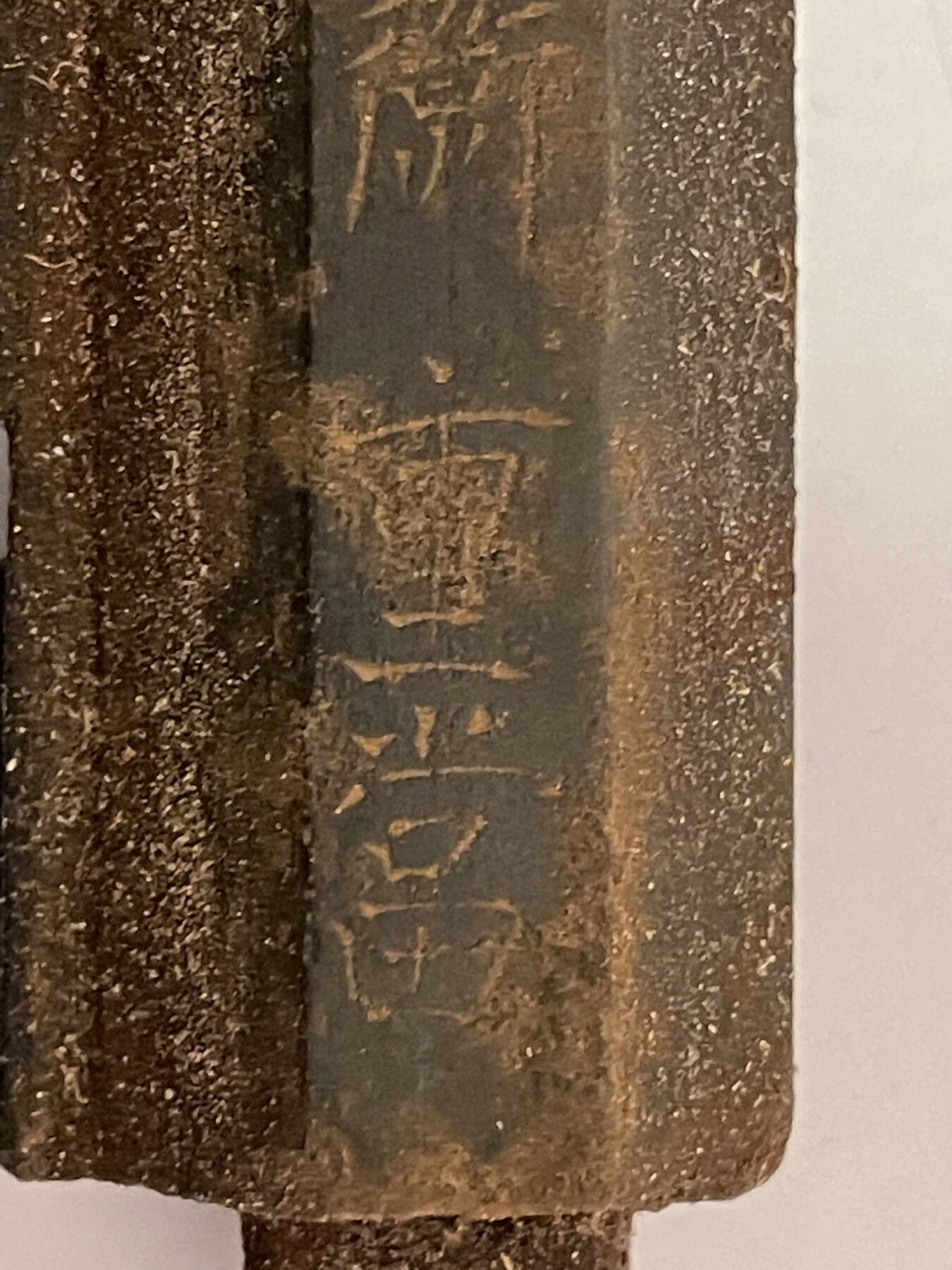

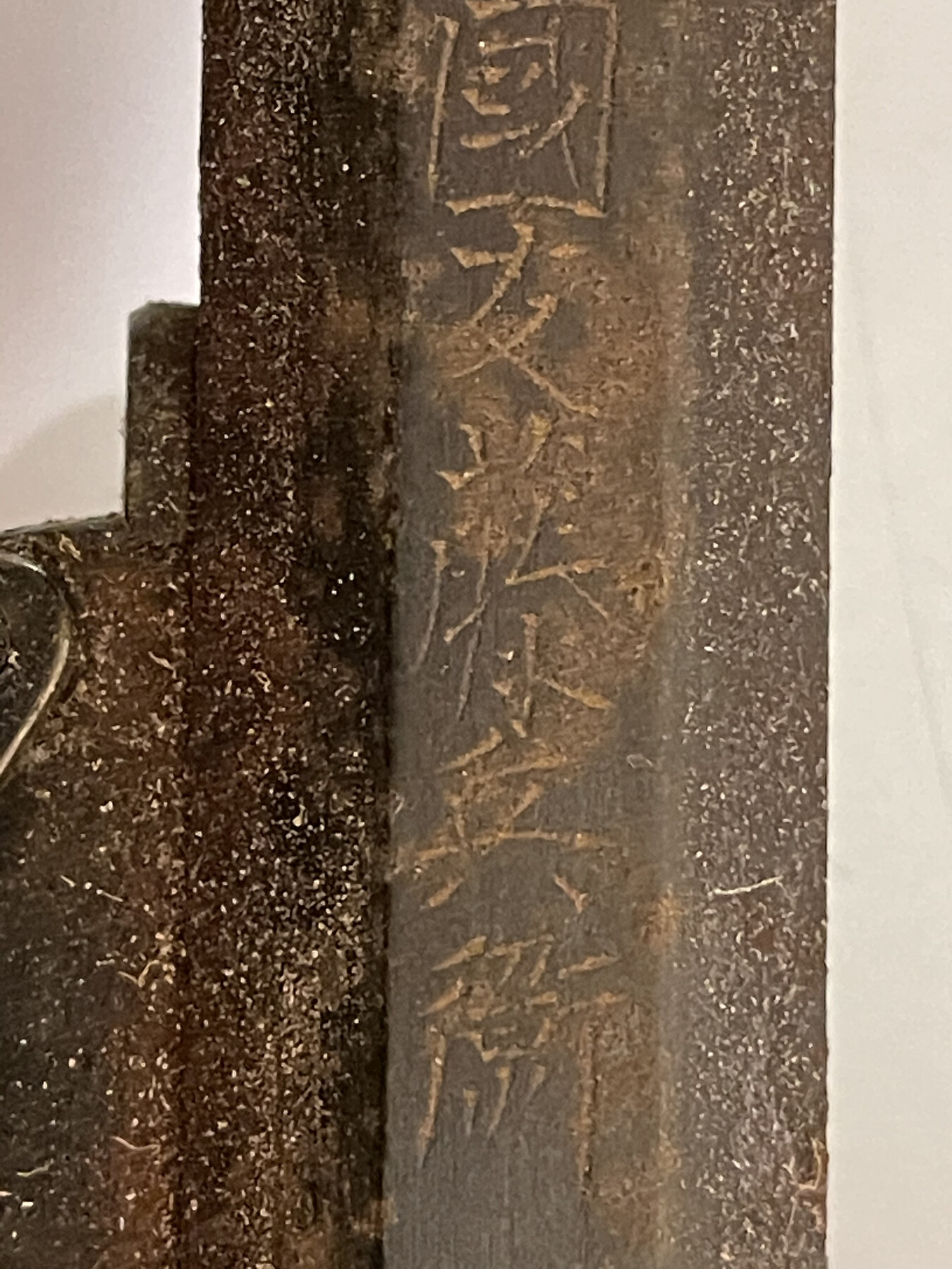

Now I have managed to open my Teppo. It was very hard at first. No one has opened it in many years. I found a signature and hope someone can interpret it for me. I do not know if the pictures are upside down but I hope you see it.
All information about this Teppon is gratefully received
// Robert
Generally we read 江州 as Go-Shu when it refers to Ohmi Province.
Of the many people I have asked, no-one professes to know how to read the last two characters, Steve. I have heard both 'Shigeto' and 'Juto', but in old texts I have seen Choto, and privately I lean towards the latter as being originally correct. Someone told me that it meant 'able to hit the spot repeatedly', (whether a target or a manufacturing standard?)  but that may be apocryphal.
 Choto was a title rewarded originally by the Emperor Ogimachi'in (abdicated 1586, died 1593) to Oda Nobunaga and the four Kunitomo Toshiyori in the late 1500s. Translation of 重當 as Choto I found in Olof Lidin's Tanegashima, p.136. from the Teppoki.
Steve, I had to go back and check. See above!
Quite a bit is known about Kunitomo Tobei who was the first in a long line of Kunitomo Tobei smiths. A gun of his is recorded from Keicho 15.
He carried the title of 年寄脇 Toshiyori Waki, or assistant Toshiyori, and was said to be the third son of one of the original first four Toshiyori, Sukedayu.
