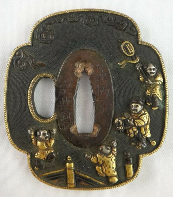

JohnTo Posted January 17, 2021 Report Posted January 17, 2021 I have written this post as an aid to tsuba newbies, like myself, who may buy Nagoya-mono tsuba while mistaking them for Mino Goto shakudo tsuba. Examples of Nagoya-mono tsuba have been discussed many times on the NMB and I offer this post as a collation of examples from what I believe is a single workshop. Nagoya-mono (alternatives Nagoyamono or Nagaoya mono) literally means ‘Nagoya object or thing’, i.e. something from Nagoya. Sometimes they are called ‘shiiri-mono’; literally ‘thing off the self, or stock item’. There are various types of Nagoya-mono and this post is a collation of the wakizashi size, mokko shaped soft metal tsuba that superficially resemble Goto workmanship that I believe were produced in the same workshop. I must declare at the outset that I am not an expert on the subject and the notes below are based upon my observations and what little information I have been able to glean from the literature. So please feel free to correct and comment. I first came across these tsuba two years ago when two were offered for sale at a large London auction house and catalogued as ‘Mino Goto shakudo’. Fortunately, a slow internet failed to register my over the top winning bid. A couple of months later I purchased two (a lot cheaper) as part of a mixed lot and others keep popping up in online auctions both in the UK and abroad, including Japan. This prompted an interest (though not a love) in these tsuba and a concern that they were being (possibly inadvertently) advertised as more desirable Mino Goto tsuba. For example, there is a tsuba of this type to which has been added a ‘Soten’ signature on Ebay for over £2000! The general features of these particular Nagoya-mono are: 1 Mokko shape and wakizashi or small katana size size (my two are 6.8 x 6.1 cm). 2. Although looking like shakudo, the metal is probably nigurome, an alloy of katashirome (tin and lead) and copper, which only becomes shakudo after gold (3-7%) has been added (Christies Compton collection description). Whether this is true nigurome, i.e. the base alloy for shakudo, or a similar alloy better suited to casting and patination I cannot say. 3. The colour of the body (ji) of the tsuba resembles the blue black of shakudo but lacks the depth of colour and often has a brown tinge to it. The seppa-dai is always chocolate brown in the ones that I have seen. 4. The ji is not perfectly flat, as in Goto works, but often shows shallow undulations caused by uneven casting. 5. The nanako finish is not great. I thought that it was probably cast rather than made with a punch. However, comparing the nanako on one of my tsuba with that of a photo (on-line) of an identical tsuba showed differences. This may indicate the nanako was applied by hand (using a punch), or from using different moulds when casting the tsuba. 6. The mimi and hitsu ana are usually surrounded by a gold gilt finish that initially looks like regular nanako, but on closer examination looks like a lizard skin, i.e. shallow and with bigger oval spots (see pic). 7. Most have a single kodzuka hitsu ana, but some have both kogai and kodzuka hitsu ana. 8. Silver and gold gilding looks as if it has been applied by painting with a mercury amalgam and then heating to vaporise the mercury. I have not seen any evidence of gold foil peeling off the tsuba. I conclude that although cast, individual tsuba are finished and decorated by hand. I have not seen seams from the mould either, unlike cast iron tsuba. 9. Lastly, these Nagoya-mono tsuba have a characteristic pattern of ten punch marks around the nakago ana, viz: three at the top, two on each side at the bottom and three along the bottom. These differ slightly in position, so were evidently made individually and some have been altered. I think that these were quality control marks to indicate they were deemed good enough to sell. As soon as I see these I want to shout ‘Ah, another tsuba from Mr Suzuki’s workshop.’ Note: I don’t actually know the name of the workshop owner. So, who originally bought these tsuba? I don’t think it was tourists (Japanese or European) as has been suggested. There were few in the Edo period. Poverty and starvation were rife in the 17th and 18thC, so they may have been bought by poor samurai or by wealthier wannabe merchants, who were allowed to wear short swords. A bit of bling to wear on Saturday nights maybe. Many men throughout history and throughout the world have woken up after a night on the town only to find that they had ‘mislaid’ their money, valuables and sometimes their clothes. A wise man would leave his valuables at home. Although dismissed by many on the NMB, I see no reason why a collector should not specialise in Nagoya-mono, especially if they are not wealthy enough to buy genuine Goto works and have no interest in ‘bits of old iron’. However, some of the ones I have seen for sale have gone for over £300/$400, which I think is way too much! There are plenty to study in addition to those from Mr Suzuki’s workshop. So here is my collection of 16 designs (there are others) that I have come across in the last few months, all apparently from ‘Mr Suzuki’s workshop’. Two of them are mine (they were just included in job lots, honest!). I have also included a picture of the ‘lizard skin’ nanako on the mimi of one of mine for reference. 1. Takarabune (treasure ship) with the character Hoo (treasure) on the sail. This tsuba is mine 2. Chrysanthemum, birds and fence. This tsuba is also mine 3. Flowers in basket on wheelbarrow 4. Tadamori catching the oil thief 5. Man chasing snake 6. Pagoda and water wheel 7. Shishi 8. Ho-o bird on branch 9. Chrysanthemums 10. Meadow flowers 11. Five Chinese sages 12. Thatched hut scene 13. Two deer and flowers 14. Dragon 15. Lady Murasaki Shikibu writing 16. Peacock Regards, John (just a guy making observations, asking questions, trying to learn) 11 2 Quote
JohnTo Posted January 17, 2021 Author Report Posted January 17, 2021 I am adding these two examples of Nagoya-mono style tsuba to my post separately as I don’t want them mixed up with examples from Mr Suzuki’s workshop. They are also from my collection. The first is a really awful example of a cast tsuba that appears to be identical to my example #9 in my original post. The casting is bad and the black patina looks like paint. In addition the punch marks are missing from the nakago ana, so maybe its one of Mr Suzuki’s rejects that someone else finished! The second example is similar to example number #3, flowers in a basket on a wheelbarrow, but there are significant differences in the design that show it not to be cast from the same mould. This represents one of the superior examples of Nagoya-mono. Unlike the typical examples from ‘Mr Suzuki’s workshop’, the punch marks around the nakago ana are different. In addition the patina of the metal looks a bit more like shakudo, so perhaps there is some gold in the mix. There were good examples Nagoya-mono tsuba in the Compton Collection. So, if they are good enough for him to have collected….. I hope that this shows that not all Nagoya-mono tsuba were cheap Goto knock offs, some were quite good but others were awful. Regards, John (just a guy making observations, asking questions, trying to learn) 10 1 Quote

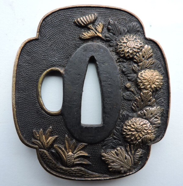

Rich S Posted January 17, 2021 Report Posted January 17, 2021 I have two examples to contribute: Both I'm pretty sure are Nagoya. Neither have the goldish nanako rims, so I assume later (tourist) production. Rich Quote

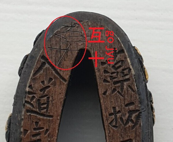

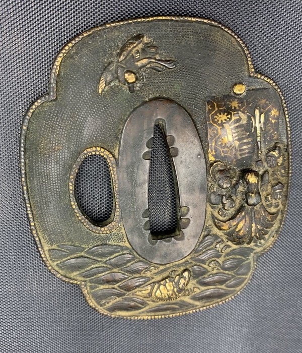

hobnails Posted January 18, 2021 Report Posted January 18, 2021 Hi here is one i have, it came on a tanto, with the fuchi and kashira Quote
Spartancrest Posted January 18, 2021 Report Posted January 18, 2021 Is that a signature on the fuchi? Any idea what it says? Got to love those punch marks around the Nakago-ana! Quote

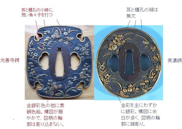

Yasaka Azuma Posted January 18, 2021 Report Posted January 18, 2021 Japanese collectors (maybe just self satisfaction?) think of the difference between mino and kozenji as an image. If it wasn't made in Shakudo, it wouldn't be considered non-mino. A kiwame called kyo-kanagushi, which suddenly appeared in NBTHK's treatise, confused or resented collectors. But it is accepted with giving up. The left side is kozenji (Nagoya), and the right side is mino in the late Edo period. https://twitter.com/yakozen777/status/1230979387144560640 1 Quote
hobnails Posted January 18, 2021 Report Posted January 18, 2021 Hi Dale the fuchi is signed But i don't know what it says. Quote

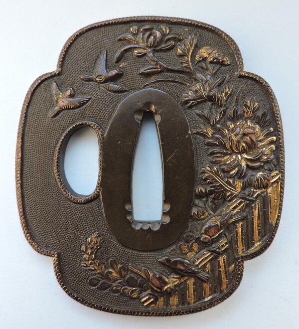

Spartancrest Posted January 18, 2021 Report Posted January 18, 2021 What do people think of this one https://www.jauce.com/auction/q429663081 Is it like those posted above by Rich? Mino work or Chinese fake? The Mei is cast in, so may be unrelated to the style. No nanako on the rim surface. [never been mounted either despite the punch marks] Quote
Steves87 Posted January 18, 2021 Report Posted January 18, 2021 1 hour ago, hobnails said: Hi Dale the fuchi is signed But i don't know what it says. I cant read it either, but from memory there is some typical Soten Kanji in it Quote
Yasaka Azuma Posted January 18, 2021 Report Posted January 18, 2021 When I looked closely, I noticed that the chicken scratch says "互十". If the number is 50, write "五十". "互十" is a Buddhist term for "十界互具", that is, the Mutual possession of the Ten Worlds. 3 Quote
Spartancrest Posted January 18, 2021 Report Posted January 18, 2021 One of Rich S. examples here - a bit blurry! https://www.ebay.com.au/itm/Tsuba-Sukashi-Edo-antique-vintage-rare-samurai-sword-katana-yoroi-Ancient-art/284151681690?hash=item4228c2929a:g:7FQAAOSwZZFgBR0T Quote
JohnTo Posted January 18, 2021 Author Report Posted January 18, 2021 Hi Steven, The signature on your fuchi says Soheishi (Mogarishi) nyudo Soten sei. But I would not take much notice of it. Here is a tsuba with his 'signature', currently for sale at over £2000. But it looks like Mr Suzuki's 'signature' has been obliterated! Thanks for the additional example of Mr Suzuki's work. Best regards, John Quote
JohnTo Posted January 18, 2021 Author Report Posted January 18, 2021 Ooops, Sorry Chris, Getting names mixed up while rushing around. This is the first time that I have seen one of these tsuba actually mounted on a sword or tanto. It would be very interesting to see a picture of the tanto koshirae and blade. Best regards, John Quote
Rich S Posted January 18, 2021 Report Posted January 18, 2021 Dale Glad to know my tsuba isn't totally worthless That's more than I paid for mine. Rich 1 Quote

hobnails Posted January 18, 2021 Report Posted January 18, 2021 Hi John will dig it out when i get home from work and take a photo i suspect its been thrown together Quote
hobnails Posted January 19, 2021 Report Posted January 19, 2021 Hi John here's some pics of the tsuba mounted. 1 Quote
