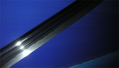

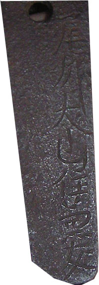

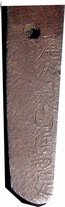

Sergei Posted December 11, 2008 Report Posted December 11, 2008 Dear Sirs, my name is Sergei from München. I come to this forum as I receive a Samurai knife in my family but do not know what is says. I hope anybody can help me please let me know what it say. Here is picture for you. Thank you for writing. Yours, Sergei Quote
Stephen Posted December 11, 2008 Report Posted December 11, 2008 Bishu Inuyama ju Kanetomo im sure we'd all like to see the rest of the Tanto Quote
Sergei Posted December 11, 2008 Author Report Posted December 11, 2008 Dear Stephen, thank you for telling me. Do you know is this old Samurai knife from good maker? Sincerly, Sergei Quote
Stephen Posted December 11, 2008 Report Posted December 11, 2008 if its his yes, the date i found and i may be wrong is from around 1596, to see how well he did we'd like pix of the full blade, nice shot of the tip and any grain pattern that you can photo. Quote

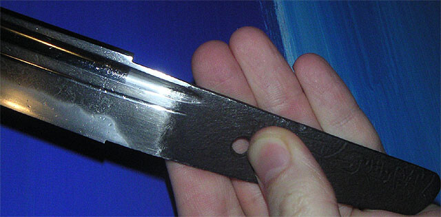

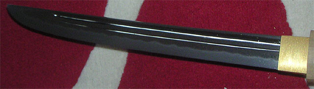

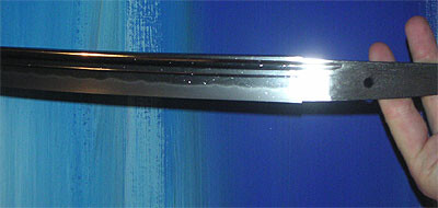

Sergei Posted December 11, 2008 Author Report Posted December 11, 2008 Here I take more fotos for you. It has wood handle and scabbard. Yours, Sergei Quote
Stephen Posted December 11, 2008 Report Posted December 11, 2008 looks good so far, one more please of the full blade sans handle and habaki, one note, looks like someone used metal polish to shine the blade...may be the light on the photo....if that the case be sure to just use a light oil, not to heavy of a coat. Quote
Jacques Posted December 11, 2008 Report Posted December 11, 2008 Hi, I'm wondering Tomo 友 or Yoshi 女 ? Looks more Tomo Quote
Nobody Posted December 11, 2008 Report Posted December 11, 2008 I am still a little unsure about the last kanji. But the mei could be 尾州犬山住兼安 (Kaneyasu) ? Quote

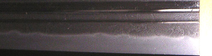

Sergei Posted December 11, 2008 Author Report Posted December 11, 2008 Here I take more fotos for you. Quote
Bugyotsuji Posted December 11, 2008 Report Posted December 11, 2008 I am still a little unsure about the last kanji. But the mei could be 尾州犬山住兼安 (Kaneyasu) ? I would agree with Nobody here, except for the last kanji which looks so much like 女. *There was a (koto) Kanechika 兼女 but from 美濃 *There was a 慶長Keicho era 尾州犬山住金友 Kanetomo, same person as 金伴、輝広 Quote
Sergei Posted December 11, 2008 Author Report Posted December 11, 2008 Dear Sirs, I am puzzled now. There seems to be so many different names!? Do I need to send you better foto of the writing? How old you think it is? Thank you for your helping this. Sincerly, Sergei Quote

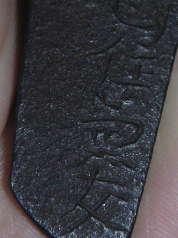

Bugyotsuji Posted December 11, 2008 Report Posted December 11, 2008 Hello Sergei, The very bottom Kanji is proving difficult to read. You could try taking a close-up of this one Kanji from a couple of different angles, and it might help if you are happy to do so, (not that there is anything wrong with the photos you have already provided)... If the Mei is genuine, and not Gimei, then that might give us an idea as to the age of your blade. Quote
Brian Posted December 11, 2008 Report Posted December 11, 2008 The "Inuyama" is the key here I think. I can find a mention of a Inuyama Kanetomo as Stephen pointed out, but not for the other readings (haven't checked much as I am at work) I think it is between Kaneyasu and Kanetomo and I do lean towards Kanetomo. What listings are there for these smiths signing with Inuyama? (if that is the correct reading) Brian Quote

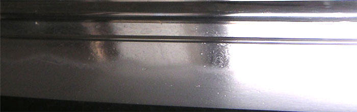

Sergei Posted December 11, 2008 Author Report Posted December 11, 2008 Here is more fotos of it. Thank you all. Quote
Grey Doffin Posted December 11, 2008 Report Posted December 11, 2008 A search of my index for listings containing "Inuyama" gives us 3 smiths who signed with the 1st Kanji Kane: Kanetake 兼武, Kaneuji 兼氏, and Kanewaka 兼若. I don't think any of these fit the last Kanji on the tanto in question. Grey Quote
Bugyotsuji Posted December 11, 2008 Report Posted December 11, 2008 Thanks Sergei, that's great! PS The Toko Soran lists the Inuyama Kanetomo 兼友 on p. 85 (see earlier post). The date is given as Keicho. Quote
John A Stuart Posted December 11, 2008 Report Posted December 11, 2008 I still think Kaneuji when you consider the second horizontal stroke is abreviated. John Quote
Sergei Posted December 11, 2008 Author Report Posted December 11, 2008 Maybe this a maker where there is no documentation? The blade looks very nice and good condition so I think it is not old but for the end where there is rust.? Quote
John A Stuart Posted December 11, 2008 Report Posted December 11, 2008 Leaving the mei aside this is a wonderful sword. It has great horimono, is in a fair polish and has an interesting look. I'm sure it is a koto era sword (over 400 years old) and the patina on the nakago is part of the reason to attribute it so. Just in case you are not aware of it, do not clean or polish etc. the nakago (tang). It is crucial it remains as is. You are lucky to have such a nice example. John Quote
Bugyotsuji Posted December 11, 2008 Report Posted December 11, 2008 Just playing now, but other possibilities are Kane 及 -chika, or Kane 戌 -ochi, -etsu. (masakari) Quote

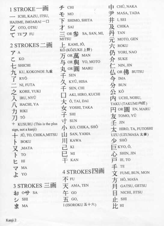

Stephen Posted December 11, 2008 Report Posted December 11, 2008 Grey check Hawley Kan 2547...also the four stroke count for tomo mid right column, ? stroke to the right insted of the left on the top of inter top stroke to the left...if that makes a diff. Quote
Brian Posted December 11, 2008 Report Posted December 11, 2008 I'm still going with Kanetomo as Stephen said. Not hard to see the "tomo" kanji if you consider the one stroke as abbreviated...commonly done with different smiths. This is backed up by the fact that Hawley's lists 2 Kanetomo signing this way. KAN2547 (changed his name to Teruhiro, worked ca. 1596 and worked in Aki) and also KAN2569 who worked ca. 1592, Mino, Owari. Both signed Bishu Inuyama ju Kanetomo. First is 50 points and the next 15 points. At any rate, the dates would fit in with the appearance, and it does look like a nice blade. Care for it well, and do some research on how to preserve it. Regards, Brian Edit to add: Pity no pic, he is mentioned here: http://www.artfact.com/auction-lot/a-nagamaki-wakizashi-early-edo-period-circa-1600-1-c-ohwwiwgglv Quote

Stephen Posted December 11, 2008 Report Posted December 11, 2008 Serge this is what Hawleys looks like Quote
