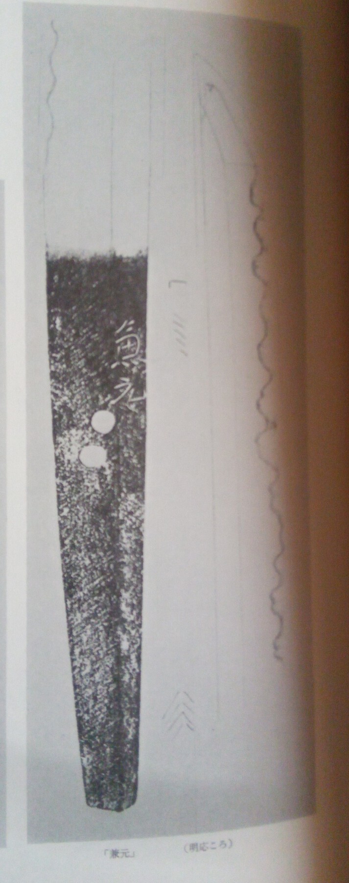

Just for fun, oshigata of shodai and nidai kanemoto (come from Mino to taikan) ...
If the implication is that it is similar to the present sword then I don't think its correct. These have well defined togari, well defined groupings of such, each separated and rising above the "valleys", groupings are mostly resembling each other. They are also not slanted left and right, or become thin long lines, crab claws or tobiyaki. They also will look quite differently in hand in terms of nie...
If one is to go this way, one can pull Kanetomo, who indeed forged in heavily Bizen skewed fashion and indeed could resemble this blade in oshigata.
