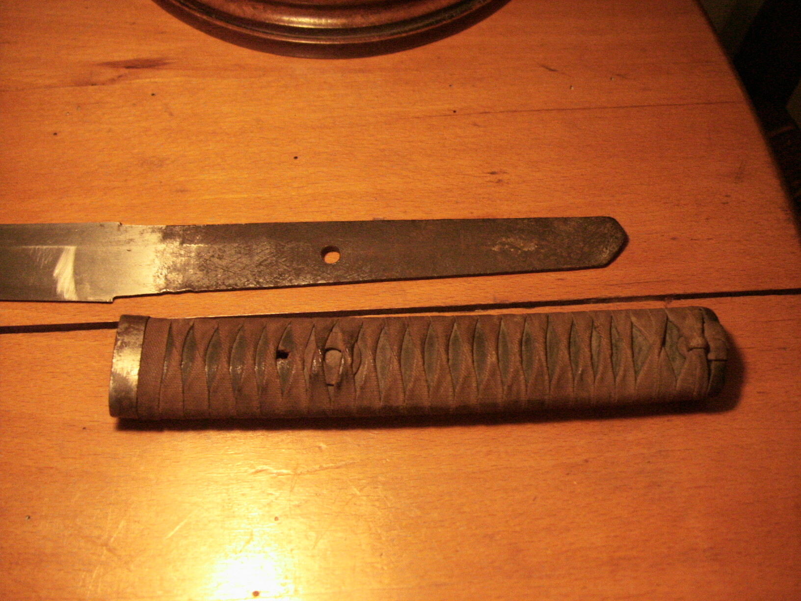

micah Posted January 8, 2021 Report Posted January 8, 2021 I bought this sword recently im not worried about the blade i just want to know your opinion on the mounts i will show the blade anyways Sincerely Micah Quote
vajo Posted January 8, 2021 Report Posted January 8, 2021 Simple Mounts. Menuki was ripped. The Same is/was just beautifull. Why you think it is a Satsuma sword? Quote
16k Posted January 8, 2021 Report Posted January 8, 2021 Agree with Chris. Same is too good for a Satsuma sword, provided these even exist. Quote
Shugyosha Posted January 8, 2021 Report Posted January 8, 2021 2 hours ago, vajo said: Simple Mounts. Menuki was ripped. The Same is/was just beautifull. Why you think it is a Satsuma sword? Because that story was used to inflate the price? 🙂 1 Quote

micah Posted January 8, 2021 Author Report Posted January 8, 2021 the sword was Quite cheap and i was just saying that because they match a few sastuma rebellion swords i have seen and this one has been used alot it is quite thin i think it has been polished past it's hamon and what are these marks are they from bending Micah Quote
micah Posted January 9, 2021 Author Report Posted January 9, 2021 then if it is not from satsuma then where i mean the fittings are quite Are quite plain it has most likely been in a scuffle based on the blade it is obvious that it is a edo or late 15 century blade based on the shape what do you think? Micah Quote
SAS Posted January 9, 2021 Report Posted January 9, 2021 Those marks appear to be too deep to be shinae; they look like kirikomi to me, but how they got there nobody will be able to say. 1 Quote

Dave R Posted January 9, 2021 Report Posted January 9, 2021 And here I am.... There is a definite style of koshirae we label as "Satsuma" and the term is as good as any, though we need to differentiate from the distinctive mounts known to be used in the Satsuma Han.... Which is one of the reasons I prefer to call them "Okashito." It's a largely ignored area by collectors because they are fairly shabby and the blades often tired or even flawed. Dealers love the term just as they love "Pilot Swords" and "Kamikaze Tanto", they do have a living to make after-all. I have tried to define what makes a sword a Satsuma, because there are a lot of swords that look like they may be, but are in fact probably just cheap swords. I was frustrated in this endeavour before, so I will just say, if it has washers as menuki and the spiral type Itomaki (katatamaki) them pay attention to the blade.... It was thought to be usable, but not worth keeping! 5 Quote
Dave R Posted January 10, 2021 Report Posted January 10, 2021 .... Something I just remembered, these were so cheaply assembled that sometimes the blades were glued into the tsuka with resin or lacquer, so be careful when dissasembling. In the case of the sword starting this thread, I think it's just a lower end sword and not an Okashito/satsuma. Not every tsuka had menuki, I have one in my collection without. Hemp Ito over shark skin and clear lacquer over all. 1 Quote
micah Posted January 10, 2021 Author Report Posted January 10, 2021 5 hours ago, Dave R said: it's just a lower end sword so does this mean it was just ment as a working sword since it is so plain like it was not supposed to be pretty and the only Purpose of this one was a weapon. micah Quote

micah Posted January 20, 2021 Author Report Posted January 20, 2021 well i got the sword it was in a fight a big one most likely the rebellion the saya was cut into the blade has a cut into the spine edge to edge hits it has been through alot as someone Mentioned they used there swords until it was done thats the case with mine it has been used to it's limit it does have a bend near the tip but cool piece of history i got it is poorly made it does have slag Inclusions and a blister and the cuts of course 1 Quote
Dave R Posted January 20, 2021 Report Posted January 20, 2021 Regarding the good same, the hilts of these cheaper swords often re-use parts and pieces, which can have been quite high class once upon a time in the past. This one from my collection is a classic. High class same, spiral Ito, but not katatamaki, the kashira is an old kabutogane from a handachi and the menuki is part of a tobacco pouch clasp. 2 Quote

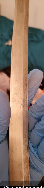

micah Posted January 20, 2021 Author Report Posted January 20, 2021 here is part of the blade it is super thin Quote

Dave R Posted January 23, 2021 Report Posted January 23, 2021 Very like this one I have, a bit of a step up from the typical Satsuma. Note non matching menuki, but same style of wrap which is well done but in cheap material. Quote
