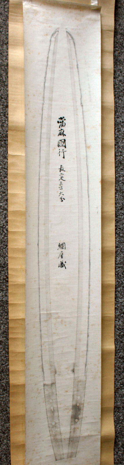

kissakai Posted January 6, 2021 Report Posted January 6, 2021 Hi I bought a scroll from the MNB last week and I'm asking for help with its translation Quote

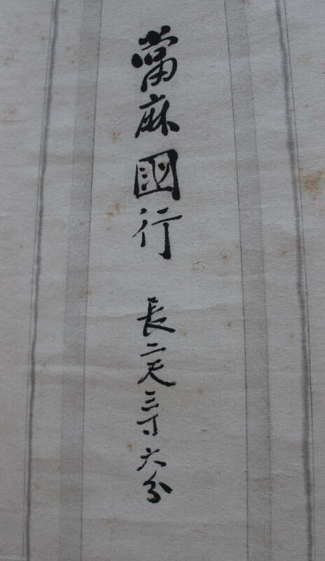

Nobody Posted January 6, 2021 Report Posted January 6, 2021 當麻國行 - Taima Kuniyuki 長二尺三寸六分 - Length 2-shaku 3-zun 6-bu 網屋藏 - Amiya’s possession 4 Quote
kissakai Posted January 6, 2021 Author Report Posted January 6, 2021 Thanks for the translation I assume Amya was the owner but not being a sword collector can anyone supply any more information? Quote
Nobody Posted January 7, 2021 Report Posted January 7, 2021 Amiya seems to be a historic sword shop founded in Edo period. Ref. 網屋 - 名刀幻想辞典 (meitou.info) 1 Quote
kissakai Posted January 7, 2021 Author Report Posted January 7, 2021 Interesting - Would Amiya be the equivalent of say Liberty's as a sign of quality So just to find out about the maker Would any more images help? Quote
Nobody Posted January 7, 2021 Report Posted January 7, 2021 Taima Kuniyuki is famous. His sword is national treasure class. 2 Quote

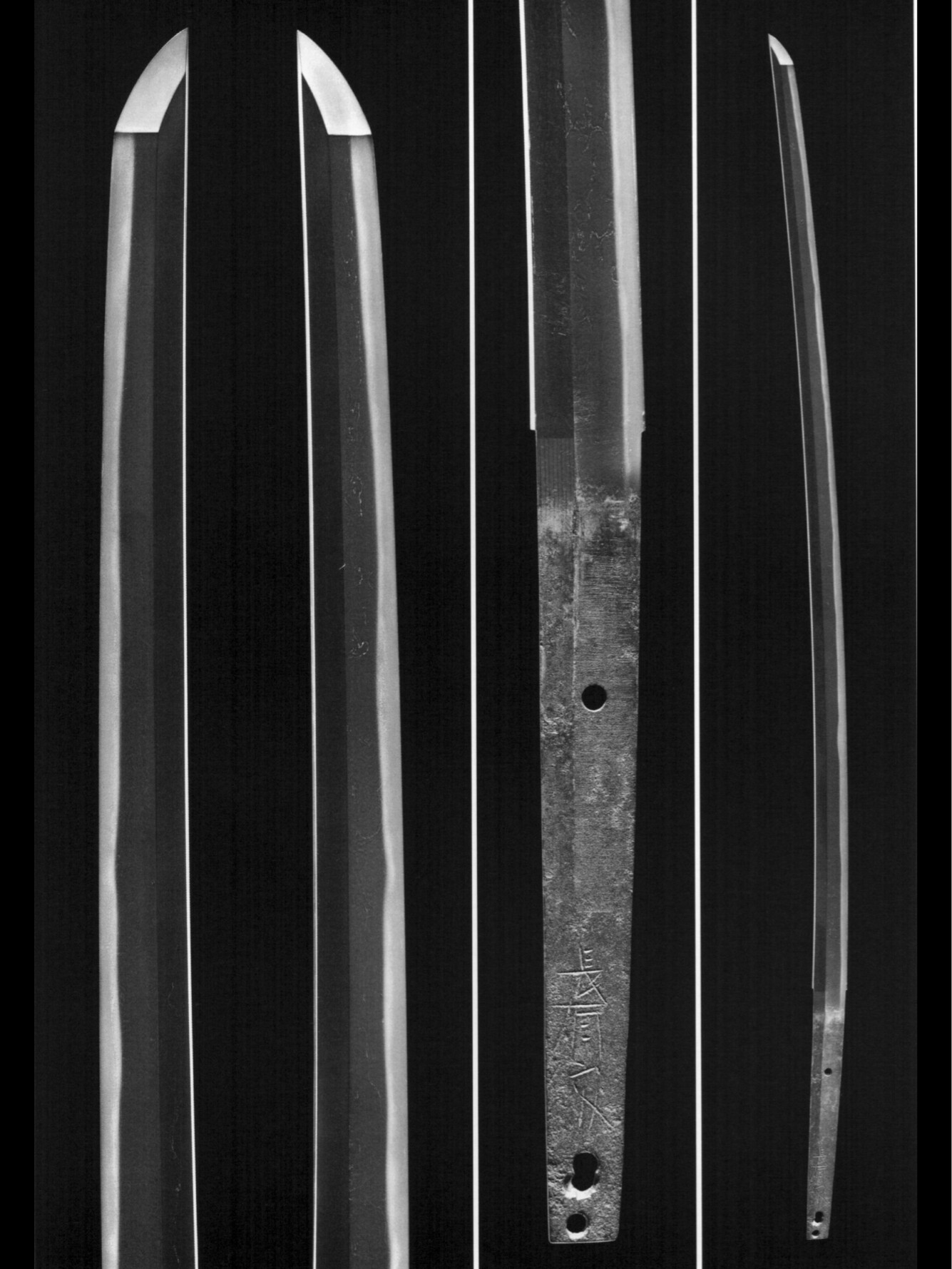

Jussi Ekholm Posted January 7, 2021 Report Posted January 7, 2021 Grev can you post a picture that shows the tang? As the length is given I can check it in comparison to similar examples I have. Quote

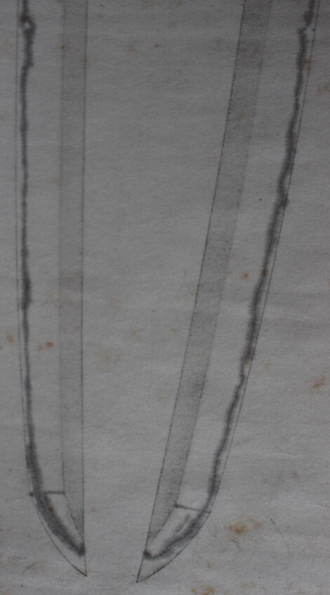

kissakai Posted January 7, 2021 Author Report Posted January 7, 2021 This is turning out better than I'd hope for and some nice articles I felt the oshigata scroll is 185- 1900 due to similar images with 'foxing' but it all depends the conditions it was kept in New images as requested Quote
Jussi Ekholm Posted January 7, 2021 Report Posted January 7, 2021 Thanks for the additional pictures Grev, very interesting piece. I tried to compare to the known Taima Kuniyuki around this length but I did not have this one. I also did a comparison to Rai Kuniyuki tachi around this length that I know of but there was not a fit in there either. Quote

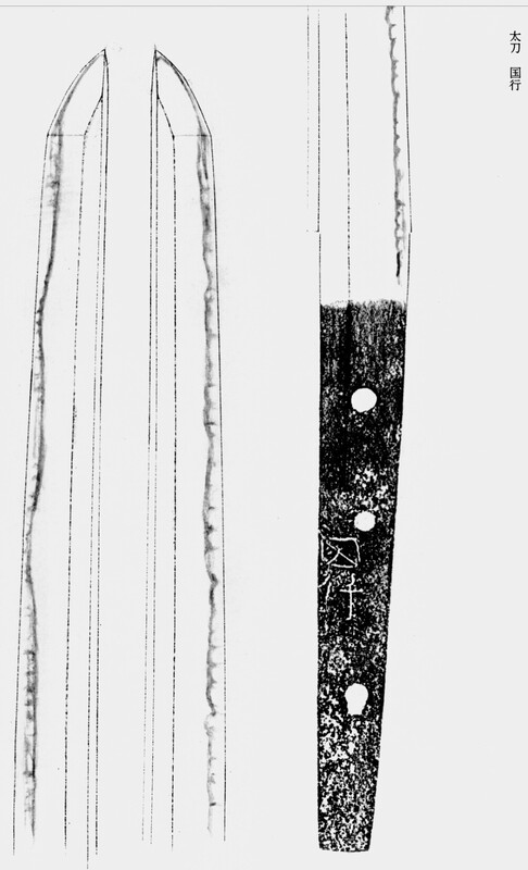

Gakusee Posted January 7, 2021 Report Posted January 7, 2021 I wonder if this is an oshigata of the Taima Kuniyuki sword which was formerly owned by Shigemasa Fukushima and passed Juyo in the 17th Juyo shinsa session. See the attached image below. There are some minor differences (eg the bottom ana has been slightly enlarged, and also I wonder about the spacing between the first and second ana). Taima swords are viewed very highly, and are known for their fine jigane and elegant ko-nie. In fact, I dare say they are the most highly rated Yamato swords in general (happy for a friendly debate to ensue, following this bold statement, as I yearn those:). Having a signed one is tantamount to owning a treasure. Zaimei Kuniyuki are, in the words of the NBTHK, ‘extremely rare’. He is rated at 1500 points in the ToKo Taikan. In fact, I wonder what happened to that sword. Having passed Juyo in 1968, I do not think it has re-surfaced recently, and I cannot find it in the Tokubetsu Juyo volumes, but believe it should qualify for that status given the length, mei and the reputation of the smith. The actual blade must be a beauty. 1 1 Quote
paulb Posted January 7, 2021 Report Posted January 7, 2021 Sorry Michael but I for one must dissappoint your desire for debate. I agree with the widely held view that Taima was the finest of the five Yamato schools. The jigane, the ji-nie and general high quality hada means the best taima is often mistaken for the work of the famous soshu Smith Yukjmitsu Quote
Jussi Ekholm Posted January 7, 2021 Report Posted January 7, 2021 I think it might be possible Michael, the ana are bit different and I skipped it but sometimes the oshigata are not 100% similar. This is one of few with plausible length. Of course it can potentially be a "hidden" Kuniyuki too. As signed tachi by him are extremely rare, I haven't documented too many of them only 5 + 1 kodachi. There are some amazing swords in Japan (shrines, museums, private etc.) without any designations. Quote
