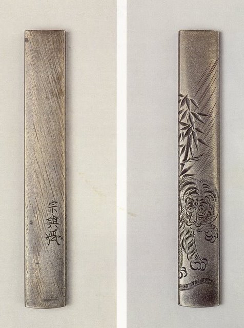

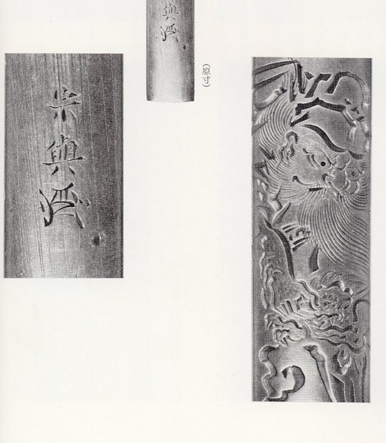

Ford Hallam Posted December 11, 2008 Report Posted December 11, 2008 these are from the "Toso Kinko Meishu Roku" circa Showa 45 handy converter here Quote

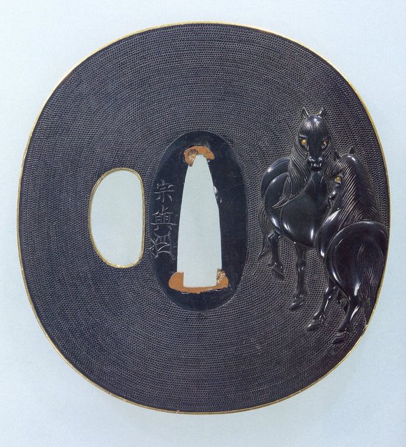

Ford Hallam Posted December 11, 2008 Report Posted December 11, 2008 ...and while we're dealing with this maker I thought it might be helpful to add the following images as reference and some biographical information. Yokoya Soyo (1615 - 1690 ), his personal name was Yokoya Jihei. Started off using the art names ; Moritsugu, Morinobu, Tomochika and ended up using Soyo. Apparently his early training was in a studio that supported the output of the Goto school in Kyoto. Most likely in making up the basic forms of fuchi/kashira and kozuka. It's probable they supplied the nanako grounds also. He graduated from this lesser workshop to study the pure Goto style under Goto Injo. Yokoya Soyo went on to found the Yokoya school which is famed for it's dynamic work in kata-kiri bori. Soyo who is often referred to as "Grandfather Soyo" was the father of the more famous, and arguably influential, Somin. The school flourished until late in the Edo period and produced a great number of students, rather confusingly, called either Somin or Soyo. The school is credited with introduction of the vertical format, just like a hanging scroll, for kozuka decoration. This is in contrast to the horizontal arrangement of the Goto school which echoes earlier screen painting composition. In this we can see the move from the aristocratic taste of the Goto clientèle towards the freer type of artistic expression favoured by the merchant class and the rise of the machibori artists. This was exhibited at the British museum in 1990 and is regarded as genuine. ...as was this, more typical kata-kiri piece. This charming fella was exhibited at Patrick Syz in 1991 and I was fortunate enough to get to examine it at very close quarters. It convinces me of it's authenticity. Most of the information I've quoted comes from the catalogue written by Graham Gemmell that accompanied the exhibition. Quote

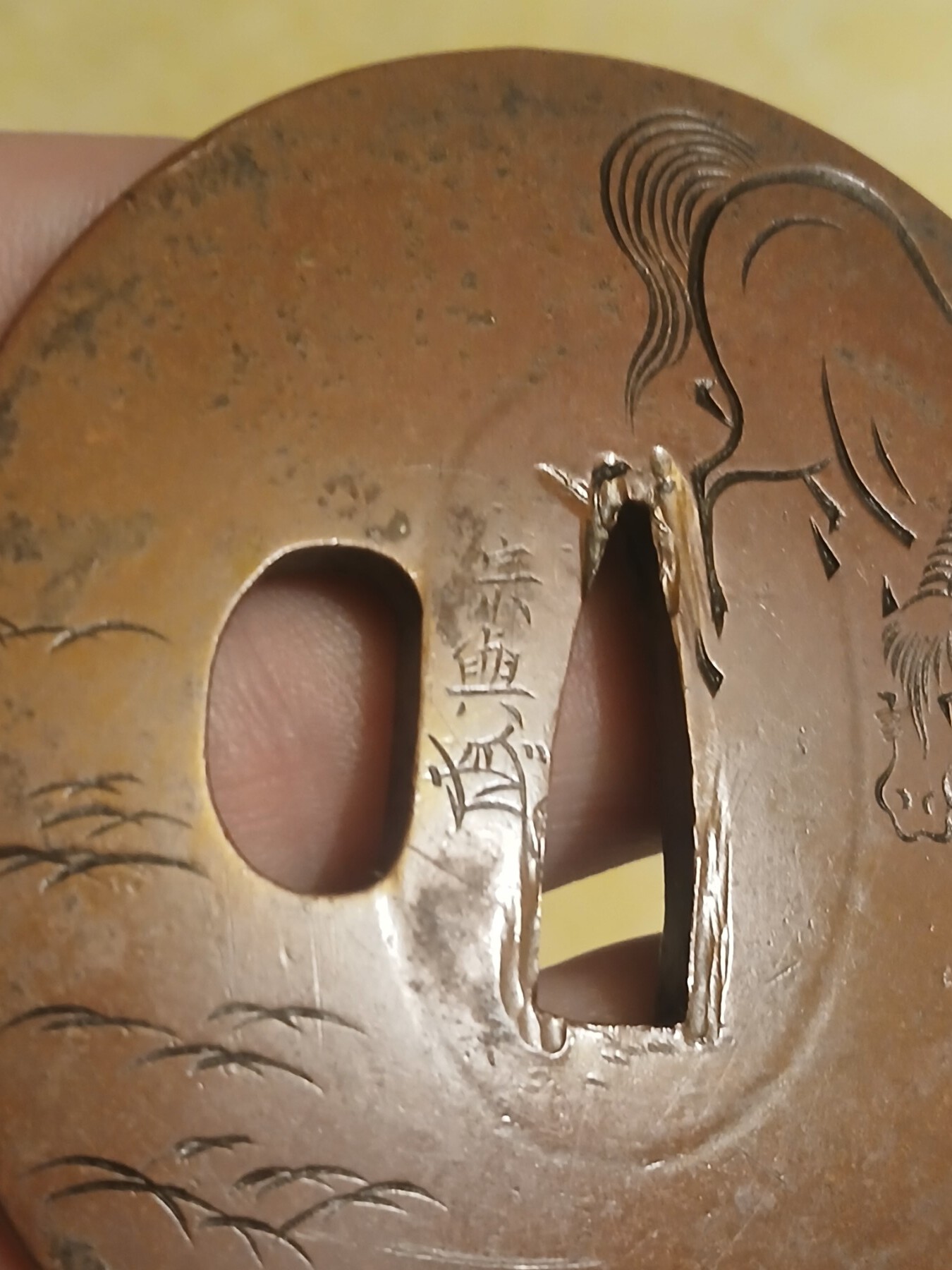

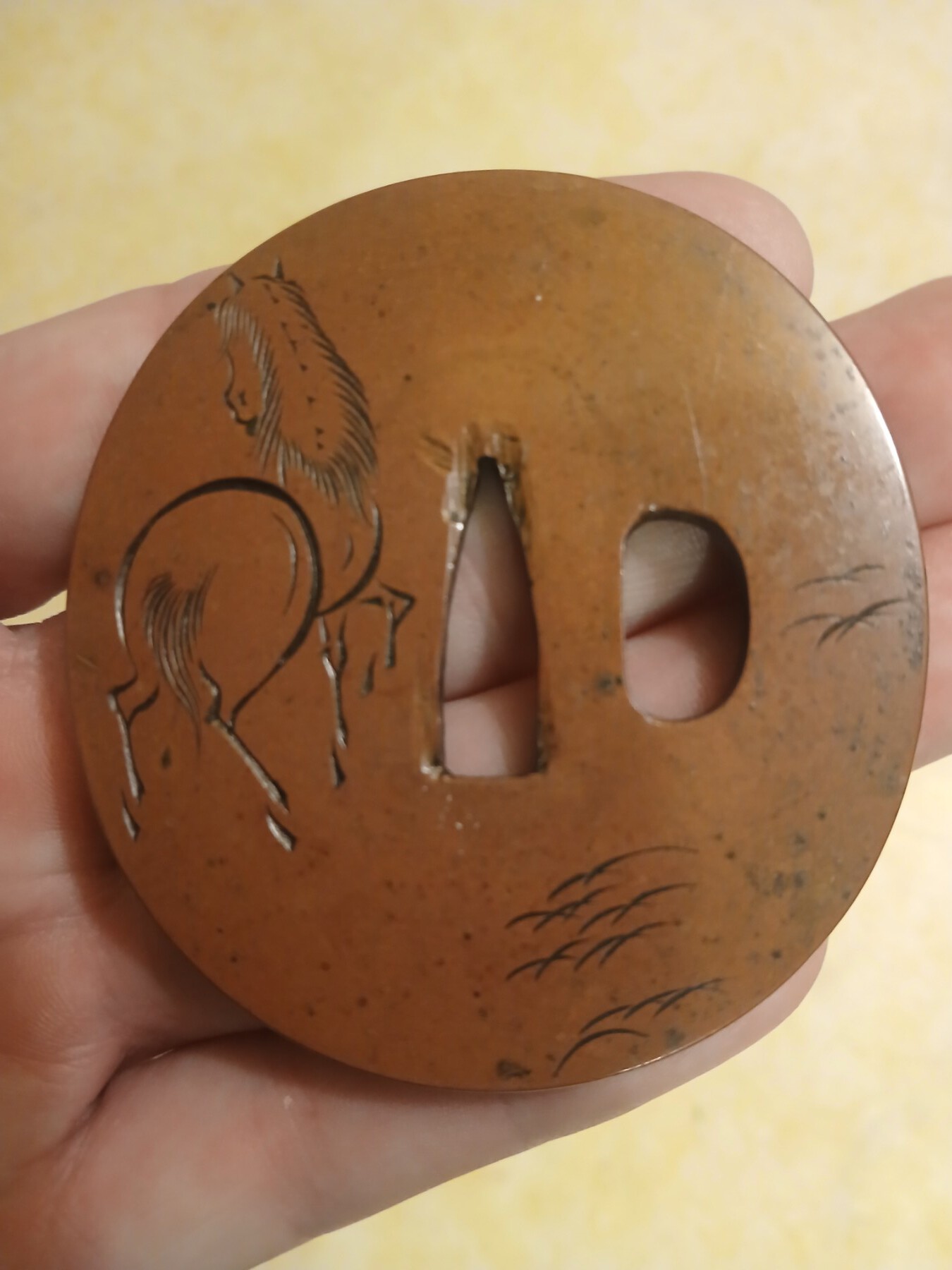

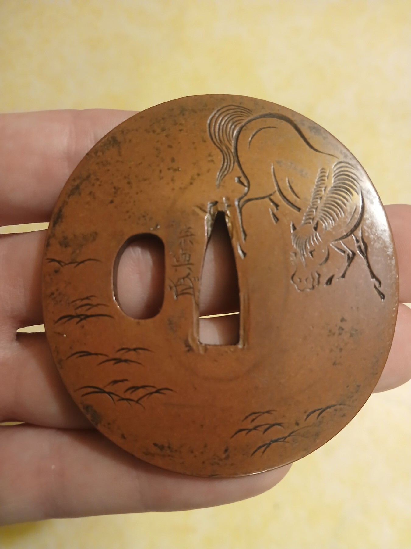

TsubaBran Posted November 4 Report Posted November 4 (edited) Hello. I believe the following is of this school/artist. It is a copper Tsuba for Wakizashi and is a prized posession of mine. I'm not an expert but this brush stroke style is incredibly beautiful to me. 宗與 – Soyo (Yokoya school) Edited November 4 by TsubaBran Quote
